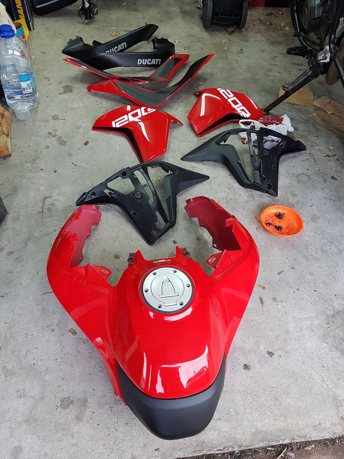

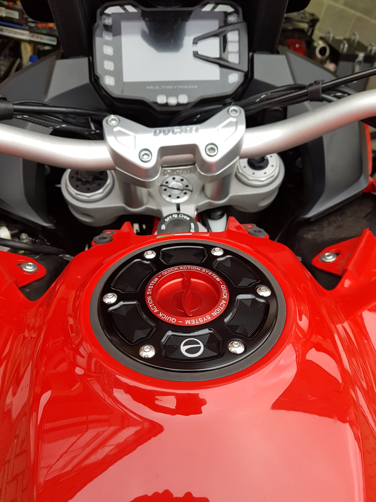

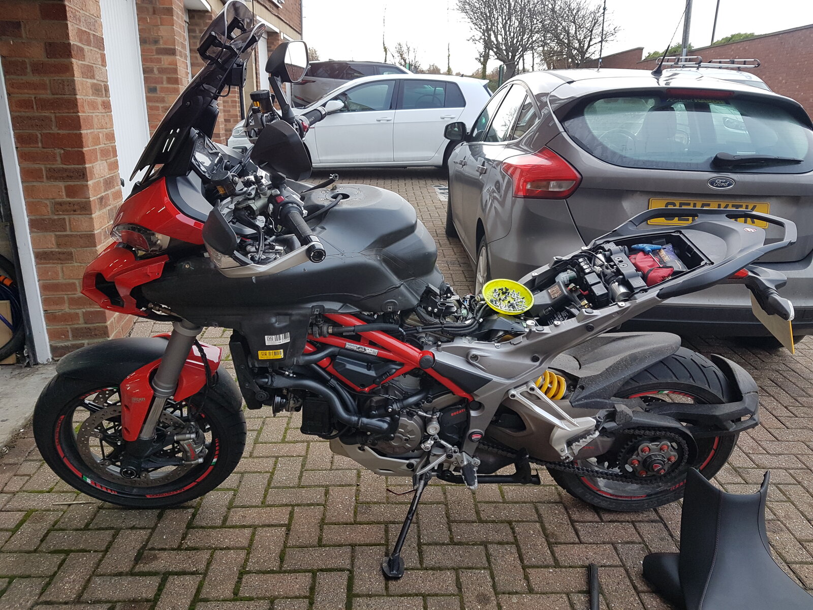

  1. Cheap £30 Chinese flavour
    Bit of a chow on to fit... damn those 2 screws holding the original cap to the rest of the gubbins
    ...and 0° outside made the plsdyics a bit non flexible, but it's done...looks canny
    Let's hope it seals and isn't too tricky to undo with gloves on ( It's quite tight to turn)

    Yes stripping it down and putting it back together was a faff but it’s manageable. If in doubt, get a friend to help.
  6. I was surprised how easy it was to remove the bodywork. 3mm & 4mm allen keys only from memory.
    I suppose it was a bit of a shock that you have to take everything off to replace the fuel cap!

  15. Yep it's a bit of a pita....but it's also a chance to get into the bike and give it a bit of a cleandown, where you don't normally get
    At the end of the day it's a dozen or so screws
    ....and it's gadge
