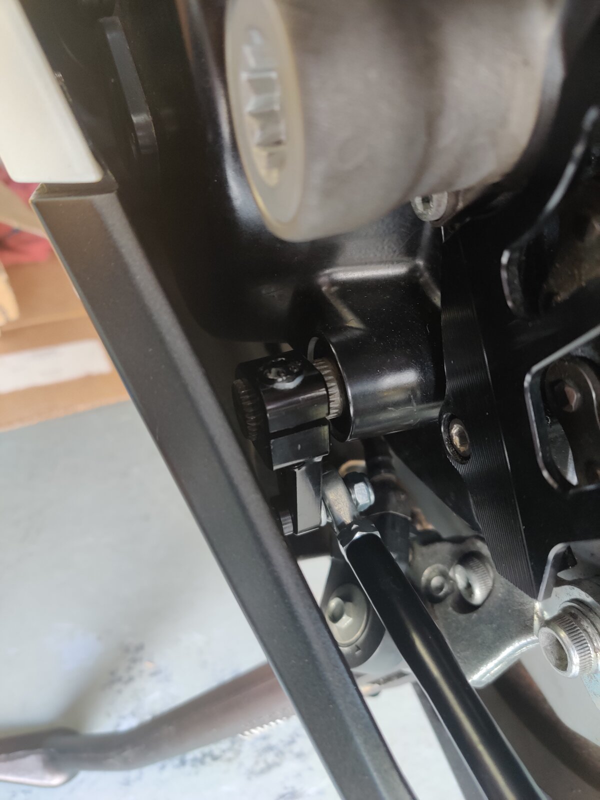

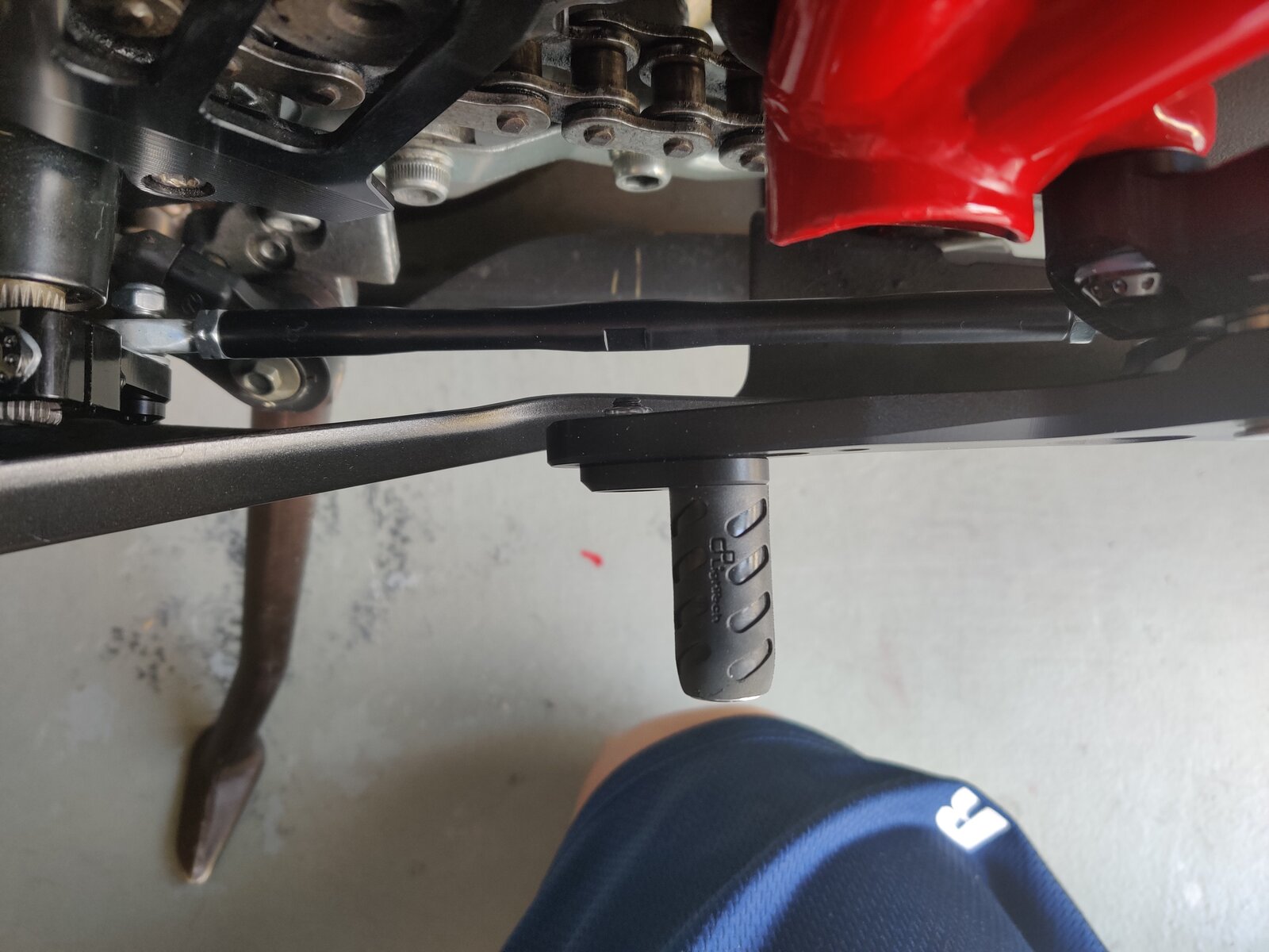

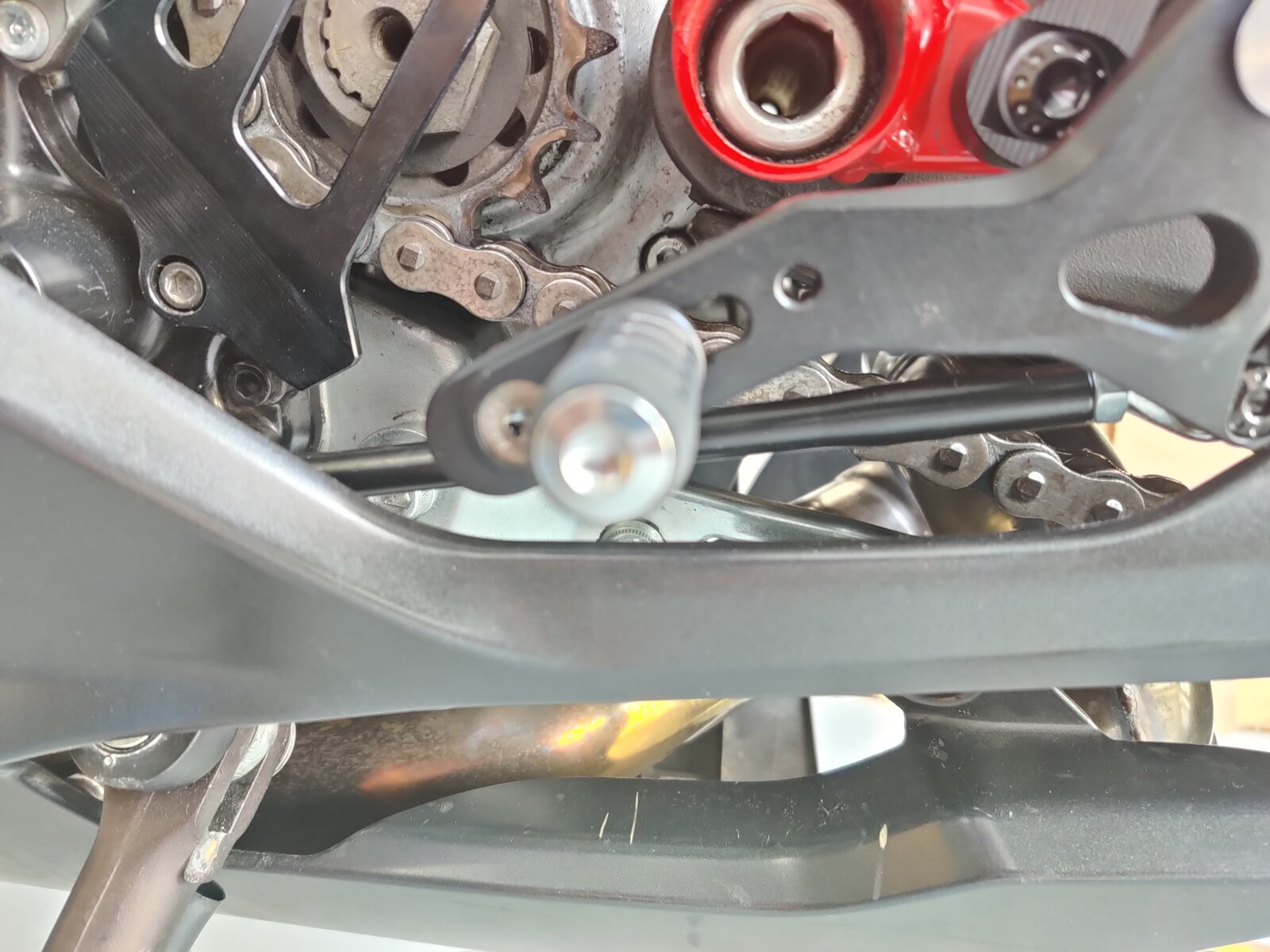

  1. Hello everyone, I just installed new Lightech rearsets for my 848, fantastic quality BTW. I made sure the shift lever is pointing straight down and the shift rod is in the same plane (i.e.straight) between the rod ends at the shift lever and rear set pivot point. There is no binding anywhere. Since installing these rearsets, shifiting has been awful. I cant get into neutral at all and shifting is extremely clunky. Going into first feels like the entire transmission is going to drop out of the bike. Its never felt like that before. I am certain my rearsets are set up correctly as described above. I am at a loss to understand why/how the shifting behavior can be so adversely effected.

  2. Post some photos of the linkages. How do the new rearsets compare to the EOM ones from a dimensional point of view? Are the lever lengths broadly equivalent?
  3. Thank you for the reply. Attached are some pics. Sorry the lower fairing is still on but I can say the shift lever is definitely pointing straight down. The new rearsets are set up almost identically to the OEM. The OEM shift rod is 140mm and the Lightech one is 165mm but because dimensionally the rear sets are different, the overall shifter angle is only slightly different. The shifter angle is a bit lower than OEM because the shift rod is a bit too long and because the footpeg is slightly higher. I have a flex my ankle down just a little more than I would like so I already ordered a shorter shift rod but I don't think this would make a difference?

  14. The sad thing here is that I actually have a degree in mechanical engineering! Now I know why I got a grad degree in finance. Anyway, I took a much closer look at my rearsets today and noticed that the rod end at the rearset looked ever so slightly like it was pointing towards the right side of bike. Because of the length of the shift rod this resulted in the rod end at the transmission shaft pointing 8-9mm too far to the inside (right) of the shift lever. I think this misalignment combined with the already too stiff return spring caused me to miss shifts because of the added force needed to overcome this misalignment. I have now added some washers and adjusted the shift lever along the transmission shaft. Manually shifting using my hand with the bike on a rear stand seems easier and smoother. I will take the bike out for a ride tomorrow to confirm.

  18. Yes indeed I got it sorted out. The two things I focused on were:
    • Making sure the shift rod was aligned straight from the rearset to the shift lever and
    • Getting the shift rod as close to a 90 degree angle to the shift lever
    I also changed out the rod ends to some high quality ones from Aurora but I don't think these made any difference other than making me feel better. Moral of the story for me was to make sure the various shift linkage components are properly aligned instead of just eyeballing it.
