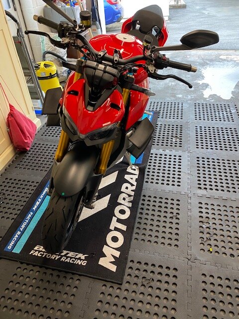

    Just got back to ducati with a new streetfighter v4s.
    Sorry about the pic but its rained non stop since i got it.
    Just a couple of questions.

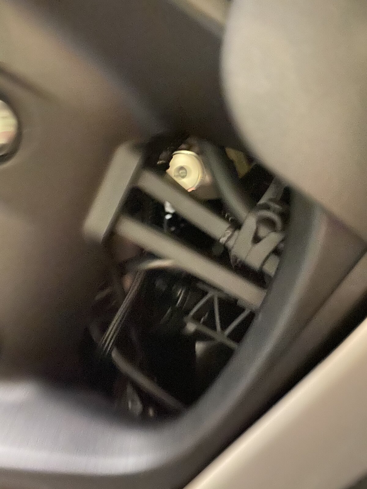

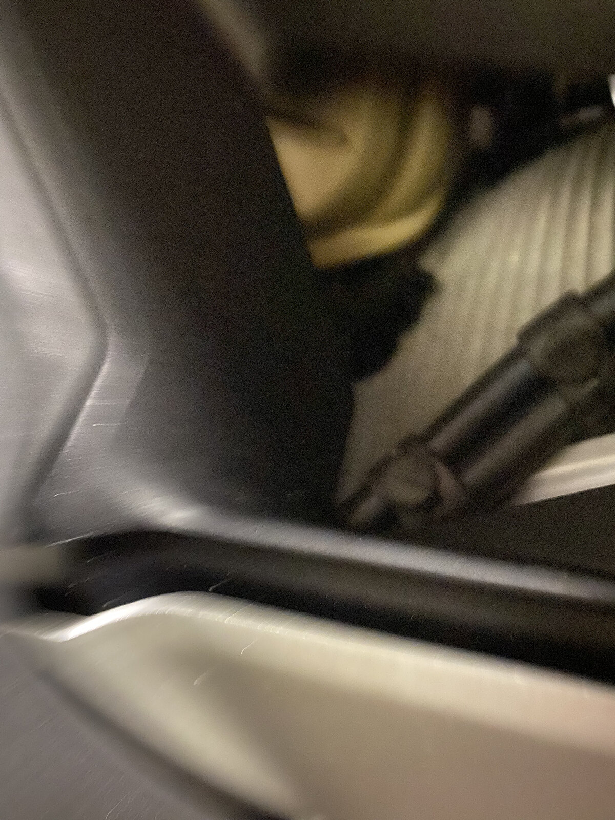

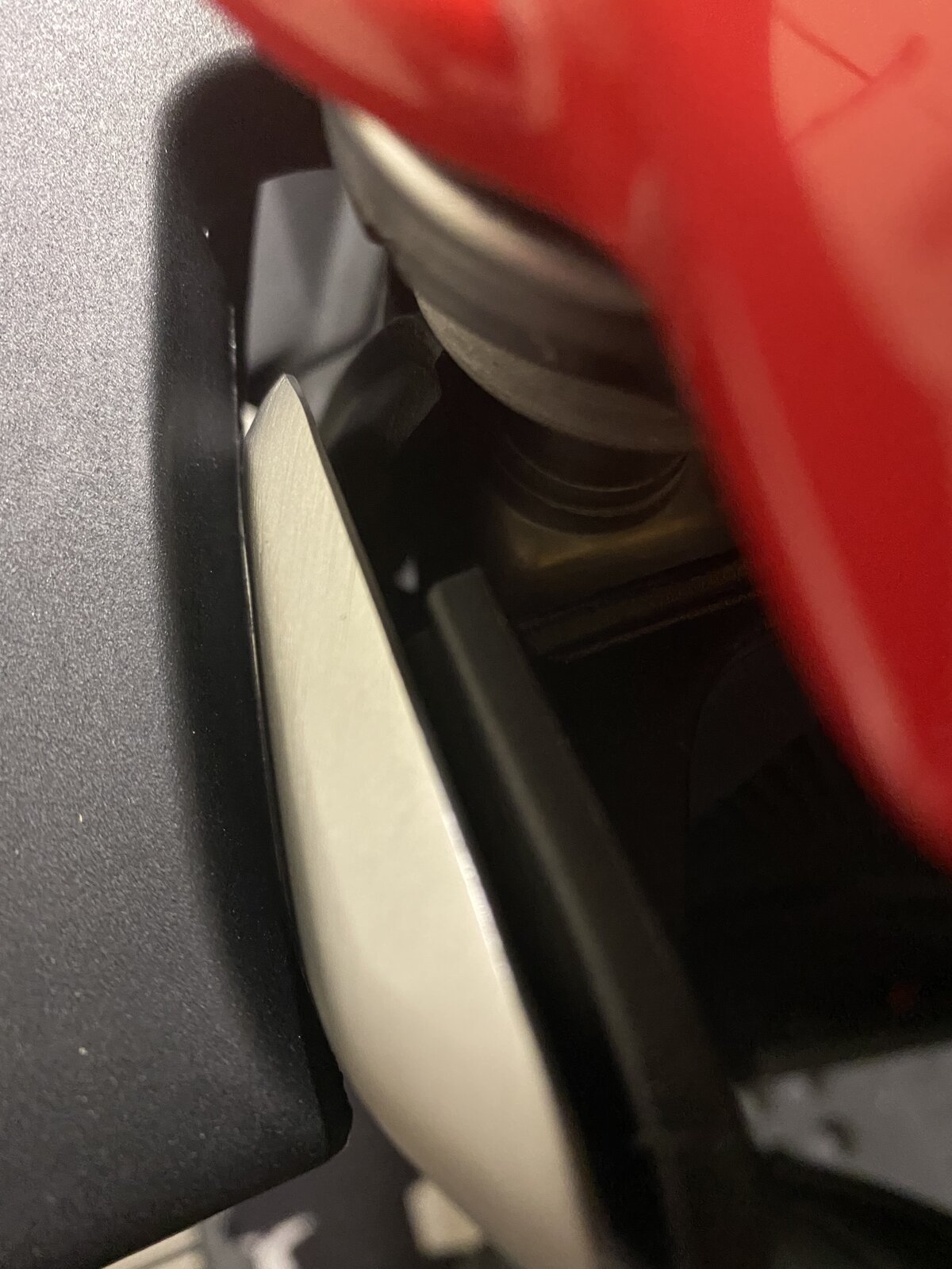

    once all back together only thing i have noticed is that the left hand side ( sat on bike) aluminium trim pieces dont seeem to fit flush to the black plastic behind them? Can anyone photo theirs so i can confirm that mine are ok or something isnt quite right, thanks

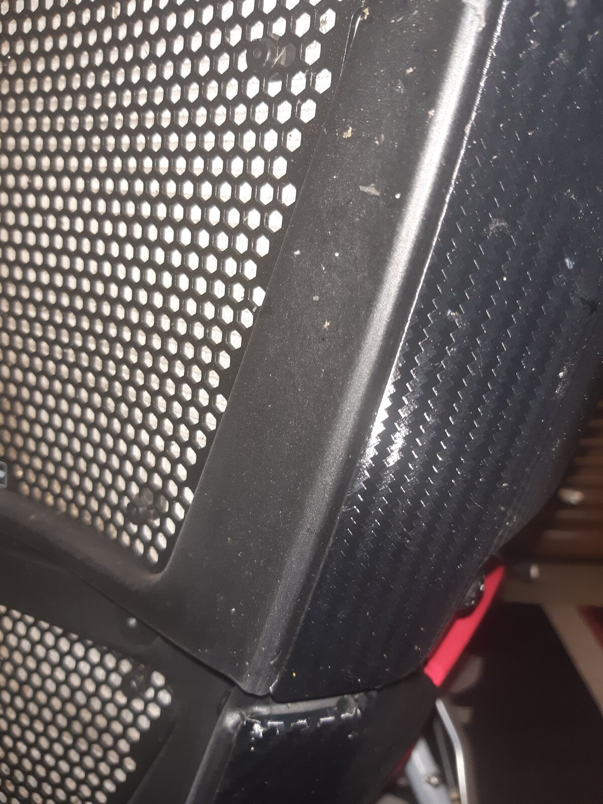

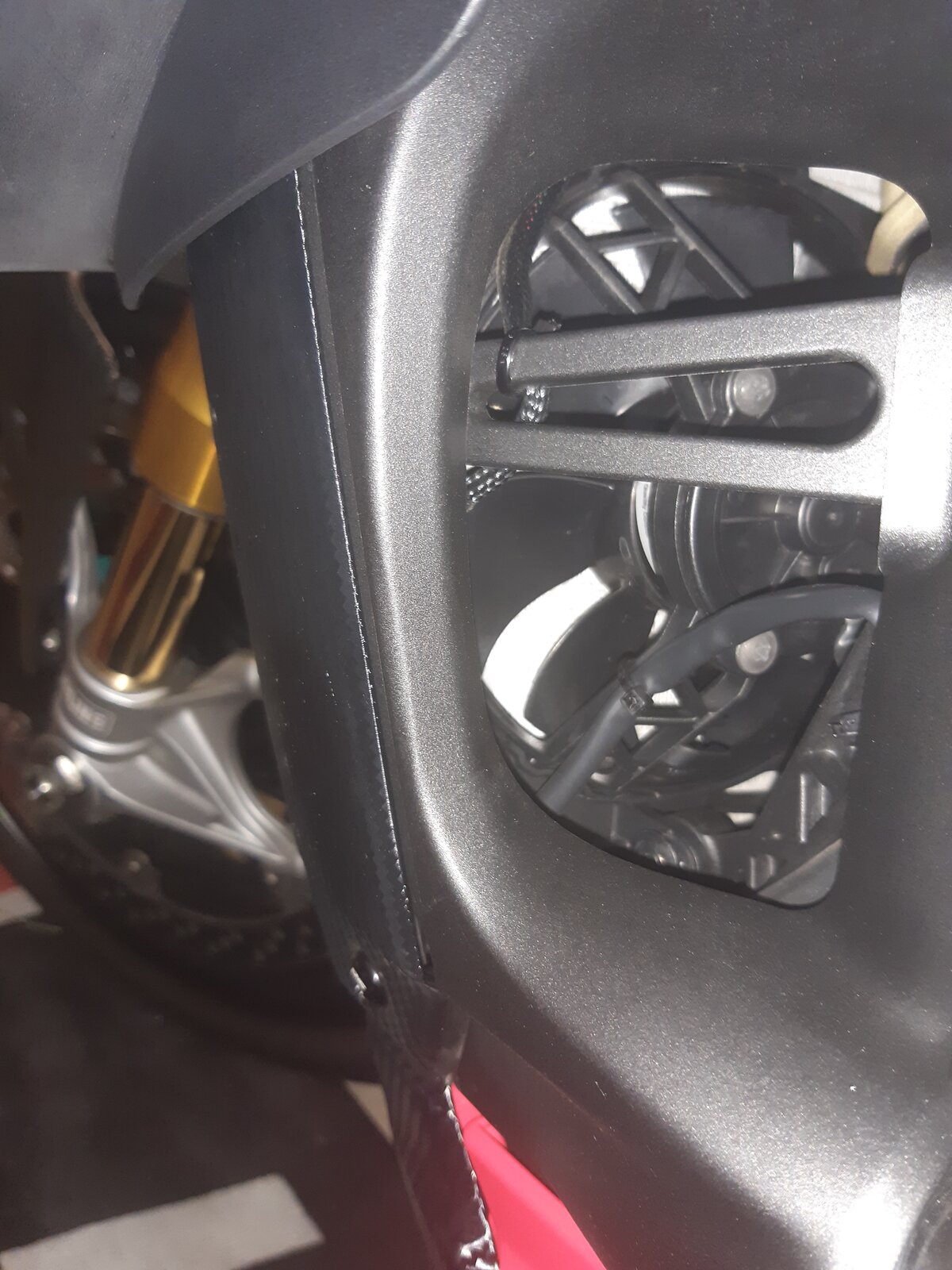

  10. Not sure if this is of any help and hope its the correct area, but here's mine.
    I have covered them in black vinyl, so does not show the edge as clearly, but they are fairly flush with the surrounding trims. I apologies for the bad lighting and also the fact that the bike needs a clean, which will be done this weekend.

  11. 02C34B27-516D-452C-B88C-1AFF5573CE38.jpeg 228C2AB0-A340-452C-9C2A-BB4CFA362A74.jpeg 13BCA58B-DB5A-493B-83C2-B384955E4E40.jpeg Thanks for those. This is my right hand side( sat On bike)
    As you can see it doesn’t fit flush. Just
    Need to know whether to dismantle that side again or it’s normal
