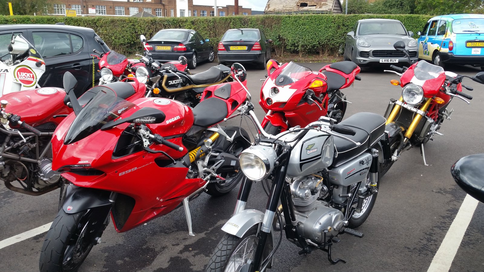

    Fitted the sprocket to the bike, which involved shortening the drive chain by a link, and took it for a short run. The gearing is much better now, so very pleased. I plan to ride the 160 to the Essex meet at West Horndon on Sunday, weather permitting, as it's only 20 miles or so from me.
  7. And so I did.
  8. there must be engineering companies out there that can do this, the old step father gets gears made from scratch for his vintage machinery. sure it wasn't that expensive either.
  9. Shame that garish taxi paint job is ruining the photo.
  10. "Black" taxis are not what they were.

  13. Hi Pete
    Shame i missed the meet on Sunday (holiday) i would have liked to have had a look at your new bike, Dan mentioned it to me today about it (owns the 749 in the photo)
    what year and model is it, looks a mint bike :upyeah:
    As for the taxi it is Essex, looks like the bus shelter could do with a new roof,
  14. It's a 1965 Ducati 160 Monza Junior Mk 2, and it is fairly standard and in excellent running order. Not quick, of course, but fun to ride. I am enjoying it, as an alternative to the big bikes.
