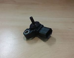

  8. Hi, my brother had a similar issue, but his fault came with a dash warning, and ended up being the MAP sensor, there are 2 under the tank, so he replaced both. But like Pete says, it could be anyone of a number of things, so best to plug it in at a dealer and let them run a diagnosis, but just in case, the MAP sensors are these below....Good luck
