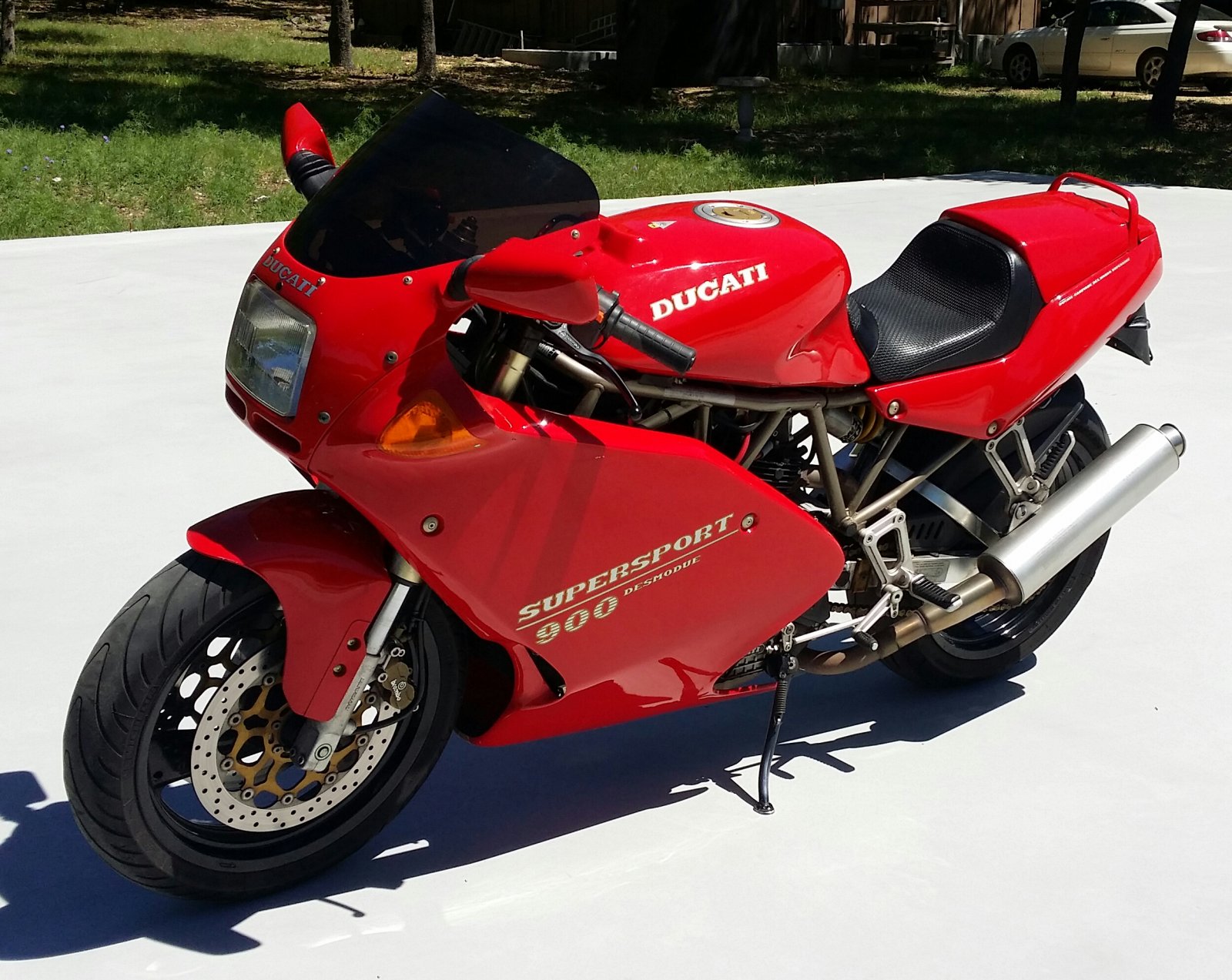

    Hello from Boerne tx. New here
    Just picked up this 93' in Austin Tx.
    Went to Austin to look at a ST4, and since this was in the same area seemed worth taking a look on my way. Kinda got seduced I guess as this is what I came home with. 27k miles, the owner (engineer) purchased it 9 yrs ago and did his own maintenance. Steering head looks perfect, black head studs 8 yrs ago, recent belts, valve adj, FCR41s and runs well $2800. Could have purchased the ST4 for $3k but theres something about the SS! Been reading about the crank galley plug and am spooked a bit. Is the failure mode catastrophic? I am pretty observant of noises and looking after things, are there any clues?
    Thank you,
    Dean[​IMG][/URL][/IMG]

  3. 20170330_143244-1.jpg Ok, heres another attempt.

  4. Cool :cool: and welcome :upyeah: do you know Kevin and Colin?
  5. No I dont. But am looking forward to connecting with the Duc family!
    Dean
  6. Very lovely :) proper colour too
    Welcome into the mad house froggy
  7. Very Nice indeed.
