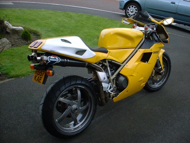

  19. My 1st Ducati was a 916 which I was proud as punch of when I fitted a brand new pair of Marchesini's and rubber to it. I looked a bit silly when I pulled away and the torque spun me a full 180° round to face the opposite way I set off from, bolt upright. :cold_sweat:
    I thought nobody saw me until my neighbour commented on it a few days later :blush: Bloody Termignonis made him look out of the window. :motorcycleduc:
