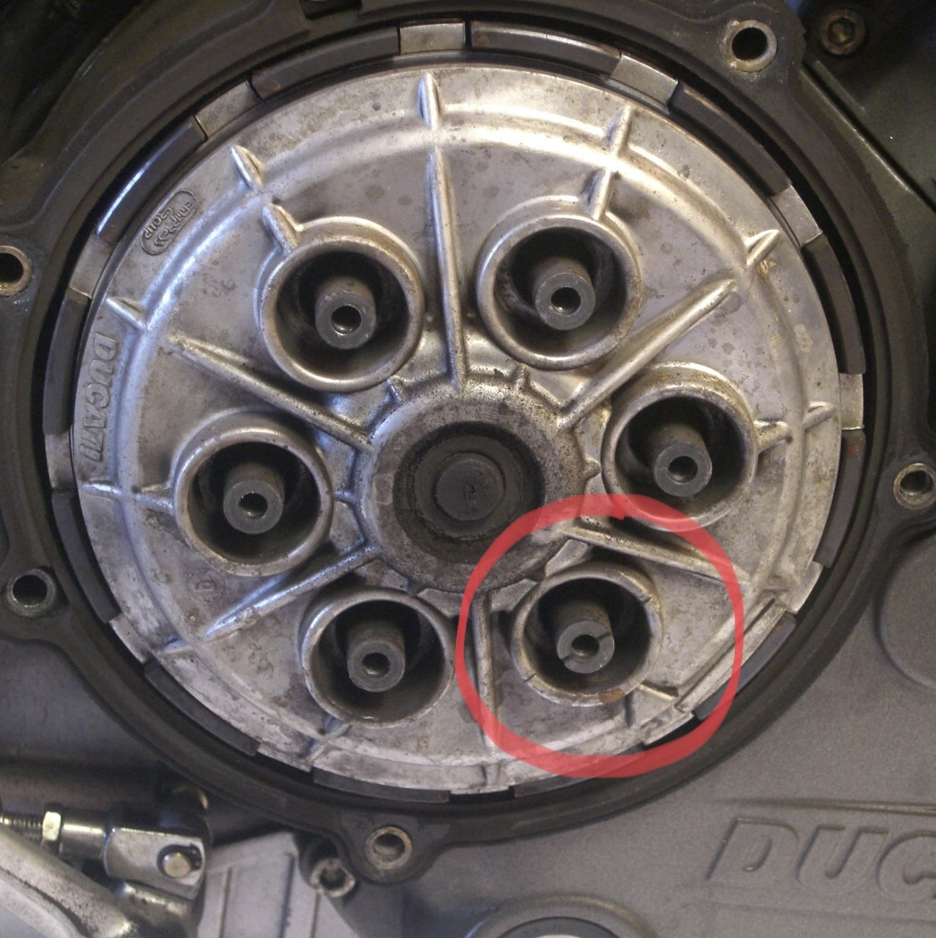

  8. Have you put the pressure plate in the correct position? There is a post with a slit in that the hole on the pressure plate with the Arrow Head has to go over. Then make sure the pressure plate is meshed with the cog splines on the clutch hub.
  9. Pictures of your assembled clutch might reveal something, if "stack" dimension is high then the outermost plate could be popping off the basket? - I think you would see this though. Also the pressure plate possibly needs orientating when fitting if it is the same as previous designs with an odd number of engaging "teeth".
    Struggled to get a clearer picture, but does above look right? Looks as though it’s totally different to earlier clutches.

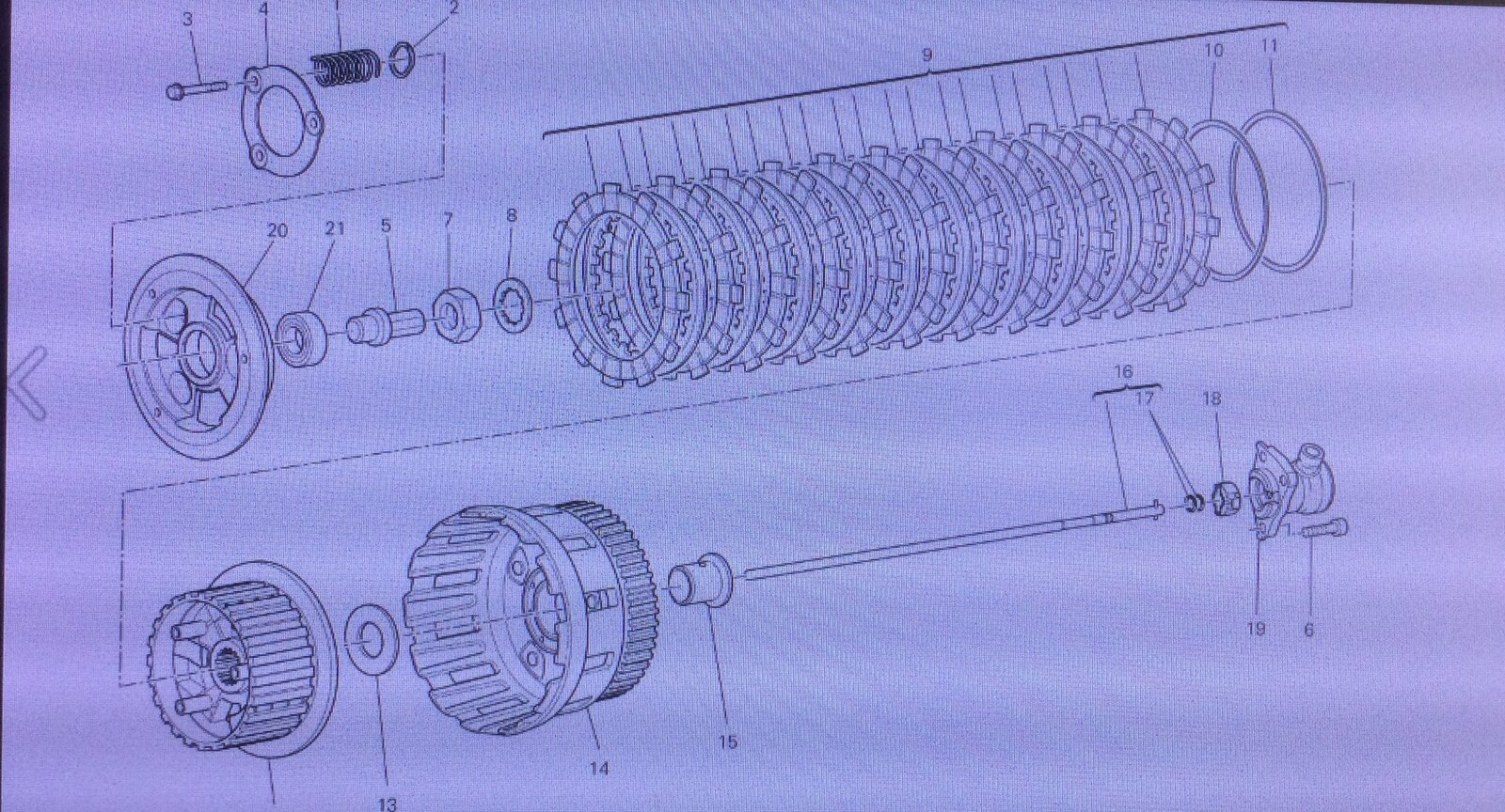

  18. @Neeliedone Assuming @Chris ’s parts diagram above is correct, by ‘large nut in clutch basket’ do you mean part no.7? If so did you retighten it to the correct torque? If that nut is working loose then the clutch drum is not fully seated within the clutch basket and the top plate will, when the clutch lever is pulled, be pushed out beyond the edge of the basket. It then won’t return which means the pressure plate can’t reseat all the plates and push the pushrod back against the slave cylinder. Thus your pushrod and slave cylinder remain fully extended, can extend no further, and cause the solid or locked feel at the lever ie you can’t pull the lever in because there’s no more movement available at the slave and pushrod.
    you say you ordered a clutch and fitted everything back, but what entails the ‘clutch’ just the friction plates, or friction and steel or all of them plus basket or plus drum etc., and have they all been fitted in correctly?
