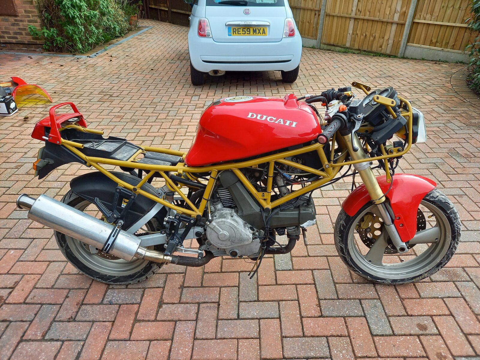

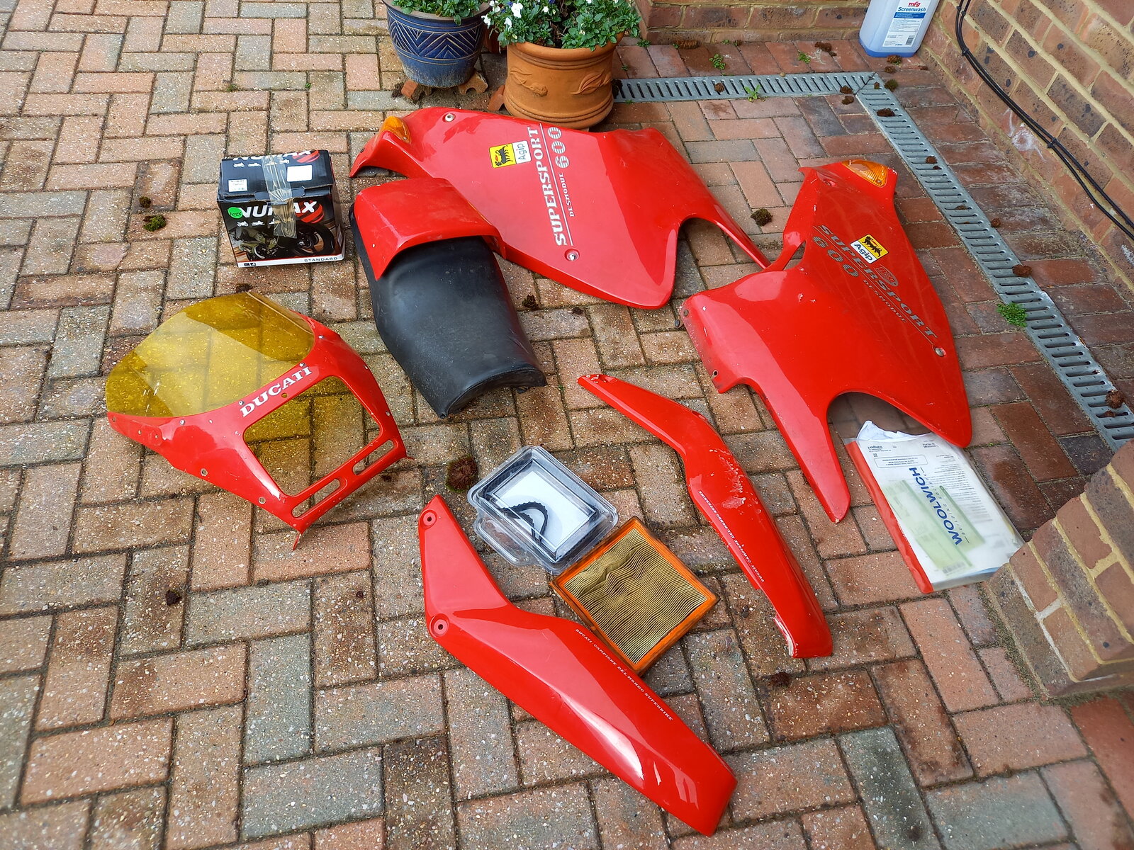

  14. So, bike turned up today and it was actually better than expected - pics attached. I do however have a couple of early questions. Haynes seem to make 2 manuals for this bike, a
    Haynes Ducati 600 750 900 Manual 1991-2005 620 2 Valve V Twins Workshop Manual (Yellow), or a
    Haynes Ducati Workshop Manual - 600, 750 and 900 2-valve V-twins '91 to '96 (Red)
    I ve assume as it is a 1996, I will go for the 91 to 96 (Red)... is this right or does it not make any difference. I have noticed a lot of the rubbers for the fairing and screen are perished or missing... can these still be purchased? Can I get a parts list?
    Lastly, I need a set of indicators, the front lenses are cracked and the rear ones are aftermarket. Again, is there a UK supplier as some people are ordering from Italy. First major job is to get the engine out, but I may just check it over and see if it actually starts.
    Looks like it will be an interesting project and will be fun getting all the corrosion and oxidization off.
  15. Is it the rubber nuts you are looking for (Wellnuts)? They are still available from Ebay or many other suppliers - I use Kayfast. Kayfast also sell the reduced head allen bolts the factory fitted to hold the fairings in place.
    Do you want a clear screen to replace the yellow tinted one you have? Cheapest place I found is Wemoto.
