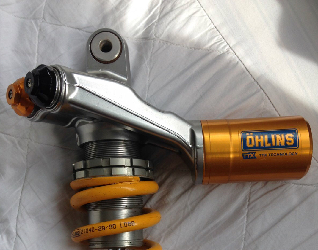

    Also, are they two on a TTX, low speed and high speed comp? (cant remember, been a long time) although I thought both click

  11. My ttx has 2 ....

  13. thought so...both click tho, right? Providing OP is talking about comp nor rebound, which IIRC doesn't click, but you can feel as it moves between 'stages'
  14. if its the top knob, it should click.
  15. They both click ... :upyeah:

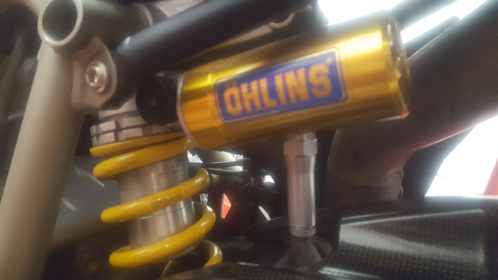

  16. I only have 1 knob..... I'll take a pic hang on
  17. I have 2 :upyeah:
  18. @RickyX gets the blankety blank cheque book and pen! I've just done what he suggested and the clicks are back! Thank you all for your 2penneths.
    It looks as though there was a bit of dirt and muck in there. Those ballbearings are a buggar to get back in...i had to resort to a tiny bit of grease to hold them in place!
