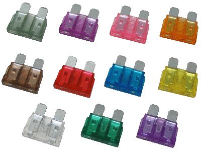

  13. I assume they are the flat fuses like this picture
  14. Bike size yes. Car size no. Mistake made before, yep.
    Got 50 car ones if you want them...
  15. Nah ya ok mate I will buy some bike ones :)
