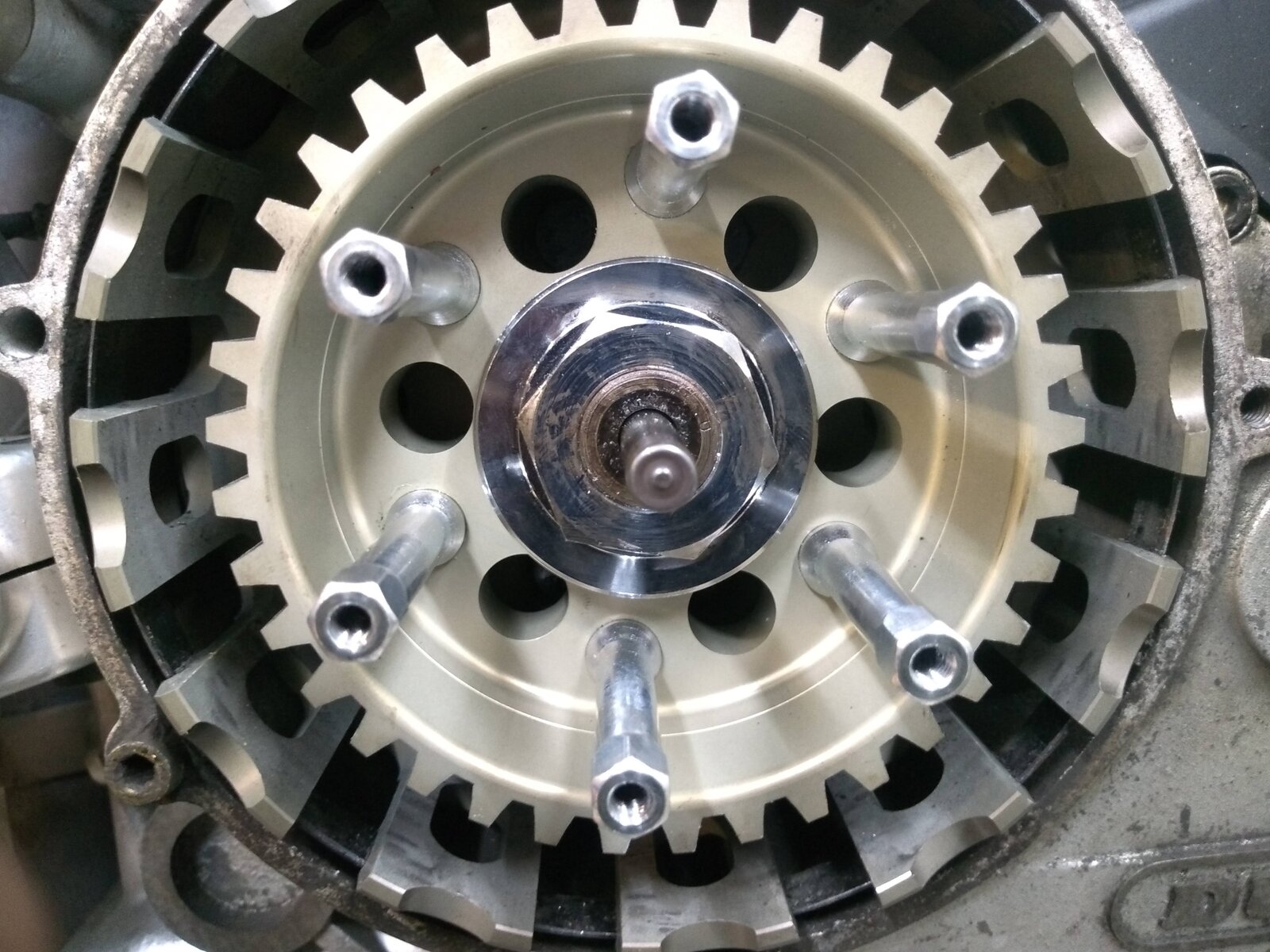

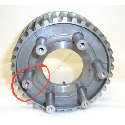

  2. did you line your notched spring post up with the notches on the pressure plate ok?
    The first picture shows pressure plate out by one post:-
    I hope you can see the enclosed picture, struggling to get it to post..
    #2 Chris, Jan 21, 2022
  3. It's a different clutch centre to that - I couldn't see a notched post but I did line the notches up and the lined up the notch on the pressure plate clutch_1.jpg clutch_2.jpg
  4. I did line up all the grooves but I'll mark a post just to be on the safe side...
    I might have put the spring spacer in backwards though..
    I'll put the old centre back in too and give it another go..
    I was thinking for the last couple of hours "have I bought the wrong clutch" so thanks for the comments, I feel a lot calmer now
    Cheers!!

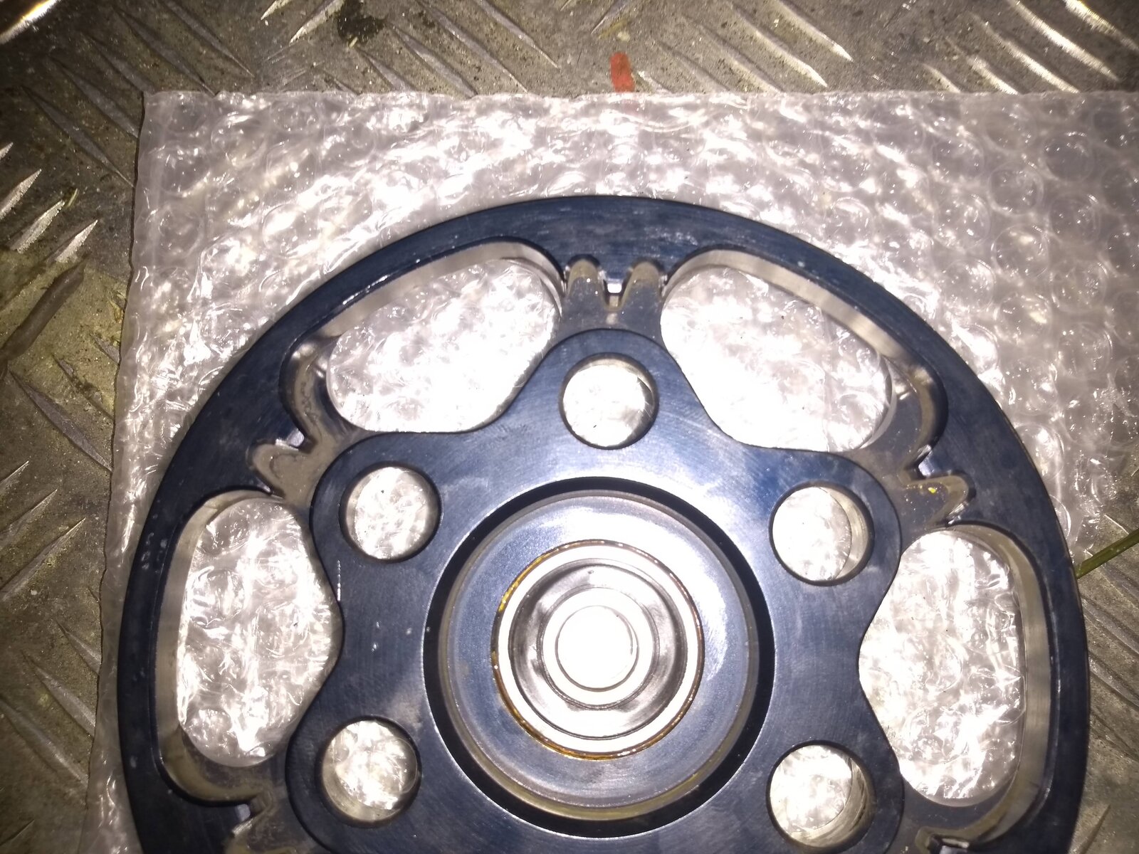

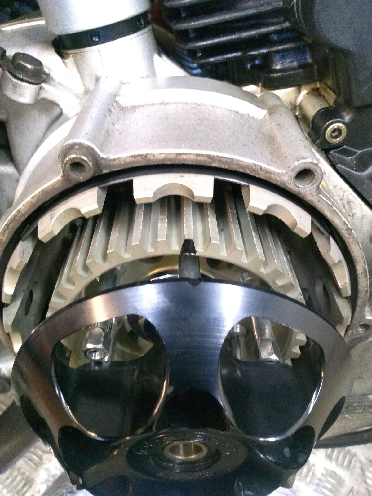

  12. Ok, worked out what was happening. The pressure plate was being lifted off the drum, turning a fraction and ending up sitting on the drum...
    When I found this I flipped the pressure plate over and you can see scores in the anodising... I've not looked closely at the oberon plate before but the teeth that engage with the drum are not all the same - one of the sections has two notches, the rest have one and the two engangements either side of that are angled... (see below)
    Put the stock plate on and that works fine...
    Would obviously prefer the oberon plate as it looks nicer through the vented cover so if anyone can shed some light on this... It might just be incompatible with the new clutch...
  13. glad you posted the pic of that pressure plate, a couple of things come to mind, i've never seen a pressure plate with so few corresponding engagement slots for the clutch plate teeth to bear against, I don't think it's a good idea to have so few (areas of engagement). Have you tried laying a clutch plate on that cover to see if it nests nicely? I wonder if the p.p. is meant for an "even" number of teeth on the outer diameter. Also - scratching my head here, there are no easily visible shoulders* in the clutch spring holes for the lower spring cap to bear on? perhaps only visible from the other side.
    *EDIT I think I see them, just a bit "slender"..

  14. Obviously the pressure plate is lifting clear of the clutch drum/centre when you pull in the lever.
    I think that you need to reduce the deck height of the plate stack to make it work.
    Steve R
  15. Unless the crucial dimensions differ between the two pressure plates, it shouldn't make any difference as same plates used and worked ok with other pressure plate.
  16. Exactly it sounds to me that the after market plate has different dimensions to a OEM plate.
    Steve R
  17. Agree, haven’t they often.. pain in the backside, looking back at posts on this forum, the majority of problematic clutch posts are dealing with the incompatibility of aftermarket parts. Over-powerful stainless steel springs is another.
  18. Just for clarity - I fitted the oberon plate a little after getting the bike so it has done some miles with the old worn clutch basket / drum / plates.
    I think the oberon teeth are maybe just slightly "shallower" which when it lifts is allowing it to lift over the new drum. Maybe when the plates are worn it will be ok but right now it's not. Next time I have the ducati pressure plate off I'll get a depth gauge and measure the two "side by side"
    It's running fine now with the old pressure plate so I'm ok with it - maybe in a couple of hundred miles I'll swap the oberon back in and see if it works then - maybe it just needs a touch of newness rubbing off the drum and plates.
    Thanks for your help guys - we have a nice outcome here :)
  19. I'm with you on that Chris, I can't see that being a good for longevity of the teeth, and really goes against what I thought about Oberon parts.
