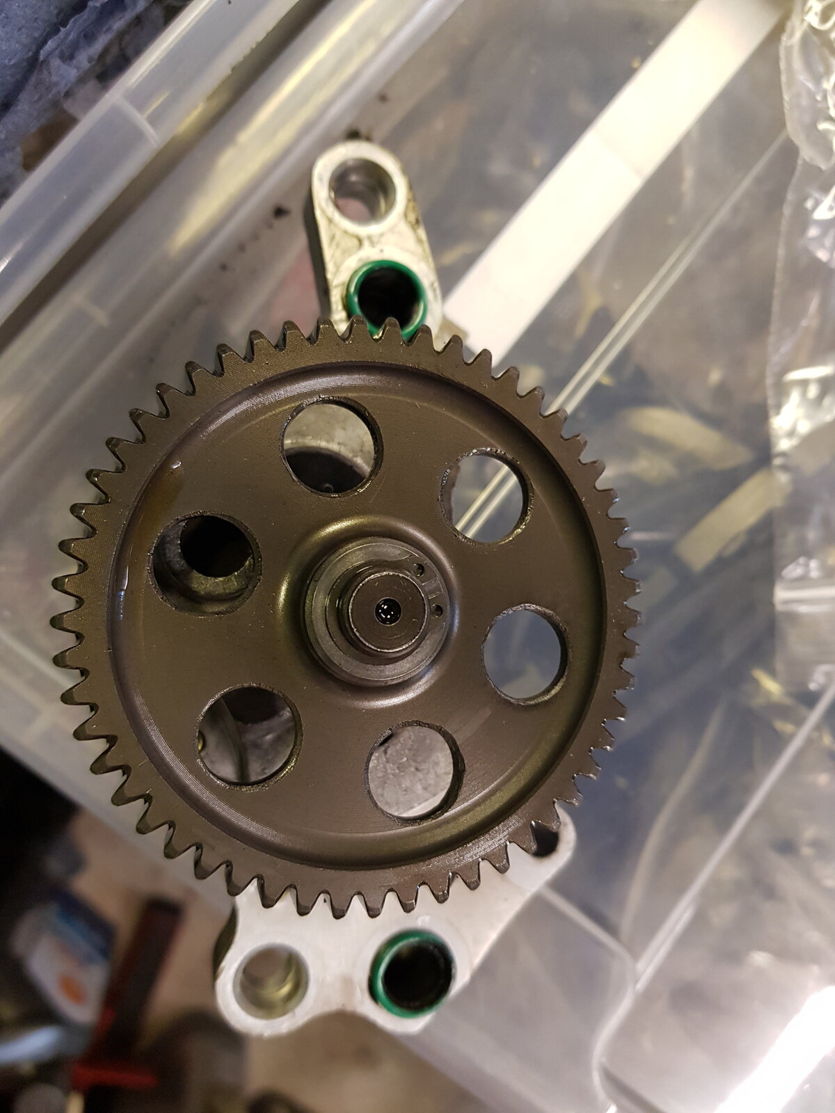

  9. I dont suspect this is the problem if the oil pump wasnt removed at all, but would a missing oil pump O ring cause this? Just curious

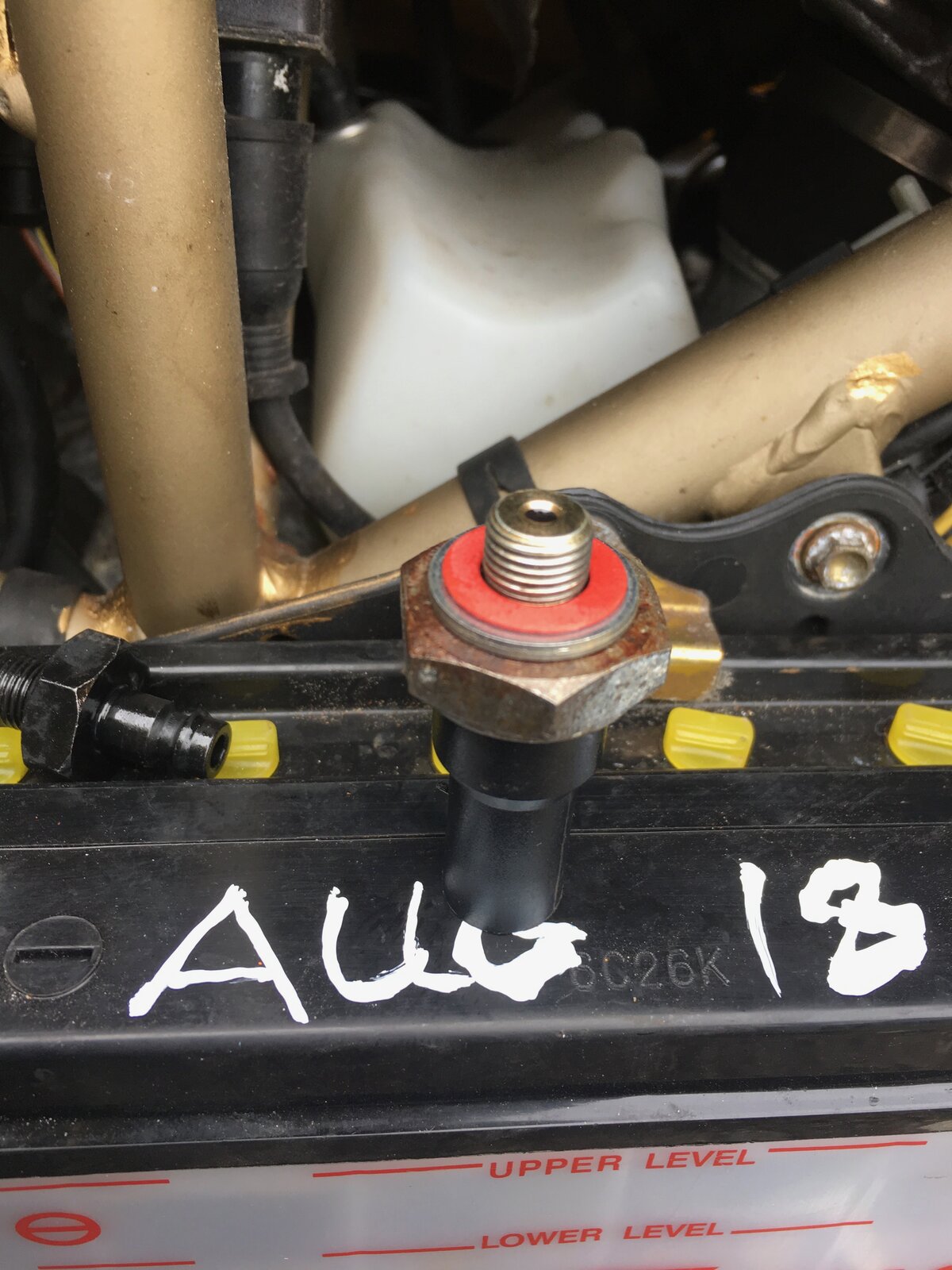

  10. At the risk of throwing in a red herring here's my experience on my 748.
    I had an issue after I'd recommissioned it last year (and done an oil change as part of that) with the low pressure oil warning light coming on. It had happened once before in the bike's past shortly after it's first service, but the dealer supposedly fixed it. I know I used the correct amount of oil to fill it back up again so I knew it wasn't low oil. Having read on here about pricing the pump I did just that, as explained above, but to no avail.
    Unsure of why I should have low oil pressure when I had an engine that had only done 2600 miles at that time :(, isn't leaking oil anywhere, or burning it, I bought an oil pressure gauge and took the measurement - 5 bar, within the range it should be. When I went to replace the oil pressure switch I thought this is weird, 'why is there no washer between the switch and the crankcase cover? its just the metal switch butting up against the metal seat on the cover. There definitely wasn't a washer there when I took it off just a few moments ago'. On checking the parts diagram sure enough there should be a washer there, so I found a washer of the correct diameter, fitted it and re-fitted the switch. I've never had the same problem since.
    It seems that by lifting the switch out by the thickness of the washer it can better read the pressure of the oil underneath. I've no idea why it worked, but it did.
    Are you perhaps missing that washer?

  13. Theres two, sit between pump and case. As shown here.... 15574268345198654180332879283607.jpg
  14. Thanks for the pic. As I didn’t take the pump off then the o-rings should be ok, hopefully. I guess if the other steps don’t work then I will remove the oil pump and check it out.
