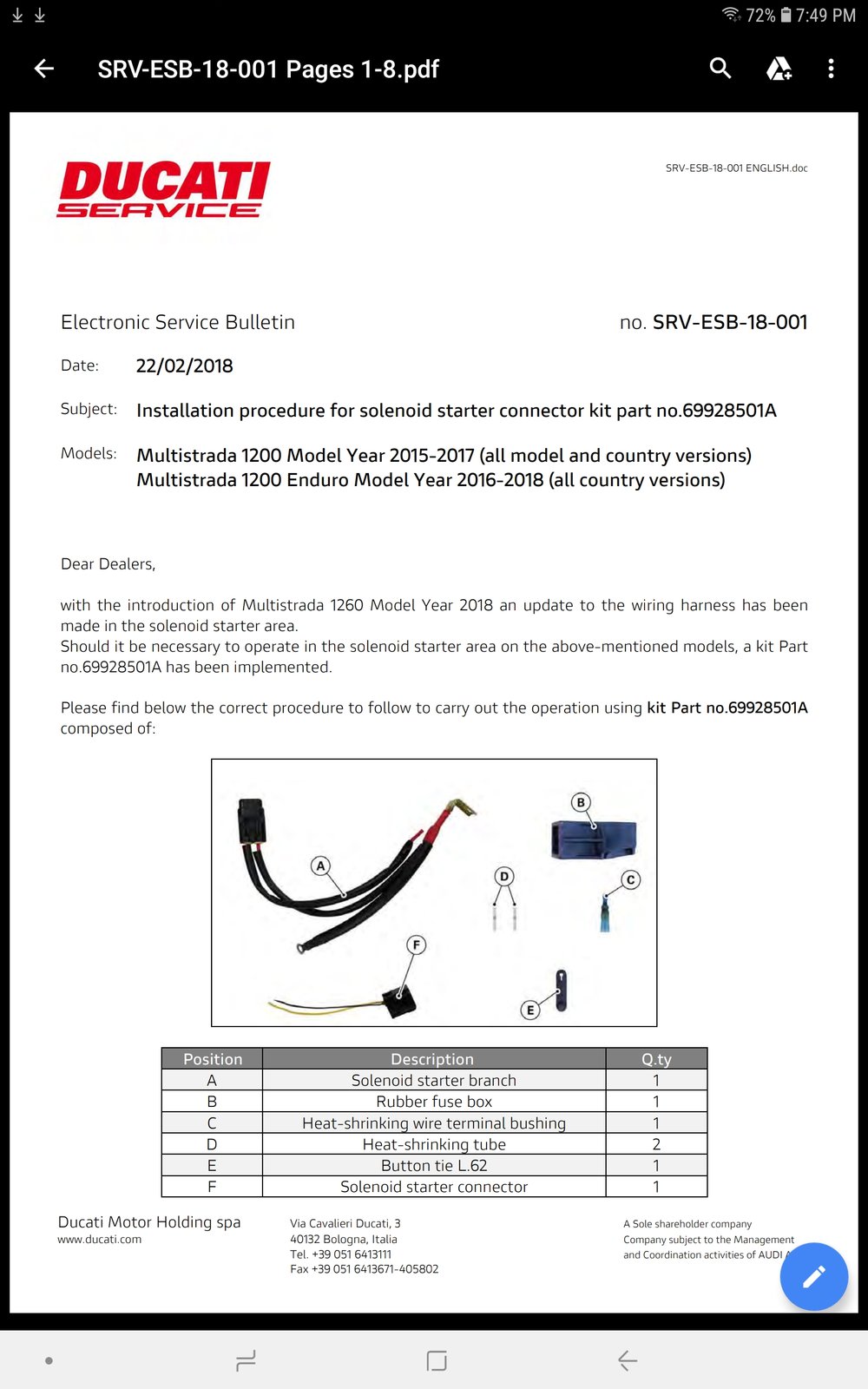

  1. I have no power on key on what so ever, even with power booster on battery. The circuit breakers seem fine. ,dash seems dead.
  2. Main fuse.30 green located by solenoid near battery, check that
  3. Weird...same problem on my 2016 Enduro today...electrical storms?
    Unplug your starter solenoid and inspect it...you might see some arc damage....its the little box with 30A fuse just down stream of the battery positive.
    Here's the dealer fix.

  7. Well dealer just informed me of my dead ENDURO, the tech apparently had to reboot the bike.
    Dealer is holding the bike waiting for the stater solenoid ESB kit.

  9. Check you starter solenoid control wiring plug for arcing.
