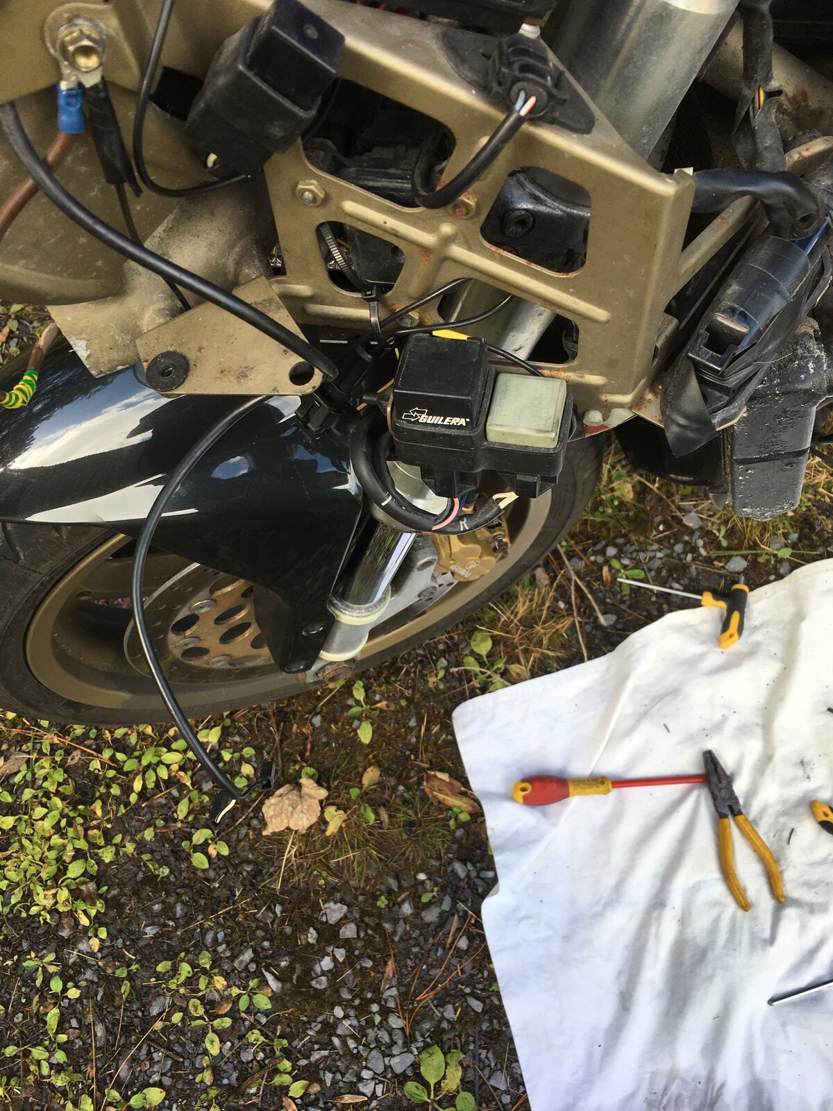

    Are the ignition relays the pair of identical ones under the seat? Rather than the 2 that are on the LHS of the forks (see photo of those).
    The pair of relays are sealed so I can't test the input or output of them as I can't get to bare wires. I've tried to test if there's 12v at the plugs that feed the coils but unfortunately the probes on my multimeter are too big to fit inside the teeny weeny little holes of the connector, I've got to find some micro-probes or jerry rig something with some strands of old speaker wire :confused:.

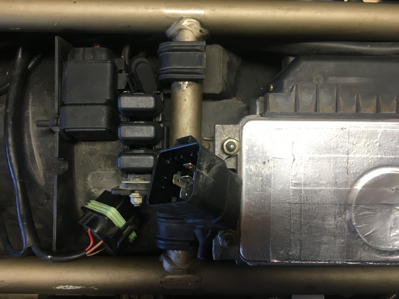

  5. So what are the pair of big black ones under the seat next to the ecu? They’re about the size of the black one in the photo, I thought they were for the coils. Perhaps I’m going mad:confused::astonished:

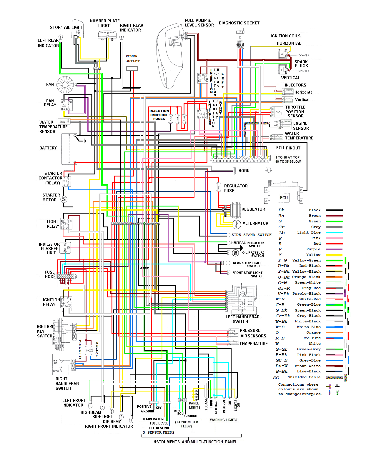

  6. injection relays I believe, one for injectors and coils and one for fuel pump possibly - I think this diagram is correct Paul? and has the luxury of wires being in correct colour (so you can easily verify by checking underseat wires leading to relays).
    Slightly out of my depth re: ST2/ST4 subtle changes to loom/ancilliaries, but this diagram (a rotated version of one I posted yesterday) is titled:- "late ST2, early ST4" so may not be correct for yours Paul, if you have accompanying handbook you could cross-reference from time to time.
  12. Thanks Chris. That looks like the wiring diagram I have in the workshop manual albeit mines b/w. I’ll do some more circuit testing today.

  14. This is really perplexing me know.
    Got the multimeter across a coil feed, turn on, crank, nothing 0.00v. Hence no spark.
    Checked fuses again but as the relays click on key on I know the fuses are good.
    Checked both relays under the seat, both clear of any corrosion. Disconnected the RHS one, turn on, fuel pump primes but doesn’t stop priming. Disconnected the LHS one as well, turn on, nothing, as one would expect. Swap left for right and reconnect both, turn on, pump primes and stops as it should but still nothing at the coils. 0.00v
    721B9B51-CEAB-44C3-B422-021A9F1814D3.jpeg E632BB9E-EF1D-45E4-93D0-0A4B15C3997B.jpeg 2E44978B-B25C-41B6-8E34-3CEEC18D133C.jpeg

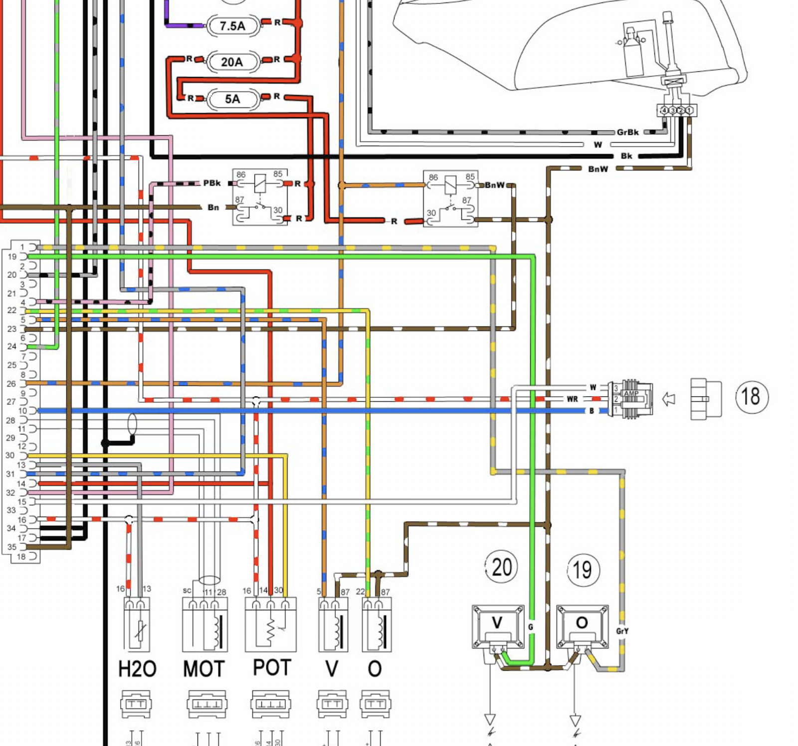

    With them swapped the operation appears normal BUT at switch on there should definitely be power to the coils. The relay output goes to the pump, the injectors and the coils - all of which should be powered for a couple of seconds at switch on.
    If I recall correctly, the relay has two pin 87 contacts. It is possible that one of these goes to the pump and the other to the coils/injectors, although the diagram shows them splitting further into the loom. Check the relay base carefully for corrosion. It is the one with 2 brown/white wires and an orange/wire.
    Also check for continuity between the brown/white at one of the coils and the brown/white at the base of relay pin 87.
    See the ST2 ignition/injection wiring below.
