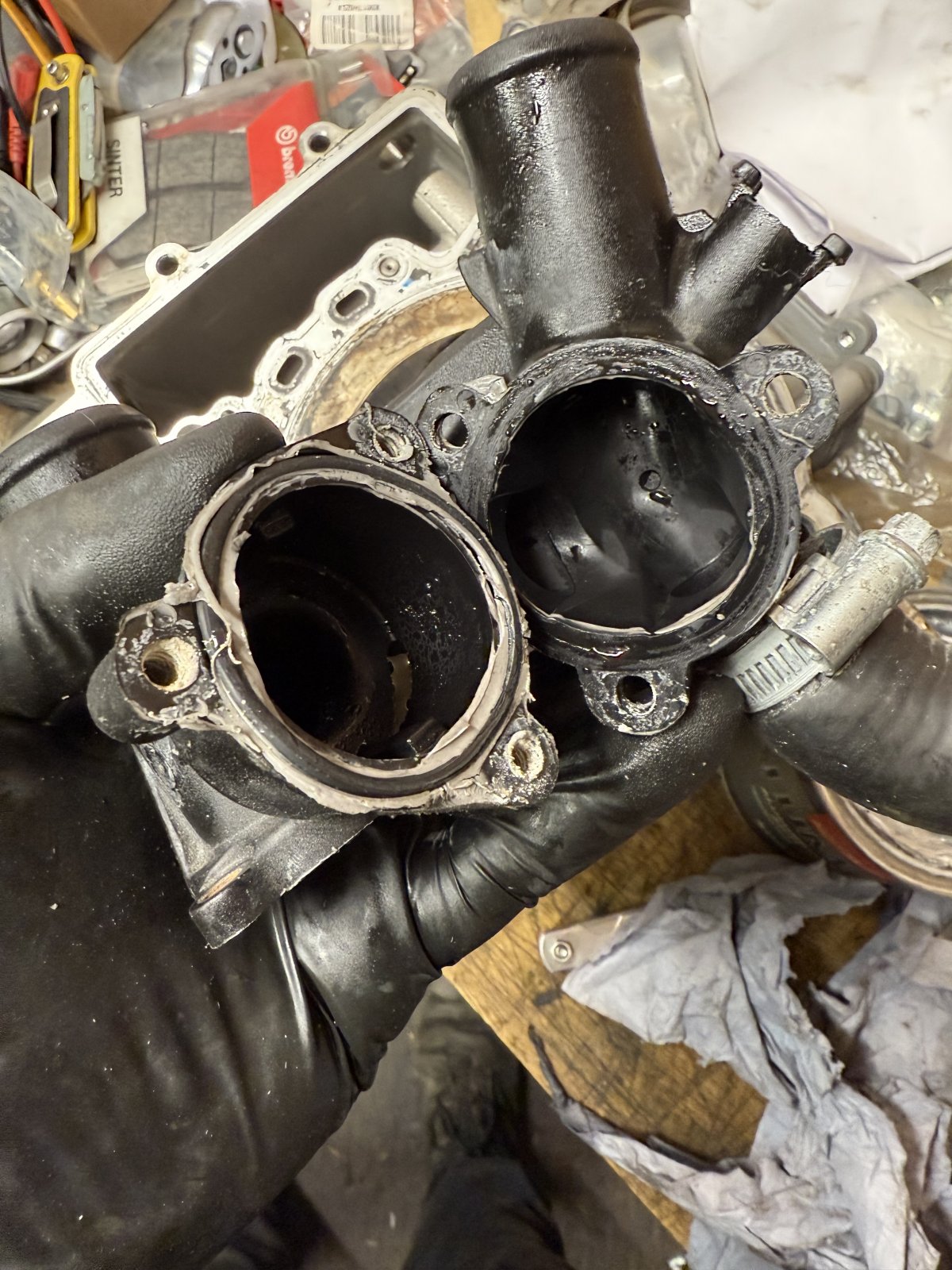

  1. Can someone tell me please the reasoning behind removing the thermostat from within the Squirter unit on a Pani 899 ?
    This is the 2nd one I’ve had in the past 4 months (2/2) where the Squirter unit has been opened by someone (other than the current owner) and the thermostat removed.
  2. Ex-race bike?
    Stop the rod from smashing out of the housing?
  3. As above. Ex race or full time track bike.

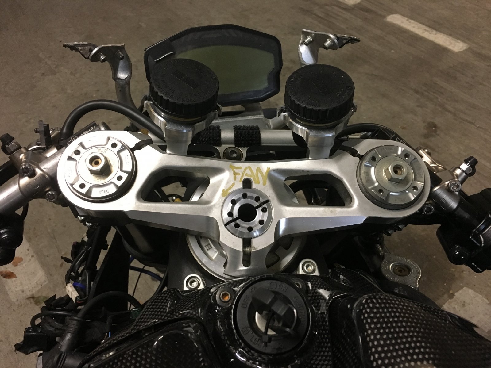

  4. This may not be relevant, but mine was removed. You can just see bottom left the very dark green manual switch poking out between carbon fibre and a cable.
    P&H Trioptions winner 2014.
  5. One of the ECU mods I get for race/track bikes is to disable the fans. These are then removed along with the thermostat. Forward motion provides the cooling.
  6. Yeah all the tri-options guys removed the thermostats, it’s one of the mods they all did.
  7. Ok, makes sense I suppose, thanks. The owner does use this one as a track only bike but he didn’t know the thermostat had been removed. He has been having some issues with cooling though although that clearly won’t be to do with there being no thermostat.

  8. FYI it is not uncommon for track 955 (proper Pani as opposed to the current abomination) Panigale V2 to have their fans retained and either switched to on constantly or to have a physical switch to allow rider control.
