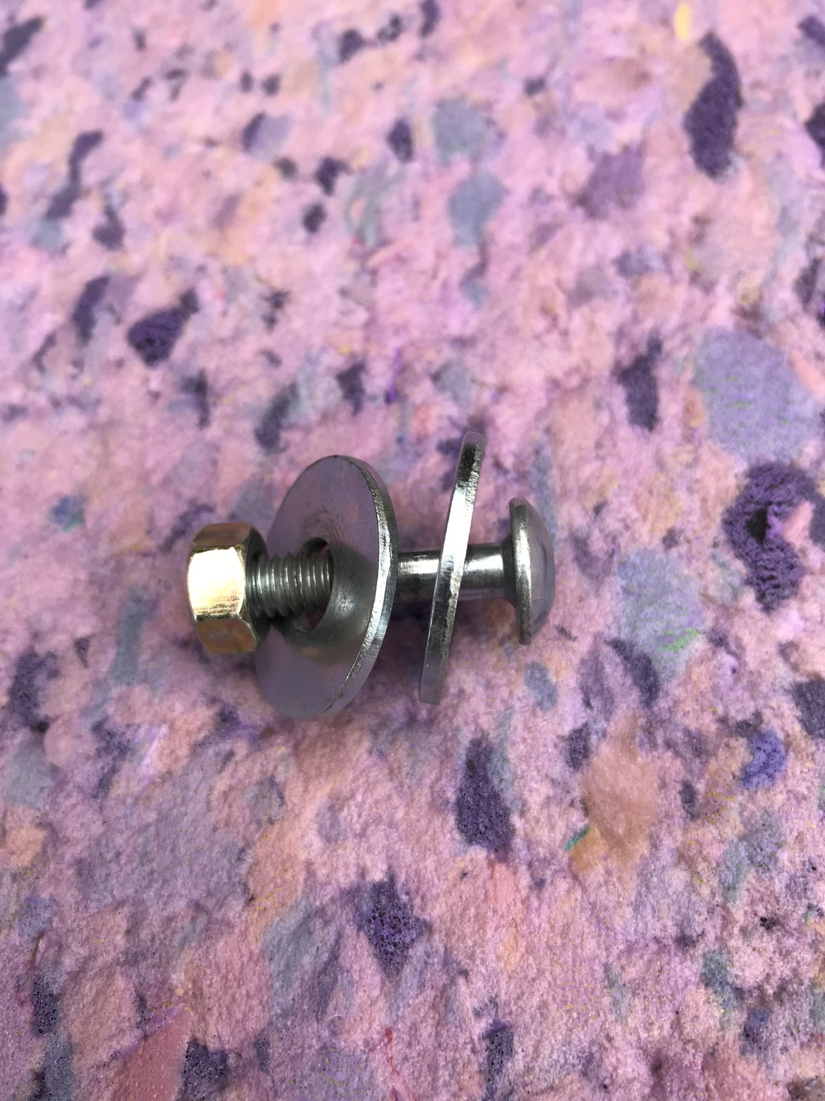

  4. This is usually a symptom of the bobbins seizing. Simple to cure using a plain 5mm cap head bolt, nut, electric screwdriver and brake cleaner. Put the cap head bolt through the bobbin, fit the nut on finger tight then with an allen key in the screwdriver, give the bobbin a wizz whilst spraying with brake cleaner. 20 minute job to do both sides. When done, you should be able to grab the disc and move it in the direction of rotation. Andy

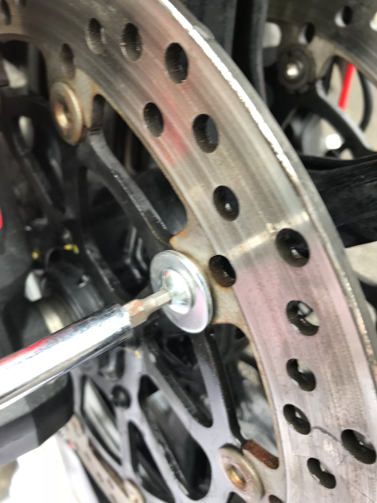

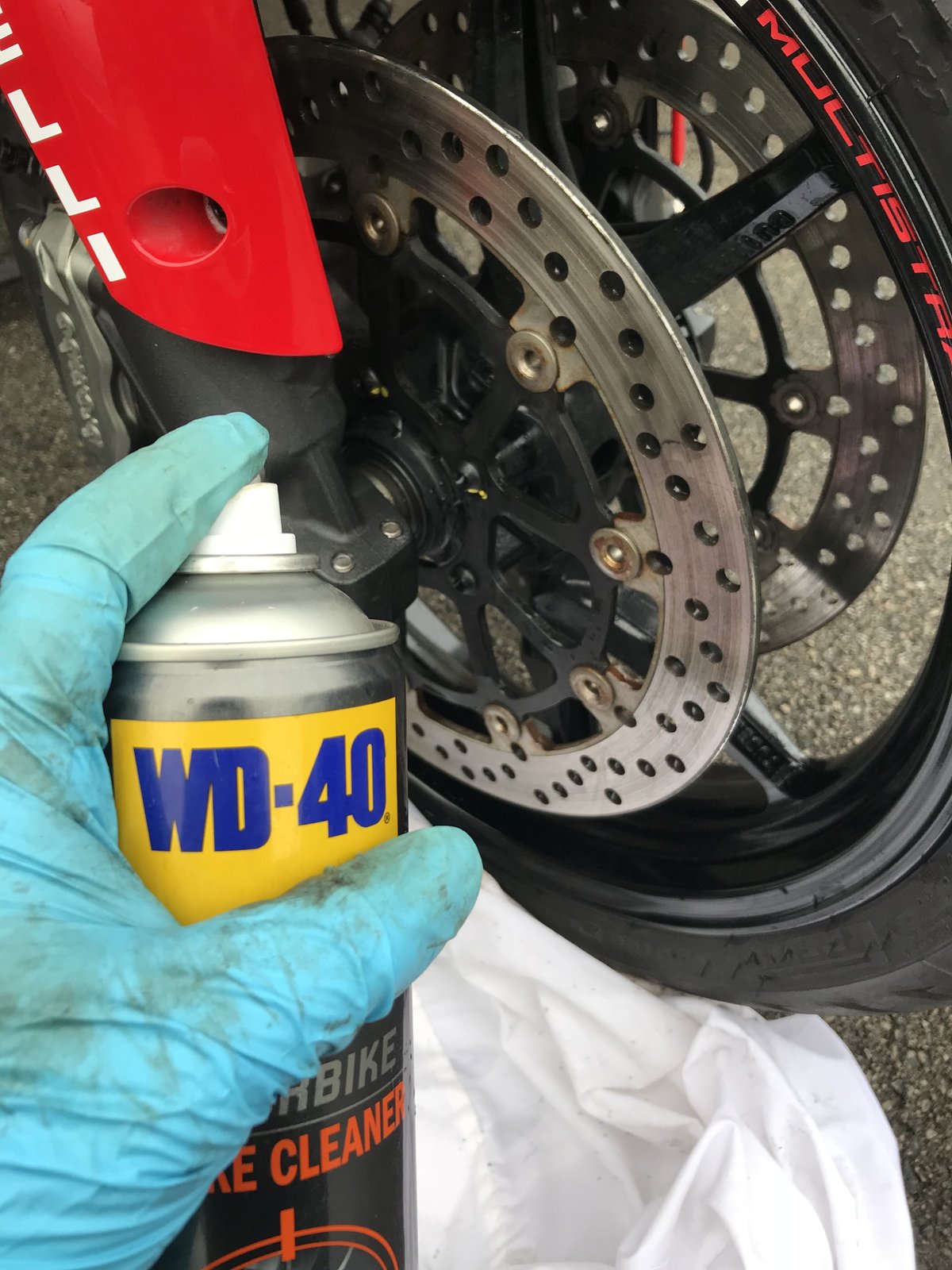

  6. I do believe I’ve fixed mine. Since week 2 I’ve had a very slight squeak and rubbing sensation from the front brake, only at the moment of stopping or when pushing it around. My dealer confirmed the discs weren’t warped and there was no symptoms over walking pace. I was convinced it was the right calliper or disc.
    After reading up on seized brake disc bobbins, I decided to clean my and ensure they’re moving as they should.
    After a little YouTube I found a method to clean and move them at home. 30 min hard work later and I’d found most were very stiff, with a couple almost siezed solid. One on the left disc was seized solid. But soaked in brake cleaner and some perseverance paid off. They’re all free now and the squeak and rub is gone.

  7. Worth mentioning in case some only glanced at the pictures, that^^^^ is WD40 BRAKE CLEANER, never get wd 40 normal anywhere near them at any time.
