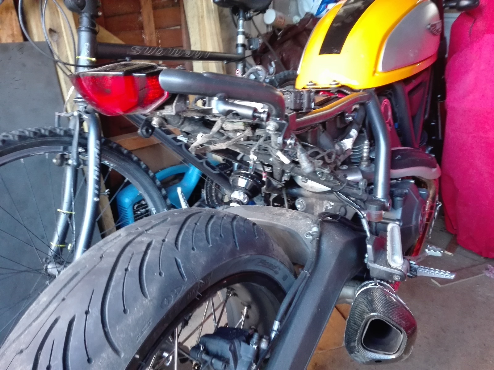

  1. Well, now that the bikes are off the road for the winter. I thought I'd get round to doing something about the number plate lights. Both of them are similar with 3 surface mount LEDS on a small circuit board. Unfortunately they are glued together and very difficult to get into and I didn't do the clear plastic piece any good when separating it from the housing. I ended up replacing the original circuit with 3 high brightness white LEDs with a suitable resistor mounted onto a small piece of perspex and embedded it in clear epoxy that I also used to glue the clear cover back in place.
    Anyway if you ever need to replace the number plate light, it's a bugger of a job with most of the rear of bike having to be removed to get at the connector which is tucked under the ECU with about 2 feet of spare cable length. Seems they must have used the same loom and number plate light for all the Scrambler variants.
    Putting it back together was a very fiddly job where 3 hands would have been helpful. At least I got chance to get it all nice and clean under there.
