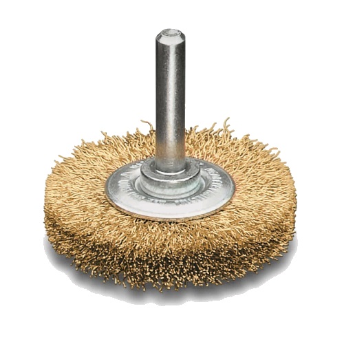

  2. Use a brass rotary wire brush, not a steel one, that dulls them but brass brings them up a treat then Halfords clear laquer over the top. Did this to mine, remained shiny no matter what weather I threw at it. :upyeah:

  6. I reckon if you paint them you won't need laquer but it can't hurt eh. Make sure the wire brush for your drill is not carbon steel , brass plated. Make sure its brass, halfords do them at about 6 quid I think, bought my nuts up a treat....Oooo err Mrs :p

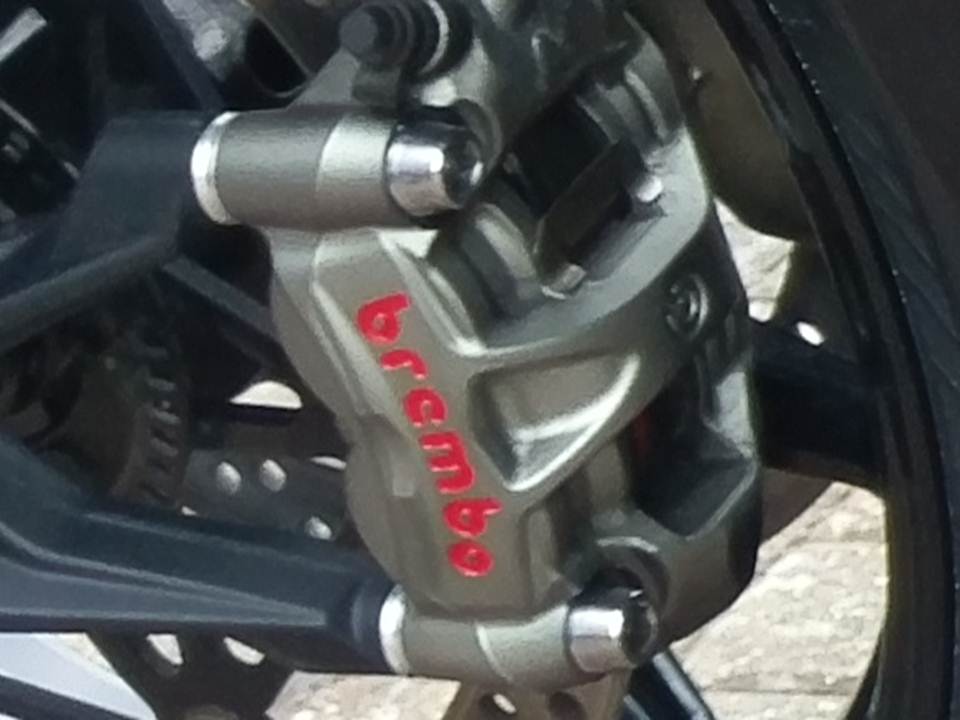

  8. PS, if it's hex bolts and not allen bolts, might wanna leave them to harden for a day or two then use cloth inside the socket to tighten, if its allen bolts like the calipers have, just crack on, laquer and fit :upyeah: This was after 2 very salty winters and did the above, excuse the quality of the pic, its a cut from a whole bike pic.
