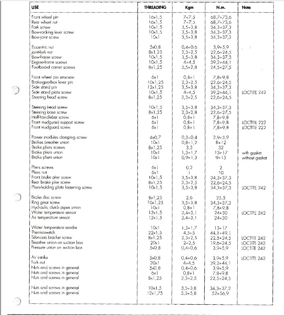

  1. Has anyone got a partial list of the common nuts and bolts (888)width length pitch? Bit cheeky I know, erm I have to replace lots. I won’t get started on the TI stainless thing. So it’ll be like for like In anywhere contentious (brakes for example) and stainless where it’s not.
    I saw a list somewhere but I can’t find it. Cheers if anyone has anything. If not it’ll be the hard way.
  2. Hi
    Don't know if this helps, it's from the Workshop Manual for my 851 SP3.
  3. Amazing. Thanks!

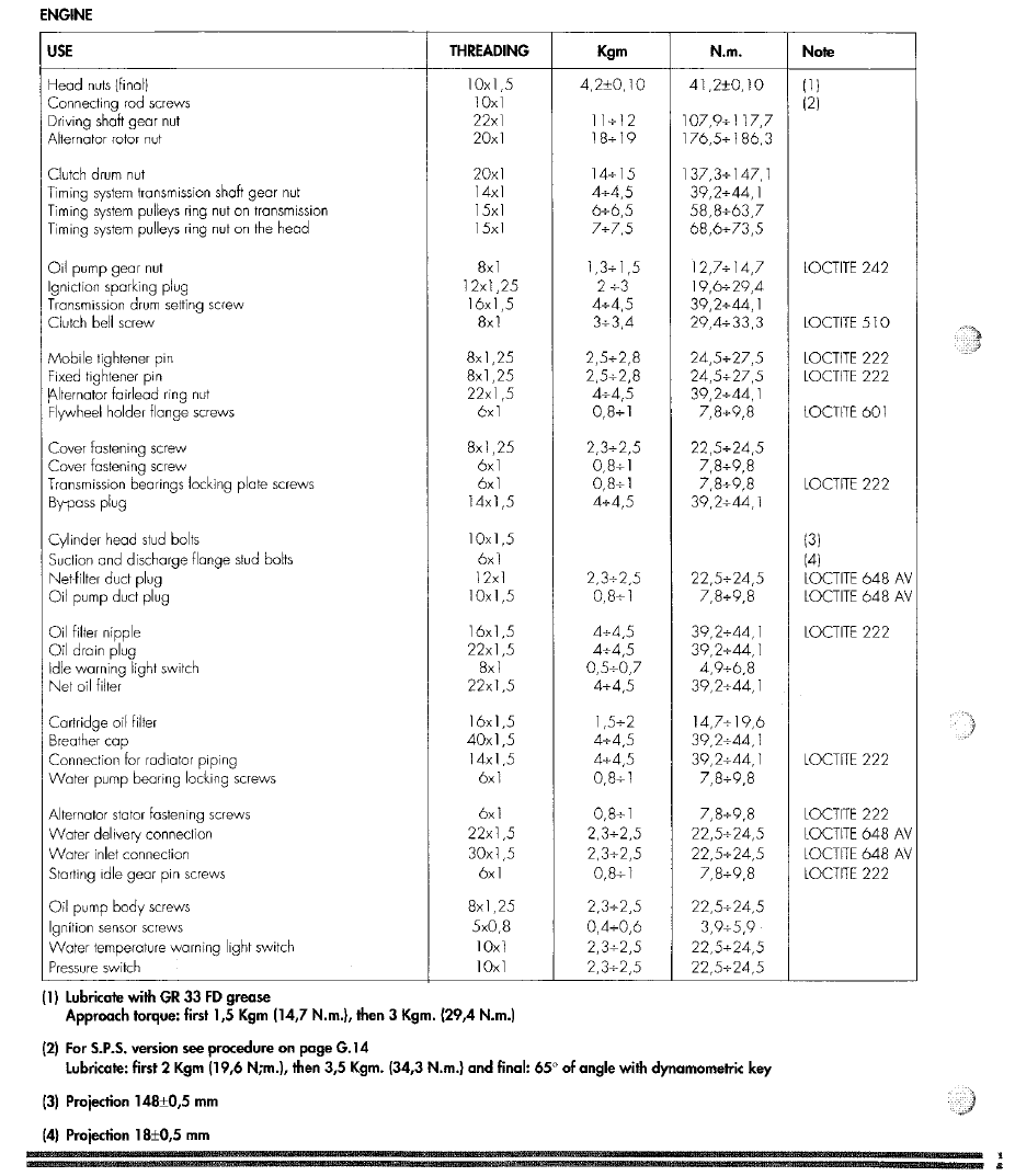

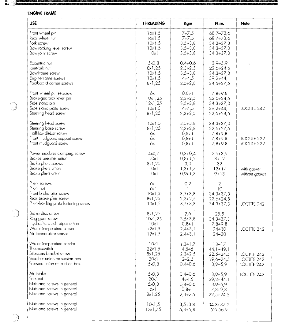

  4. Just in case there is a difference - these are for 888 (SP4).
