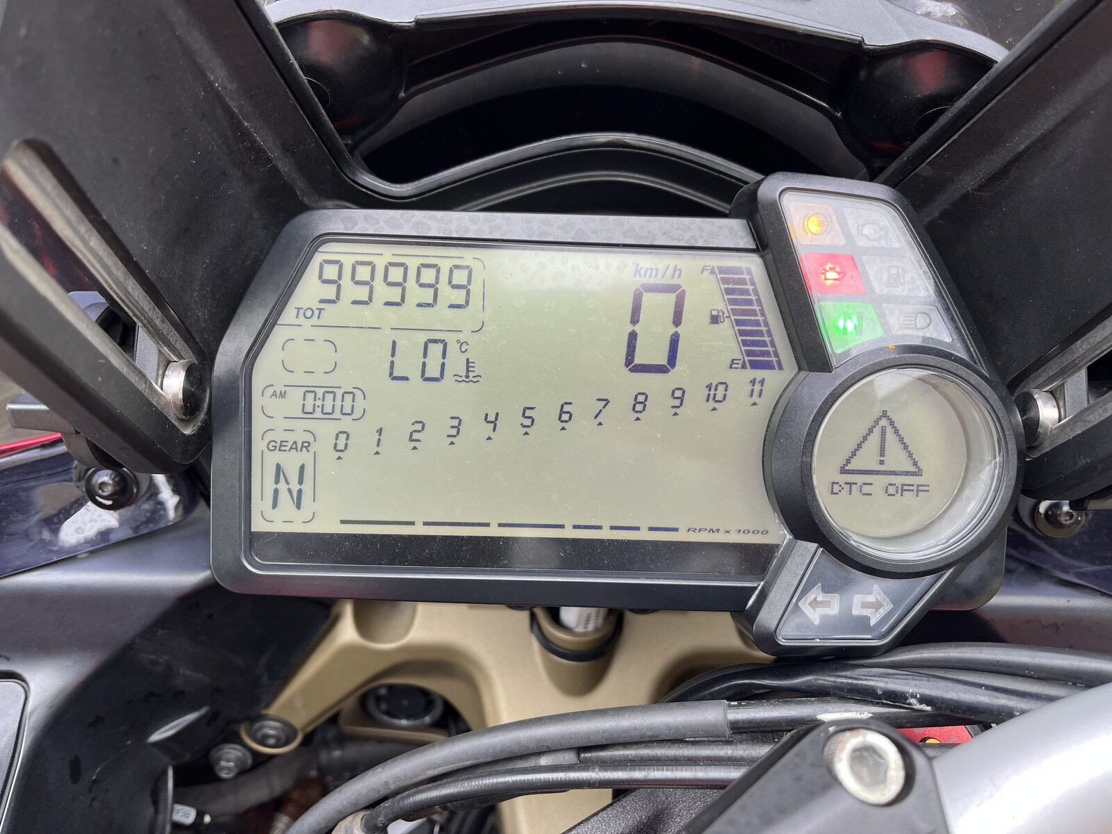

    I've bought a used multistrada in a private sale. When I went to view the bike the battery was dead, but the guy jump-started it with a booster pack. The bike was immediately doing funny stuff, like ABS fault, engine management light, DTC fault, etc. and the odometer was also showing in KM and displayed as 99,999KM. We changed the odometer to miles and it was still showing 99,999miles.
    They guy put the bike on the charge, took it for a spin the next day and all the faults, etc. cleared, except for the wrong mileage.
    I checked the bike history and the was an MOT from just a few months ago showing the mileage as 27,000 and the bike was advertised as having 29,000, so it all seemed to check out. (Perhaps foolishly) I bought the bike anyway, presuming that it might sort itself out, or worst case it would be an easy fix.
    I have fully charged the battery, had it for a few days, took it for a spin or two, and it is still showing 99,999 (both miles and km).
    Is this a common problem, and does anybody have any trouble-shooting suggestions that I could try before taking it to Ducati?

  3. Like others, I had my dash replaced under warranty some years ago because of an intrinsic fault (mine is a MY2010). So it is technically feasible, however this seems to me a dealer's job. Also, in the second photo you have posted here the DTC is off - which is default in the early models after a battery disconnection. If DTC still off, check this thread.
    https://www.ducatiforum.co.uk/threads/dtc-off-error-on-multistrada-1200s-2010.51824/
  4. This type of dash is sealed. There is no easy way to access the circuit board other than cutting it apart. Reading the chip is easy but you would need to find someone who knows how to calculate the checksum to store the odometer reading in memory. It could be worth a phone call to Mark at Scorpio Electronics.https://www.scorpio-electronics.co.uk/

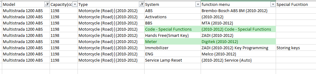

  10. Not sure if this is any help but with an OBDStar diagnostics tablet and what looks like the additional Odometer Adjustment licence it might be possible. You'd need to make enquiries first to be sure. Contact BMDiag, from the first link, they're usually very helpful.
    If that's a workable solution it'll be cheaper than a new dash and at the end you'd have the useful OBDStar in your toolkit.
    Below are the lines from the OBDStar capabilities spreadsheet for your bike
