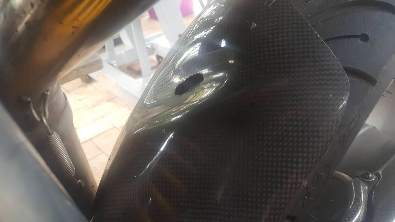

  8. My rear hugger tends to bounce a bit even though it's mounted properly. Does anyone else have that problem? It means that the tyre has rubbed a hole in it in that funny dimple. 20171203_155145.jpg
  9. If you have a DP Hugger, or good quality copy of, you'll note a hole where the hugger meets the inner face of the swingarm. Drill and tap a hole in to the swingarm, secure the hugger to the swingarm and the problem is solved!
  10. What profile tyre have you fitted ? IIRC, the oem was 180/55 so if you have a 190 I think the profile should be 50 otherwise the tyre is too close to the hugger. I've had the same problem on one of mine, ended up just chucking it. Andy
  11. 180/55 Andy. It's a 748.
  12. Same problem on mine (MY02 748S) with the DP hugger which was an issue with new Pirelli 180/55s for a few months until the tyre had worn down. Issue fixed with a correct ride height set up and changing the rear sprocket to 40 teeth with a 96 link chain (std is 94). I also don't use Pirellis any more but that is just coz I hate em. It did not wear through before the suspension was sorted but I have now removed it as the CF is now very dull, green and lost its lustre. Will try a rub down and respray of clearcoat sometime in the spring.

  13. I've got a QB carbon hugger. Doesn't have the exhaust clearance 'dimple' and has never touched the exhaust, it does however tend to sag slightly on the unsupported RH side (I think most do) and as it wobbles a little when the bike is moving it does very lightly touch the right side of the tyre - never worn anything more than a shiny stripe near the edge of the tyre.
    When I leave the bike parked in the workshop I stick a piece of plastic (meccano) in between hugger and tyre to help stop it 'setting' to the sagged position - especially when the exhaust is hot - actually QB carbon recommended this as they sag because of no support on the RH side...
  14. You could dremmel a nice oval there, lacquer the edges and it would like like part of the design.
