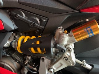

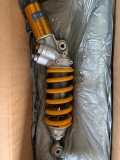

  1. Ohlins TTX shock for 1299 and others.
    Looking for £695 would prefer collection or meet up.

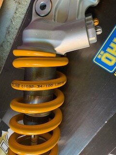

    The spring fitted to the shock for sale above is 100nm so is very stiff in comparison to the stock 899. For the price you would be getting it for however it’s not a big deal to buy the right spring for your weight.
