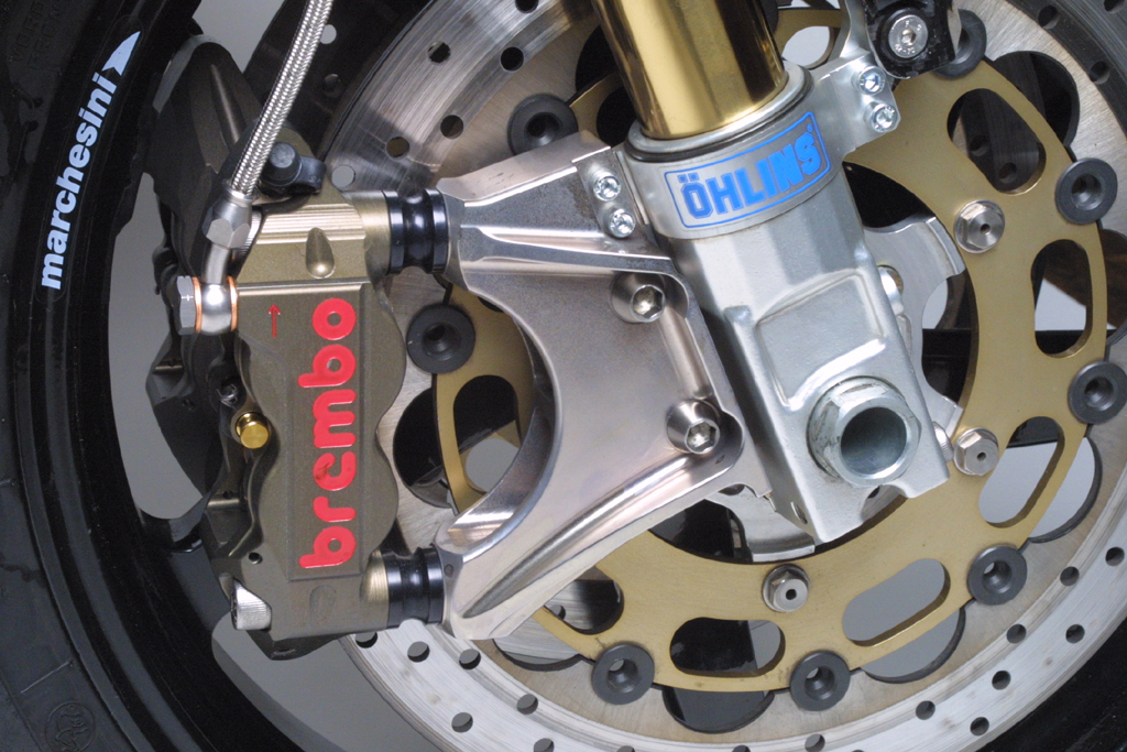

    there are 2 diff types of FG43 fork bottoms
    if yours are like the pic in the link, then you can try and track down some Cyclecat OBM1 I adaptors. they dont make them any more, but they do show on on US ebay occasionally

    also spoke to harris performance a while bacl who had some old stock of brackets (much like the cyclecats) to fit 100mm callipers for about 150 quid + VAT but you need to get them machined to fit the correct rotor offset and then buy/make correct calliper spacers for the rotor diameter
    Harris supply them with a technical drawing so if you have the ability (or access to a cheap machine shop that you trust) then these are a good option, if you want harris to to machine them and supply spacers etc the cost does jump up over £350 quid which is getting on for Bursi money
    heres the pic they sent me, i ahve seen them in the flesh and they are very well made (as you would expect from harris) and i think they are quite nice looking for a bolt on bracket

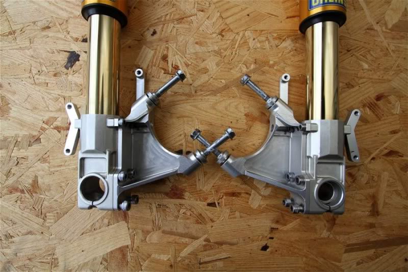

    funkatronic, no mine dont bolt that way. I'll take a pic tomorrow evening and post it. Actually, googling....
    these are how mine bolt on.
    and this is how they look with the radial bracket. This is what I am after.
  7. No thems not the sorts mate. See how those adapters above bolt on via 6 bolts. Thats what mine are like but with the 40mm adapter. I want to go radial and they do do an adapter.
  8. ah right, yep thats the later type of FG43 fork bottom
