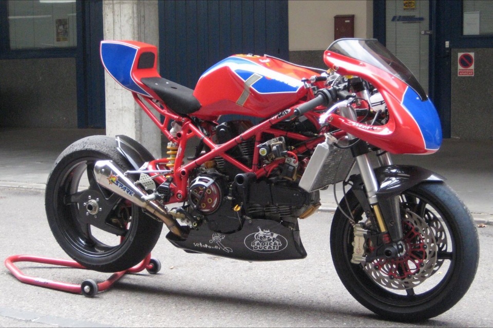

  4. Unfortunately no mine are not adjustable, but, I am basically transforming this Bike from a hyper to a modern cafe racer, with clip ons rather than straight bars... So I wondered if say 848 ohlinns might fit or similar..
    I'm building a modern version of this kind of thing really..

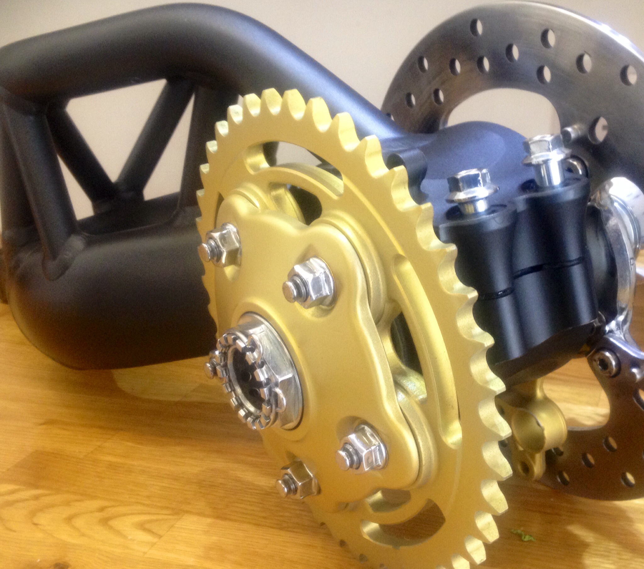

    It's basically same as I'm doing but in reverse.. Work competed so far is stunning I'm pleased to say .. I'm very fussy and things take much longer than it should.. Pic of my S4r swingarm stripped re painted and modified to fit.. image.jpg
  10. Theres some nice ideas on duccutters
