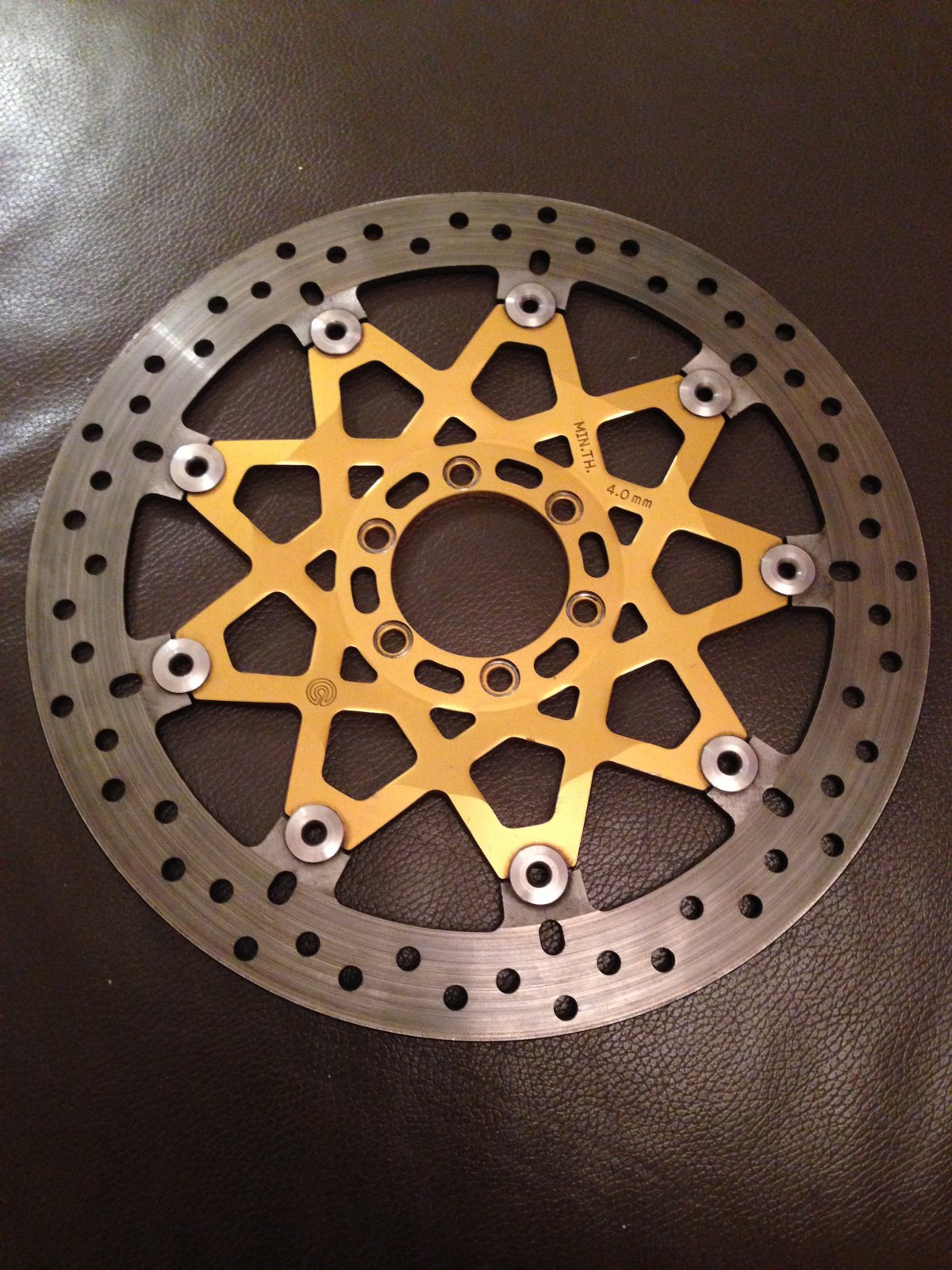

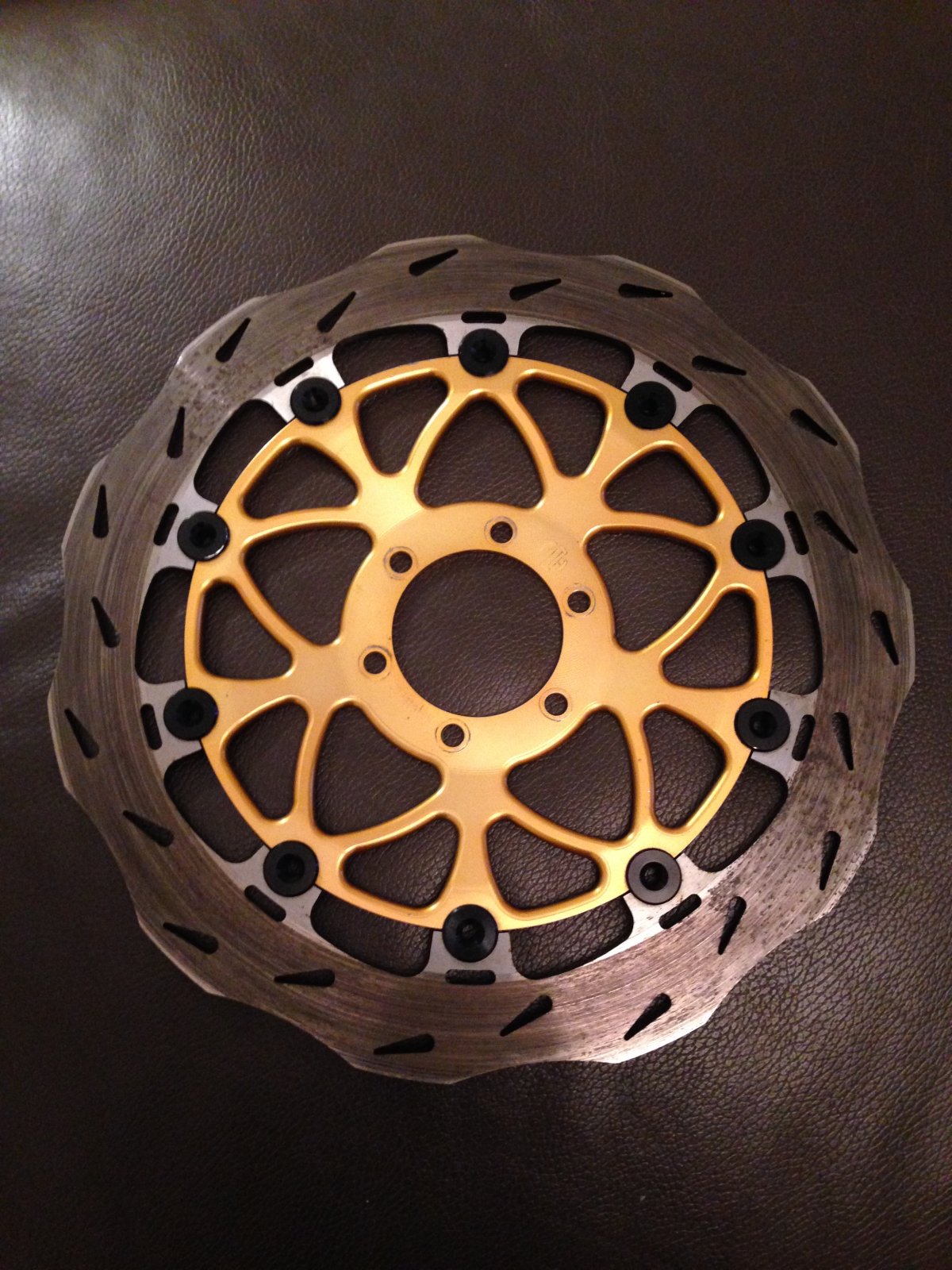

  6. I've got some nice 998 floaters or some Althea racing wavey floaters if you fancy a swap for the 15mm ones :)

  12. They are fully floating Brembo 6mm ones not selling I keep everything
