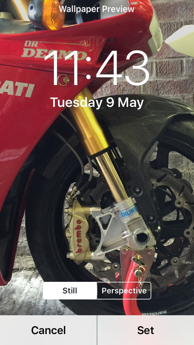

  10. Interesting! Are there pictures available of the forks and rear shock?
  11. Not too difficult in terms of work but fairly costly, although you may find the 1198 Ohlins easier/cheaper than 916 series Ohlins as they are more plentiful and newer.

    Given that I had to remove the stem from the yoke to do the swap, I took the opportunity to replace the steering bearings.
    Here's the end result;
  12. I put FG43RT on my 916. Apart from Mag wheels its the next best mod I did to her. Shes more supple and I can feel the front better. As long as you keep originals, then I dont see an issue.
    (sorry for iphone screenie but its all i have access too atm)

  16. Cheers for the reply , she looks great , more modern look.
