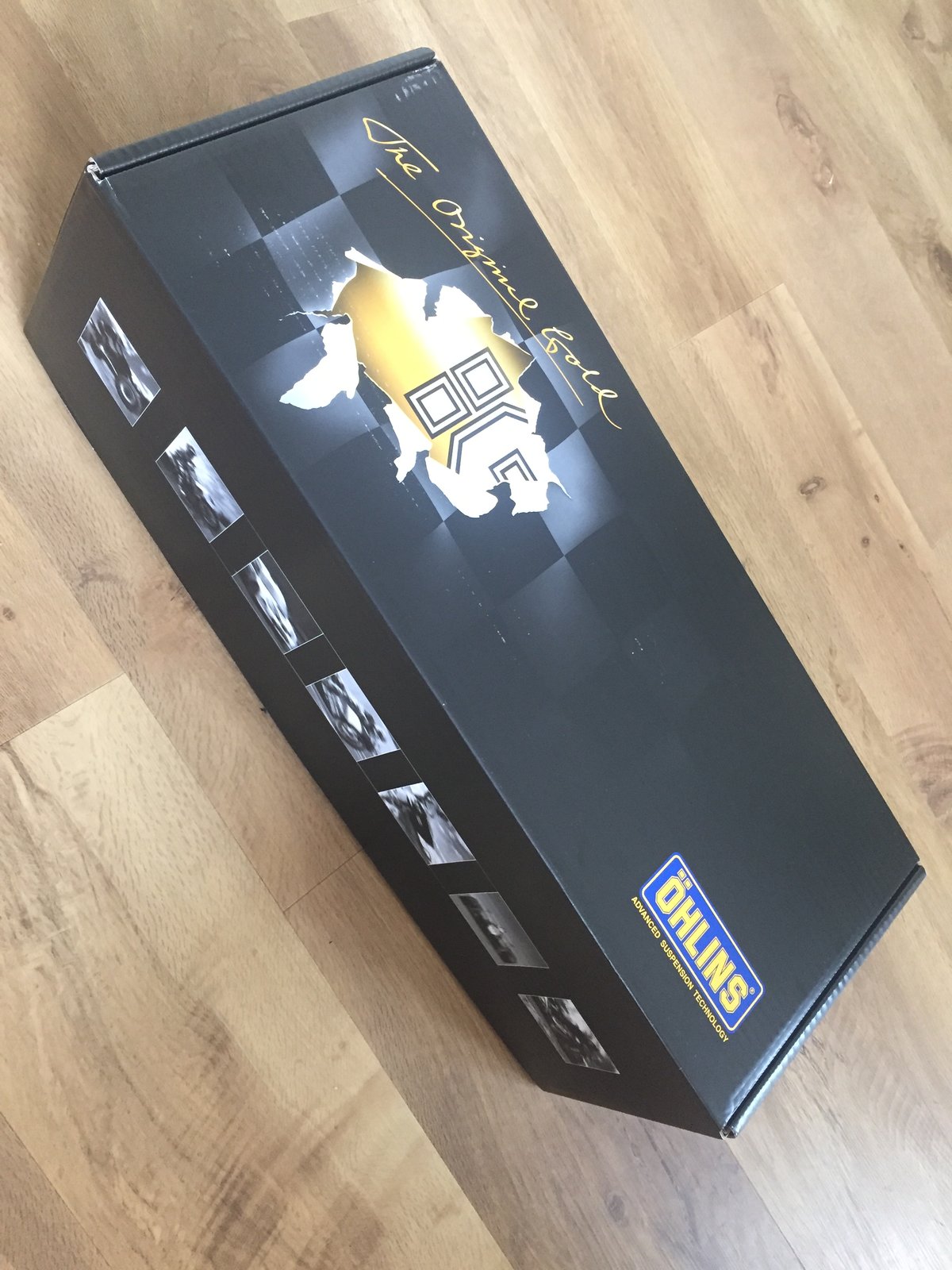

  1. Look what arrived today, 4 days after ordering it from the States. Brilliant service.
    Trip planned to Cornerspeed quite soon for Nelly to work his magic
