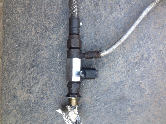

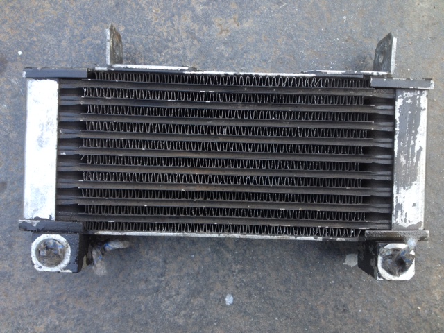

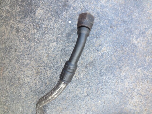

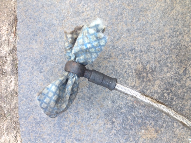

  1. What's the best way to restore the metal ends on these pipes? Dremel?
    I imagine they aren't cheap to replace with new, they function fine but are in a state.
    Oil cooler itself needs blasting I think..
  2. For the hose connections - Dremel wire brush etc.......and then aluminium paint (or black stone chip spray).
    For the oil cooler - Patience, careful wire brushing........aluminium spray paint.
    Aluminium paint - the type used for steel car wheels........brush or spray.
    I think most blasting could cause problems with the matrix of the cooler.
  3. Soda blast on the oil cooler may be ok, but the fins are very fragile. I agree wire wheel on a dremel for the hoses

  7. blast the tanks on the cooler but just leave the fins be. when you spray it just give the fins a light pass. They're going to be back to their original state within a couple of rides anyhoo.
    Other than that... what Arq said.

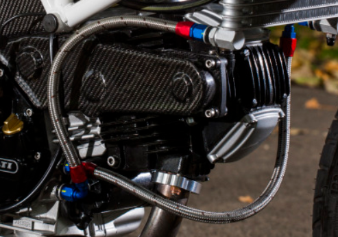

  11. I have an 848 cooler on mine. Ill take a pic. Its got a homemade mesh cover. I upgraded as its got High comps. Its still low mounted
  12. Although my 750ss had the higher mounted oil cooler, I did investigate if it could be mounted in the lower position by flipping the rocker covers over - it could. I imagine it could be done the same on a 900.
    But.........with the higher mounted cooler, it is an absolute bastard to get to the carbs idle and balance screws. (includes burned forearm).
  13. That is really tidy Sev. And those pipes make a real difference, visually.

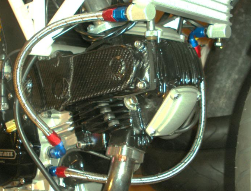

  14. Harpic MAX Power 10. rub neat on the rusty bits and agitate with a scouring pad (like for a nonstick frying pan). Once the rust starts to come off and you are seeing clean metal come through, rinse off the Harpic and dry it off (you may want a couple of attempts with this).
    Then the use of a soft wire brush in a Dremel (I bought a load from ebay and they are dirt cheap) and remove the residues and any other oxidisation. As the Harpic removes oil and grease, you will be surprised how clean the surfaces come up.
    Same engine and pipes - Just cleaner! (Engine was fully rebuilt and the surfaces Cerakoted).
    #16 Bridgland, Apr 4, 2019
  15. Wow....that. is fucking awesome!
