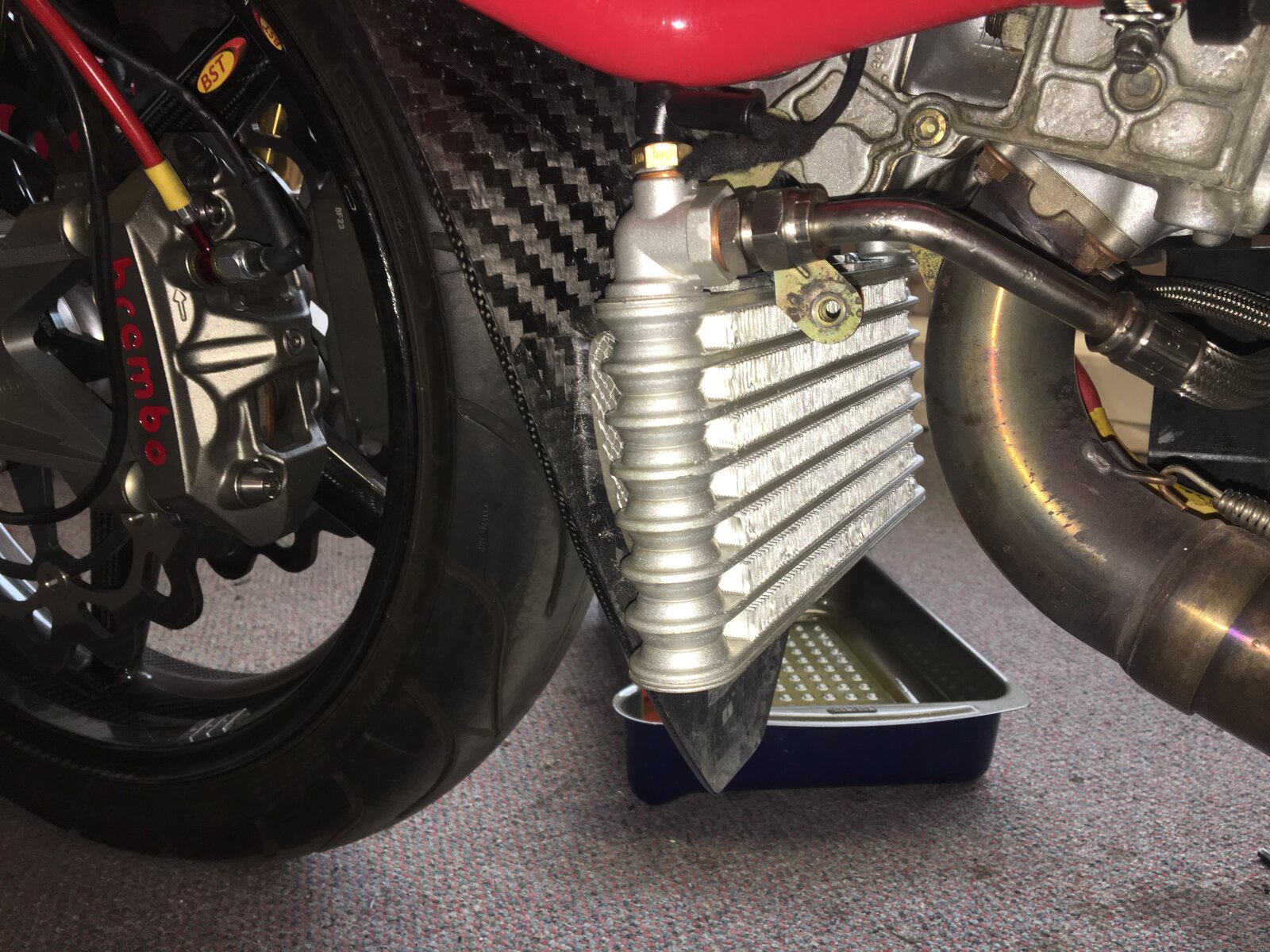

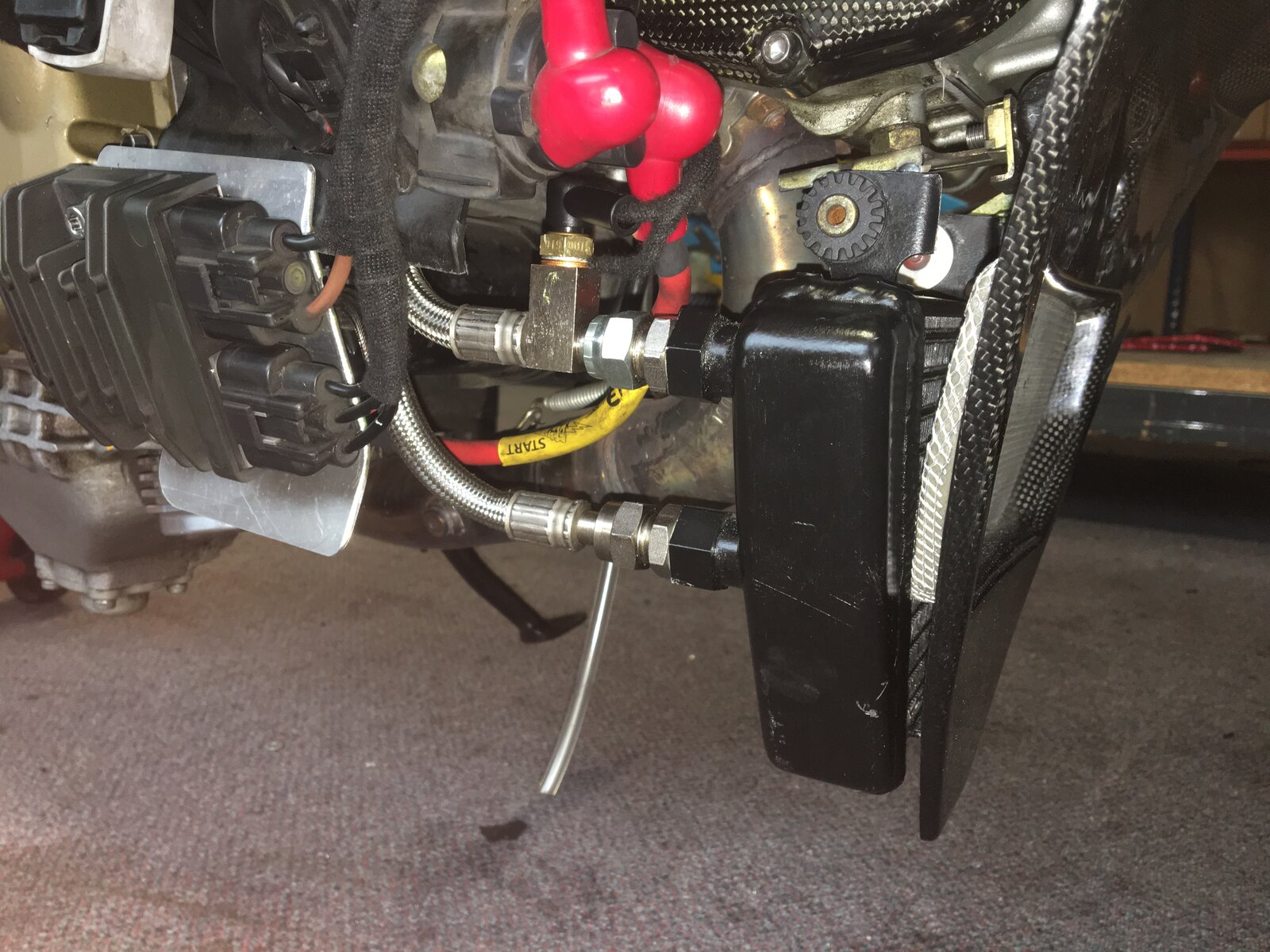

  8. I’ve got a spare 748RS cooler and lines you can try. I removed the alloy angles on the top and repositioned them to fit my 998 setup. In the end I used a 1098 oil cooler with 848 evo lines so I could fit an oil temp sensor inline.
  9. But the 848/1098 cooler is easier to fit.

    @bettes Thanks, for future proofing I’ll go with a modern readily available unit I think, like your 848/1098 one. How’s the fit with the fairing? Looks to be spot on!

  11. Easy to do. Just needed to chop and re weld the fixings on the fixing bracket. Do it right and you can make the V panel fit.
  12. That RS one in the photo has the cam feed line at the top. I used it for the temp sensor.
