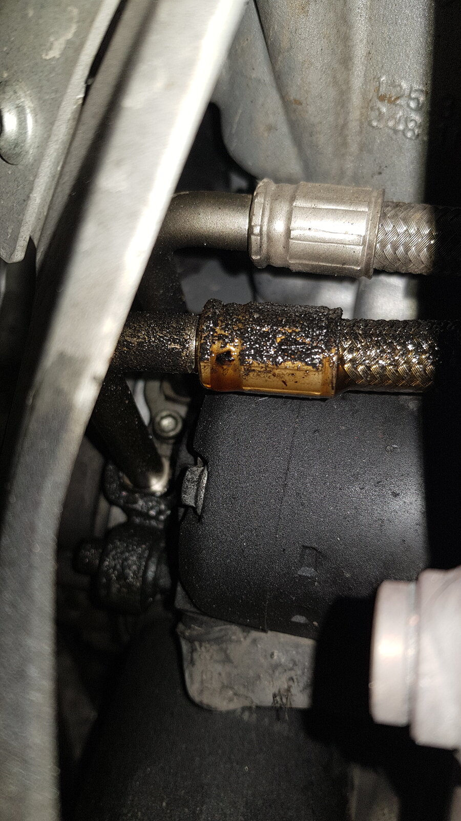

  11. Well i had 4200kms on mine, when i saw almoust zero oil. As i had service at 5000 i told dealr that my mts consuming so much oil. They said they will check... they did service and nothig was found. Anwser was, that new engines use oil as are they new.
    Well 2 days after my ride, my MTS stayed in garage as i noticed oil leak under bike... oil hose from radiator was leaking. 7000kms on mts.
  12. @mladench that looks like quite a bit of oil.
    It looks like its the hose itself to me, and not the O-ring on the pipe fitting at the engine end.
    what was the cause, poorly crimped hose, pipe worn through further up ?
  13. dont waste it; annual service Saturday and apparently ducati dealers have to use Shell oil now; £64 just for the kin oil :(
  14. Looks similar issue to my 1260, annual service due in a few weeks, will get it sorted then,
  15. Well problem was hose by itself. It was leaking. New hose :rolleyes: they changed to new one with clamps and inserts.
  16. under warranty ?
    manufacturing defect ?
  17. I guess manufacturing deffect. It was changed and fixed under warranty.
