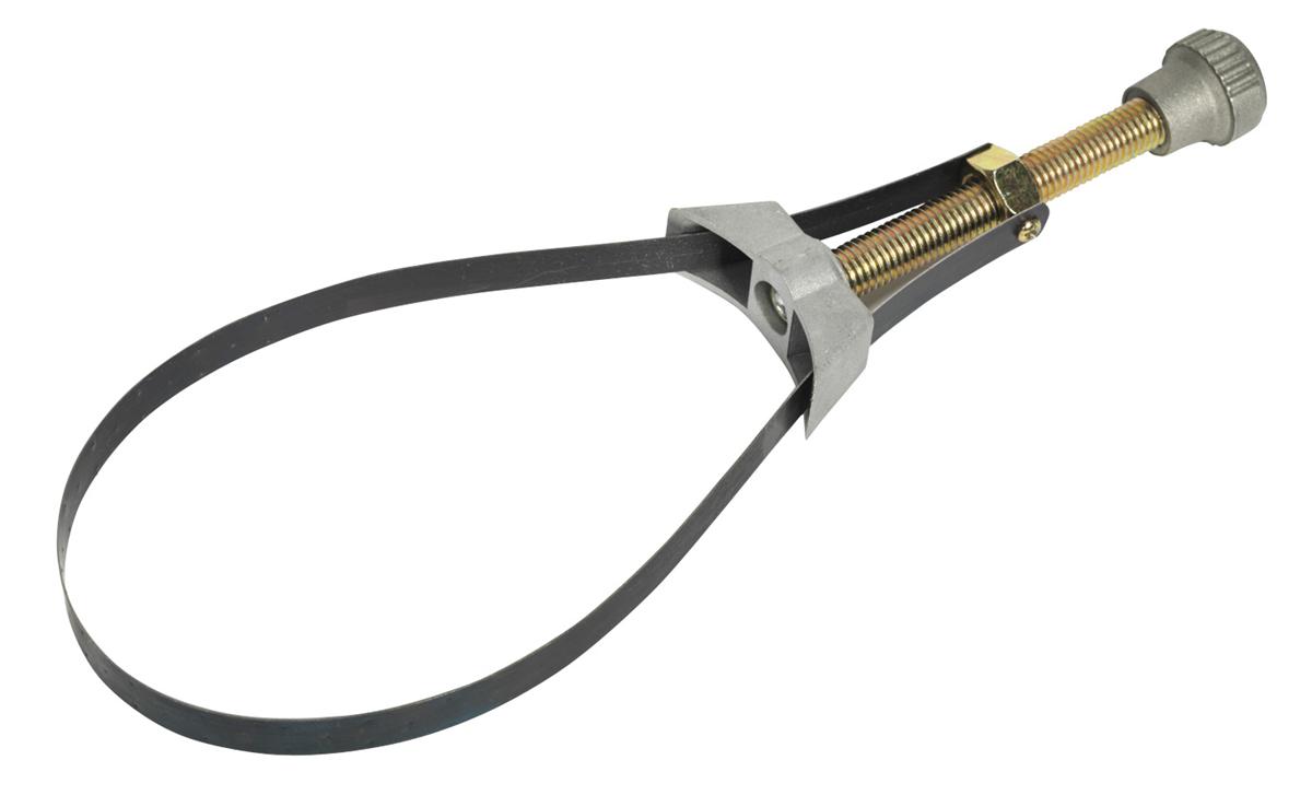

Hi, can anyone recommend a quality oil filter wrench( socket) to tighten as well as removing the filter. I have owned and self serviced my 748 from new. But have only just started using the later design of filter , I can't get enough purchase on the filter by hand,like I could on the old deeper design. The result is oil is leaking from the filter.This has happened to the last two oil/ filter changes. Any recommendations would be appreciated . Cheers Dogrose
I preferred this type I then switched to K&N filters that have a nut on the base and use a small torque wrench when fitting.
