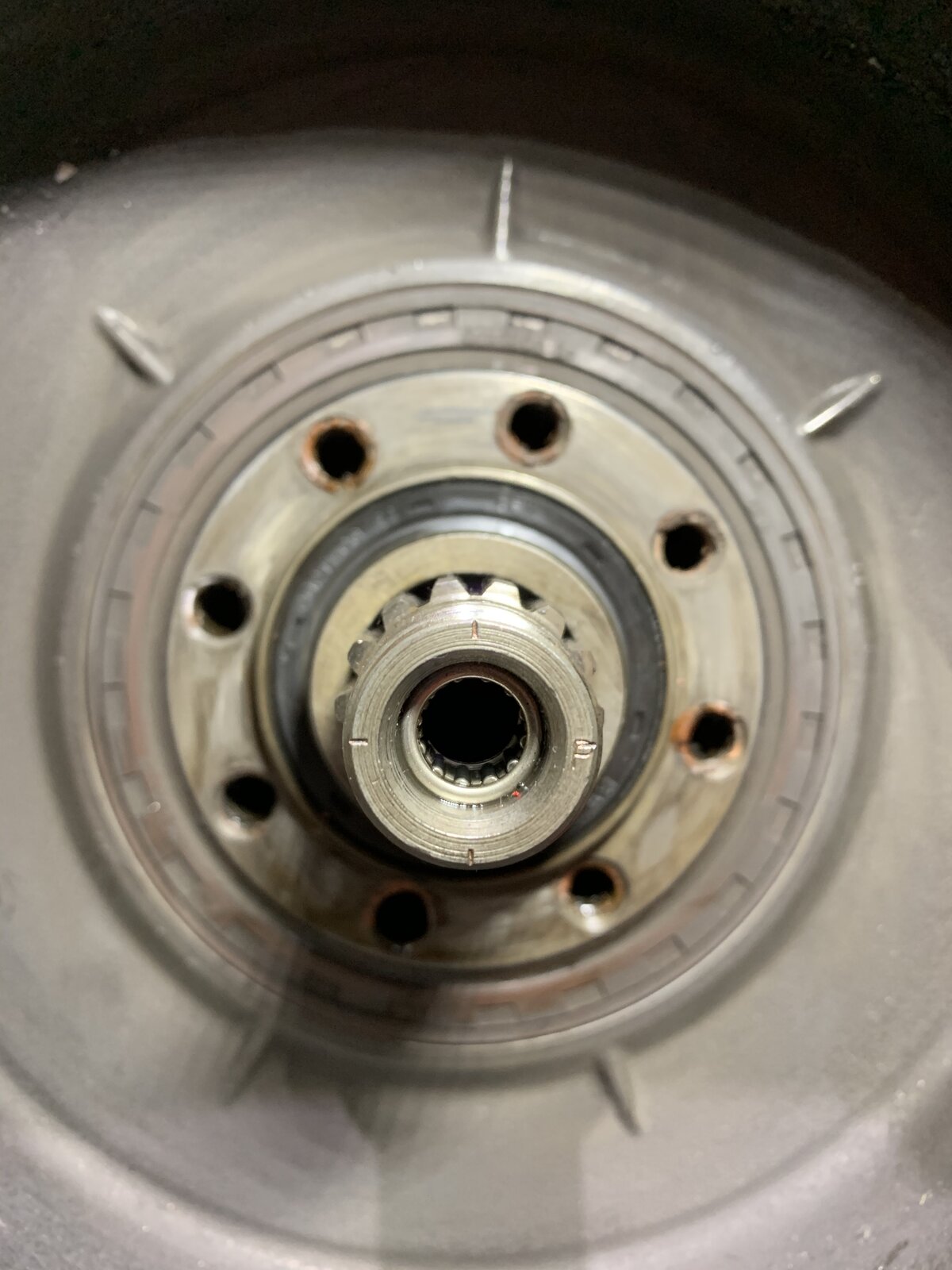

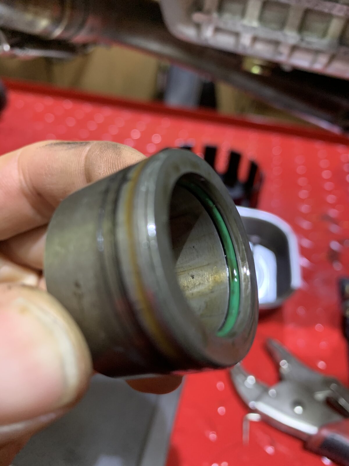

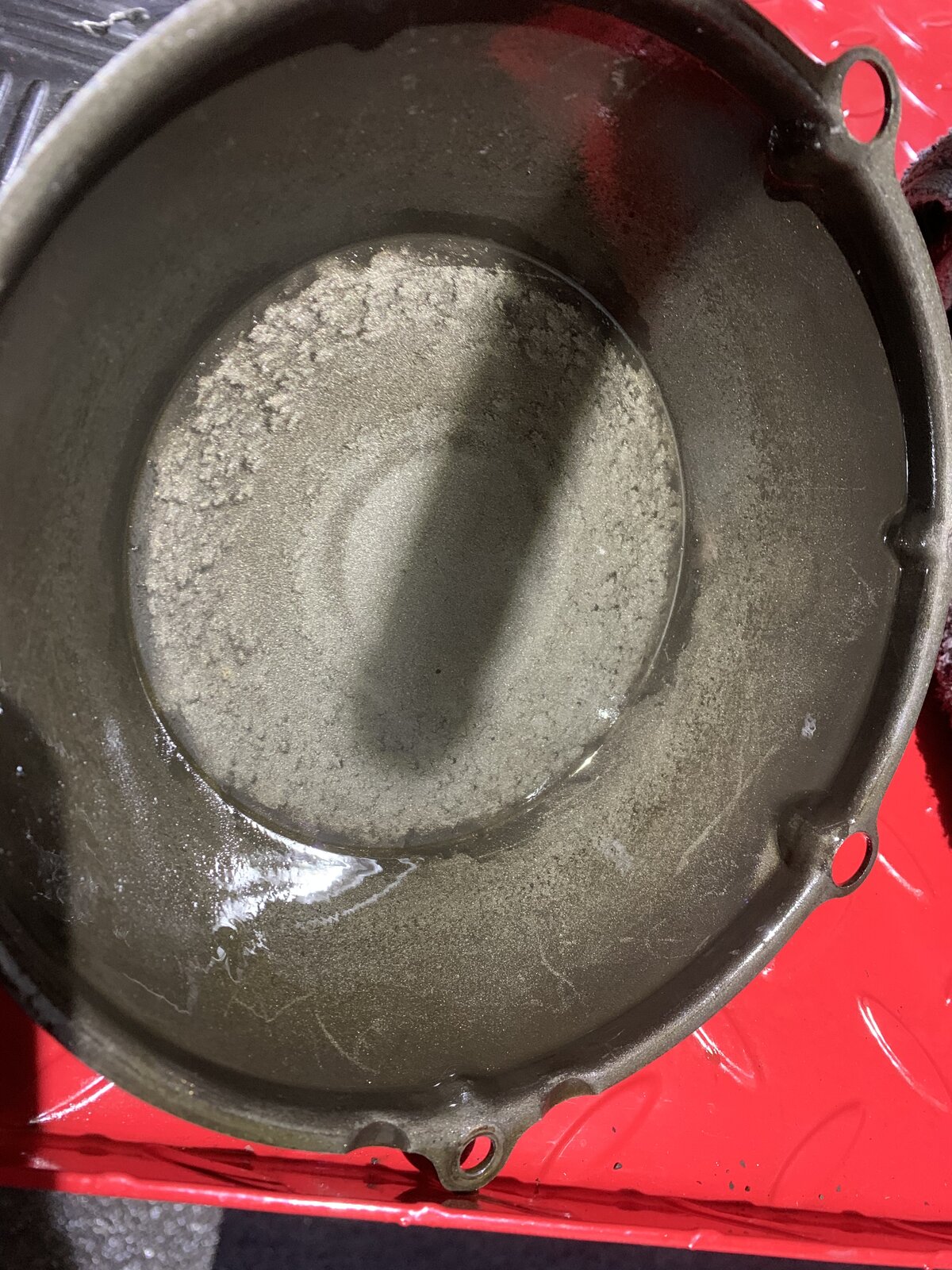

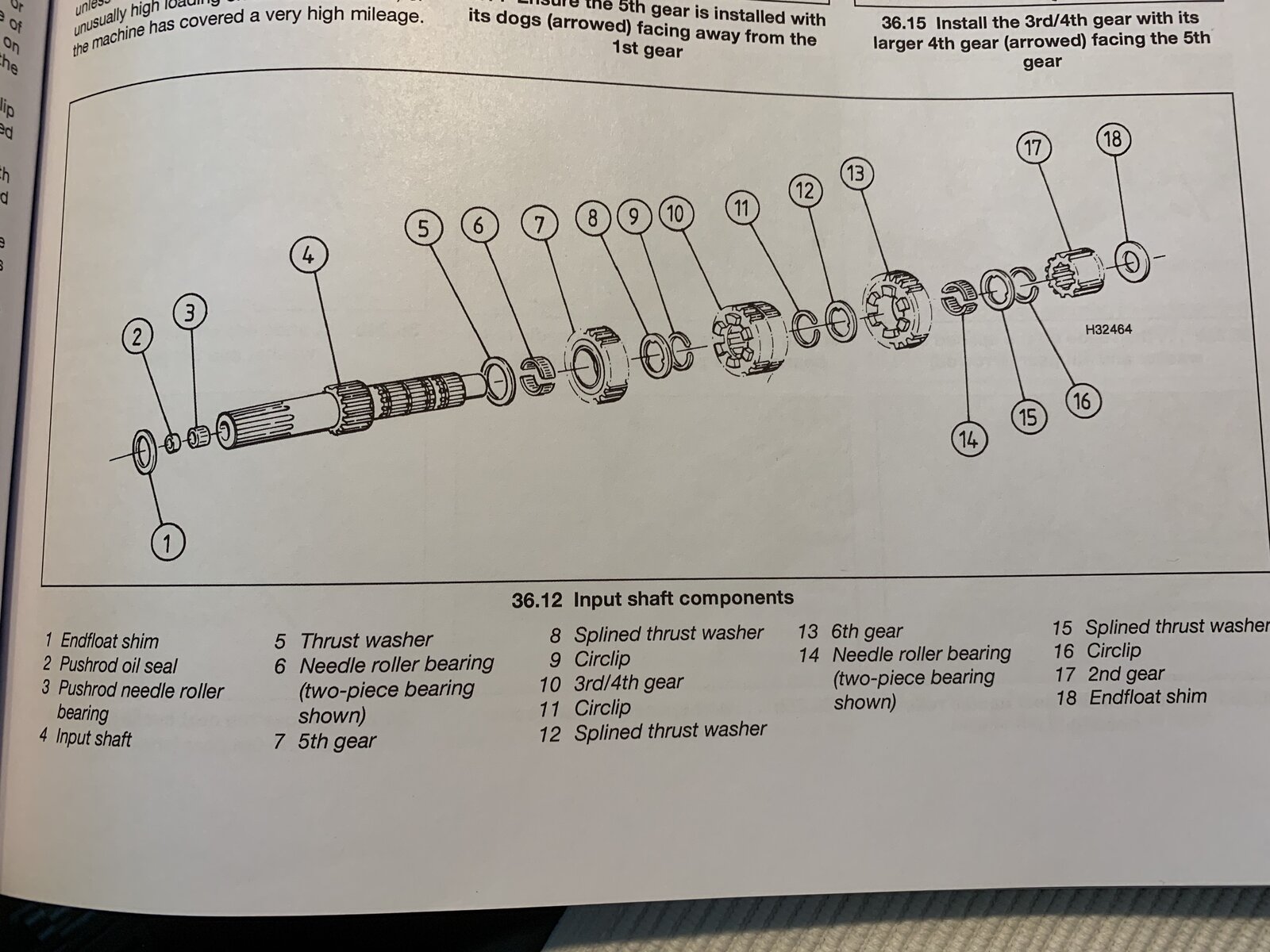

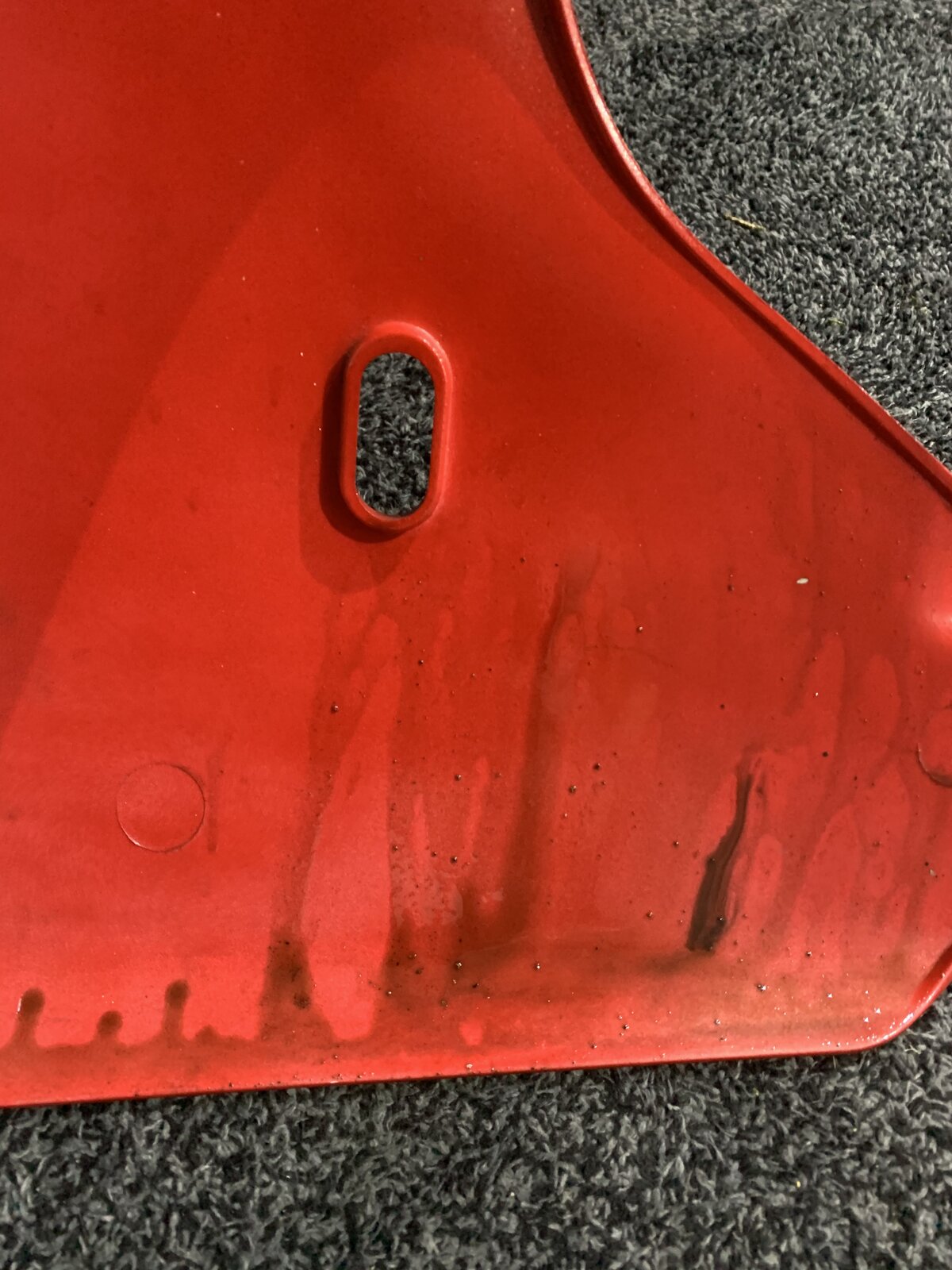

  1. Hi Guy’s,
    Got a massive leak dripping out of the clutch cover.
    What I have done so far :
    Changed the 2 pushrod O rings.
    Changed the pushrod oil seal (2) on the input shaft (4)
    Now that I am writing this, I discover that the endfloat (1)shim is missing ....
    Could that be the reason ?
    What is the inside/outside of the pushrod oil seal ? (2)
    Appreciating some advise :)

  2. Your the second person this week with this issue, i personally haven't had this happen to me but i think if you had put it under technical help you might get a better response.:upyeah::upyeah:
  3. Sam, there are a couple of rings in-board of the clutch pressure plate top hat, and another the other side of the basket, is the big 95mm clutch housing seal ok? The push rod o rings can be easily damaged due to burrs on the crankcase on the slave side cutting them but that should not show as a big leak in the clutch housing. Is the push rod clean and smooth and the needle bearing inboard that seal ok. Is that the end float shim on the splined part of the shaft ( there are 5 different sizes available)? Looks like you are due a new basket soon
    Download the parts book and factory manual for more info

  4. not saying for certain, but a fair chance it's seal behind basket.
  5. +1 for Chris’ suggestion, all that oil on the clutch side fairing that’s not down to a failure on the push rod o rings IMO. But don’t fret it’s easy enough to replace if that is the issue, at least if I can do it anyone else ought be able too.
  6. nearly always is "the big one" and easier to remove than "the little one".

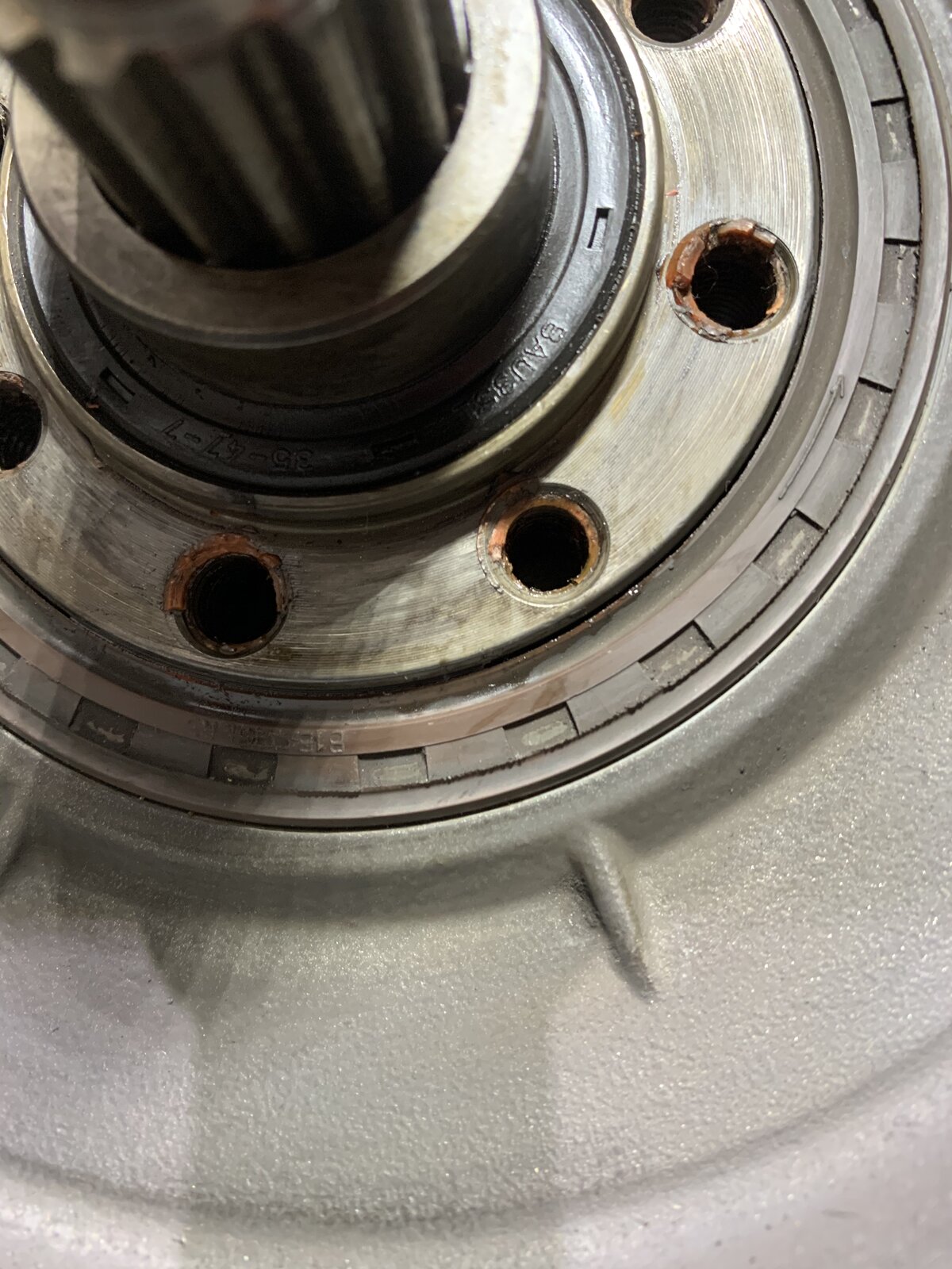

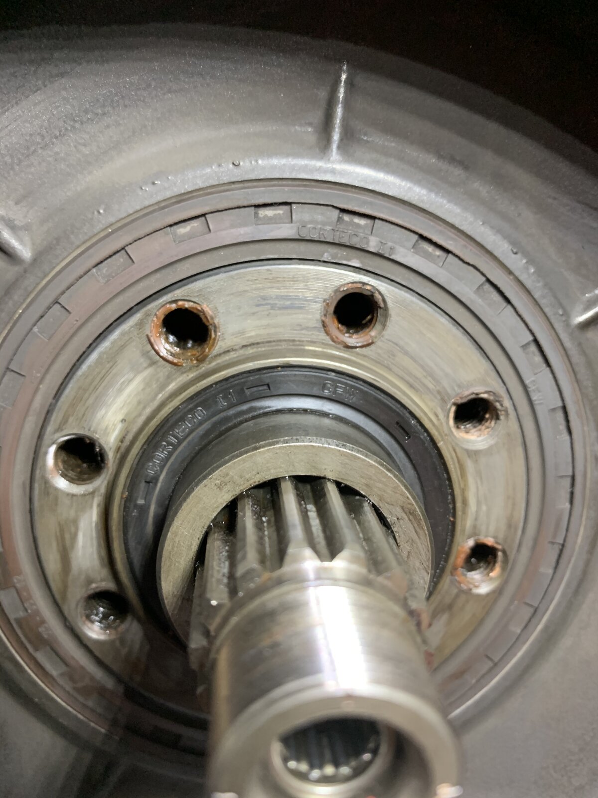

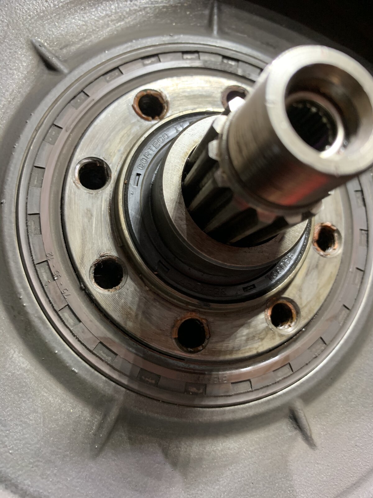

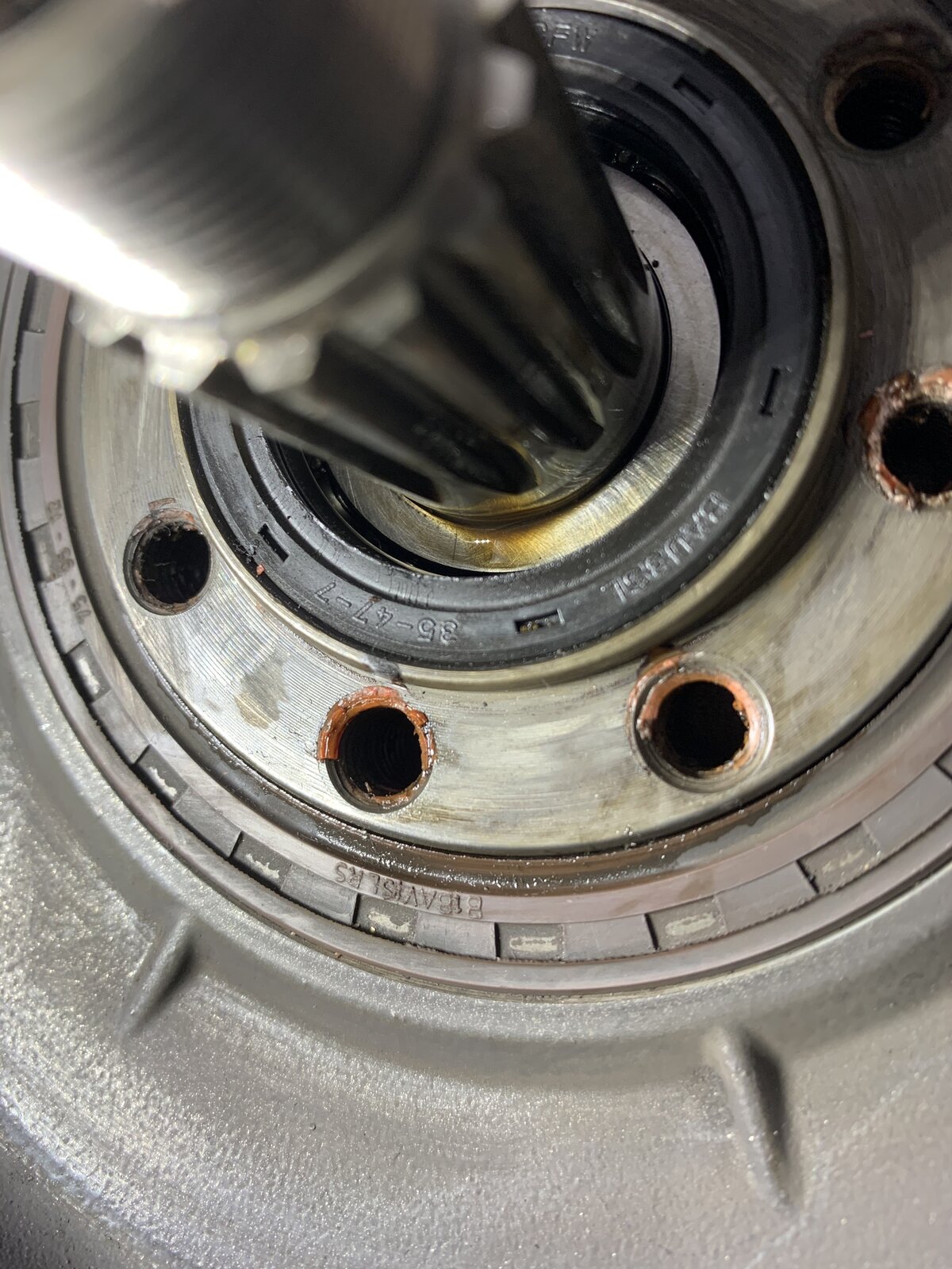

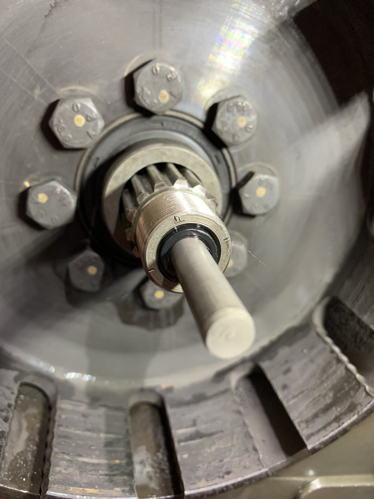

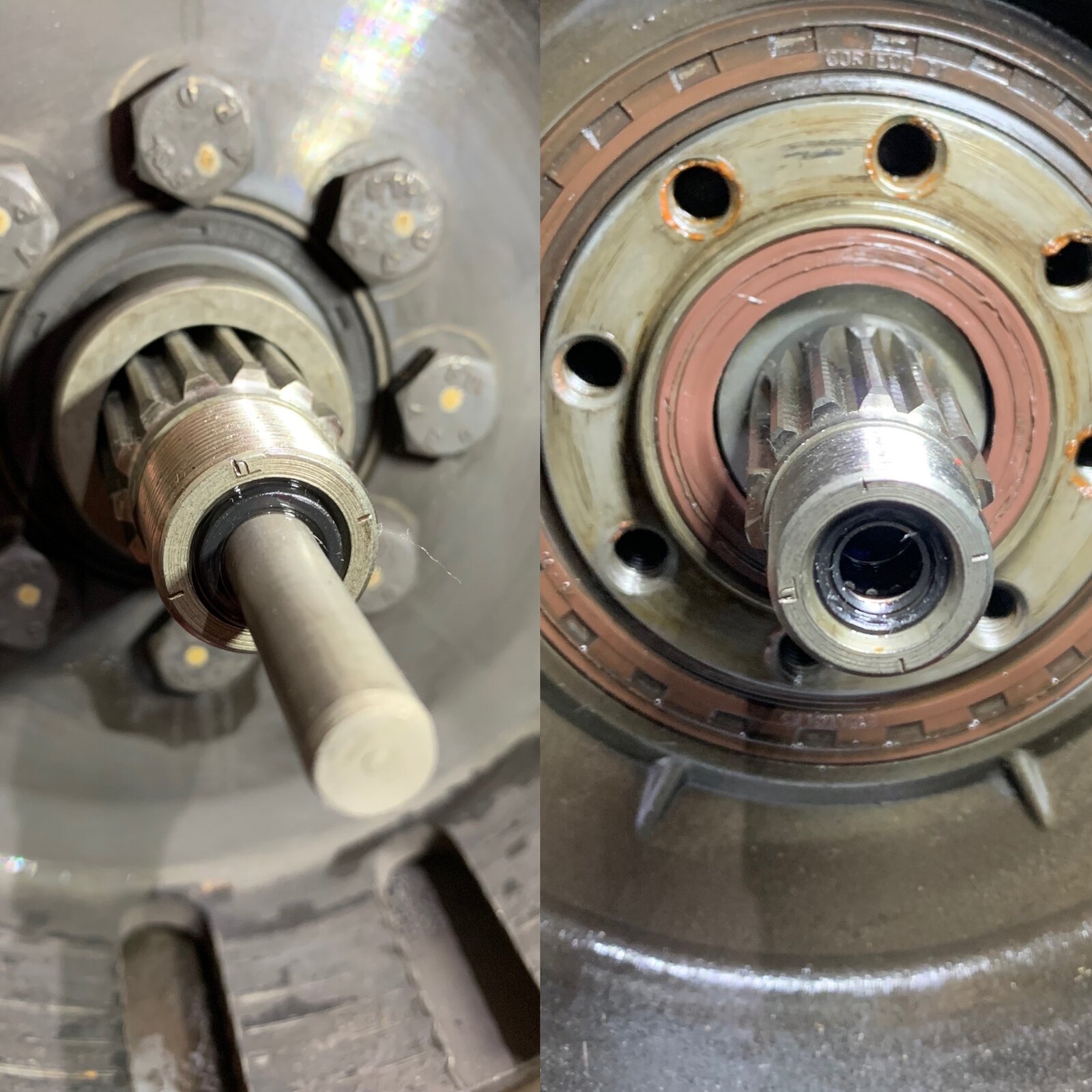

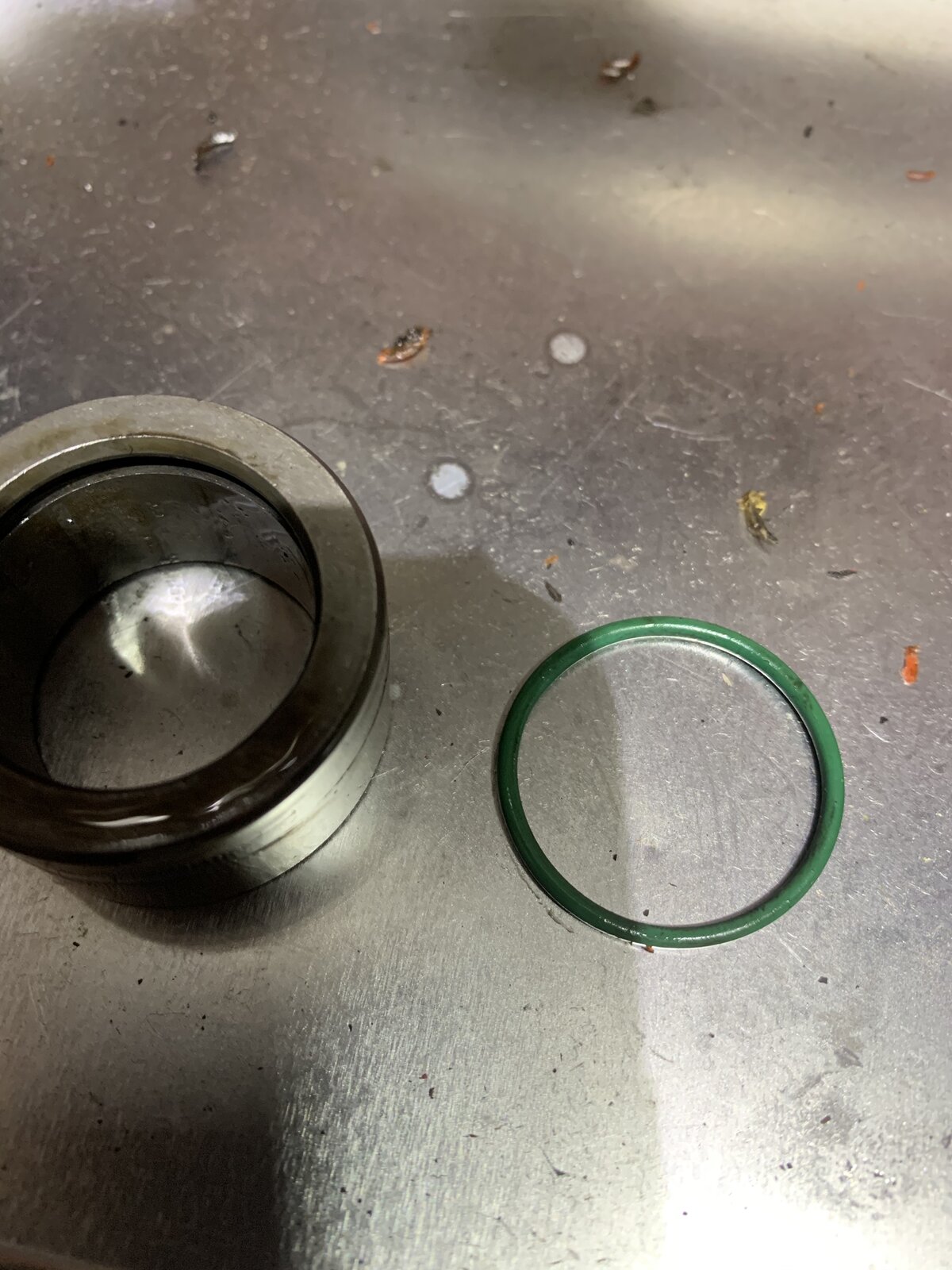

  9. Thx for the advice. Just did that. There is some oil stack.
    I can replace the o ring. No visual damage, but time can reduce the functionalities.
    Can you see something strange on the pictures ? Thx 45AB2A72-3896-4310-80C1-F1C327613459.jpeg 3D8AACC4-8633-478A-9EE5-D11B32D02F5B.jpeg 0C3A5F5D-F003-4ABD-8C39-7E1AF0082208.jpeg 3B54129B-23CA-497E-829B-6F44DAA0D7CC.jpeg
  10. The type of oil lip seal that runs on the spacer can can cut in to the surface, the lips can also wear/harden.
    Clean the outer surface with some scotchbrite. The seals don't work well on polished/shiny surfaces.
    Oil can also track through the 8 clutch basket screws, if the thread lock has failed.

  12. Is the oil seal at the clutch end of the shaft (where the pushrod sticks out) fitted the right-way round? Because if it is fitted backwards then oil will pass by it.
    Don't ask how I know... :blush:
  13. I have the flat side out and the lip side inside. I think that’s the right way

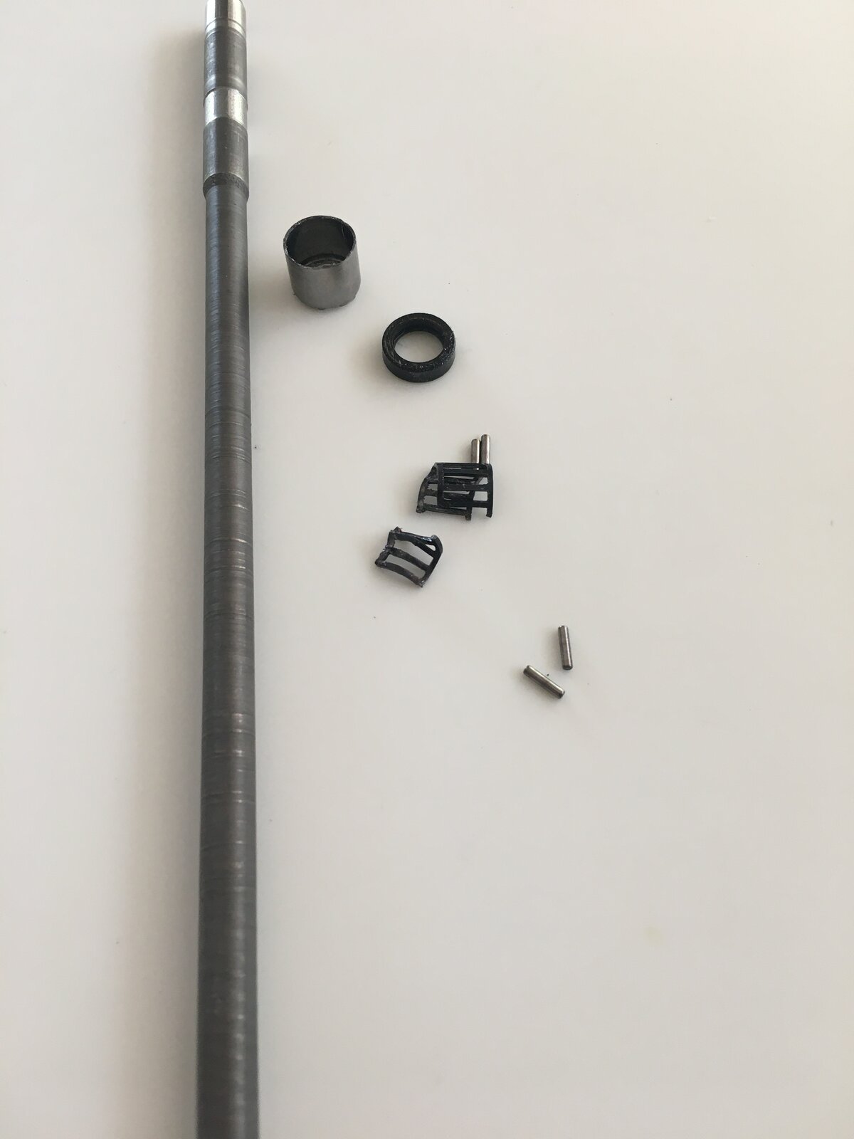

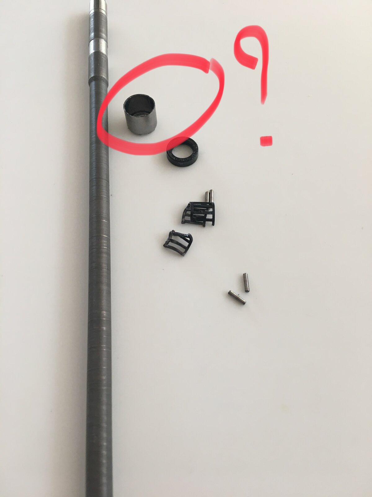

  14. Thx man. What’s this : 4F85026F-7DE8-4E31-A03E-E24436E0AEE4.jpeg
  15. Sounds good.
    I think my eyesight was playing up when I changed mine... :bucktooth:
  16. That looks like the outer cage or bush the needle roller would be housed in.
    Steve
  17. That pile of broken bits came out of that bush.
  18. 531E20A8-CC17-4F37-91DF-9B8BFC73983F.jpeg Update : oil leak problem is solved.
    To make a long story short : the push rod oil seal was not seated like it should in the input shaft.
    You need to ‘hamer’ it in with a ‘cilinder shaped ‘ driver. (Flat side of the seal is out).
    Anyway, I overhauled all the oil seals, rings and some other parts. Learned a lot ! Thx for the Advice.
