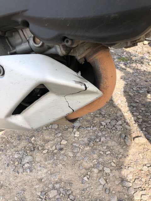

  1. IMG_1263.jpg Hi
    Any idea if this would be from an obvious/common place? I will have a look once I get home but thought you clever people might say "thats your...."
    Thanks
  2. Had this or what looks the same when my bike was new After 160 mile run there was oil there. Took it back to dealers where it spent nearly a month. It was a camshaft sprocket oil seal leak on one of the heads. The oil was running down the casting for the belt covers & onto the sumpguard at the front. Is this the only time it has happened as it could be a splodge from something on the road, chucked up by the tyre. Mine is 2017 1200s.
  3. Thanks for reply
    First time, doesnt seem to be changing, just rode it home 30 mins and my finger smudge up top hasnt changed so ill keep my fingers crossed, will try amd see if I can
    Cheers
  4. I think it's just a bit of something off the road. Like you say clean it off & keep an eye on it. Mine was much worse than that.
  5. worst it could be is a camshaft oil seal or cam cover gasket. When I see you next time I will inspect or you.:upyeah:
  6. Thankyou good plan :)
  7. Ohhh so im gonna come find you now hehe, thanks
  8. Thats road tar.....WD40 will take it right off, hehe.
  9. Thanks I think you are correct, not seen a sign of it since and they are resurfacing outside work
    Thanks
