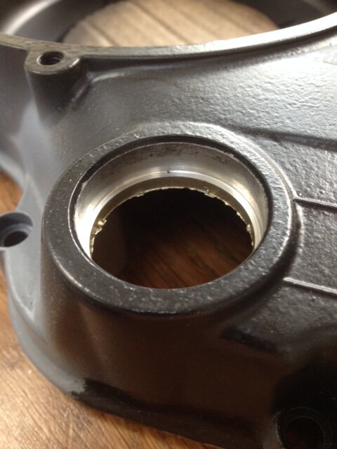

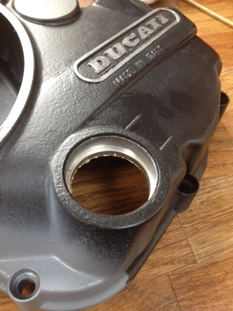

  8. Finally got round to removing the oil window, can't rush these things eh.
    This is what it looks like.
    I've still got some refurb work on the housing to finish first, before fitting the new window.
