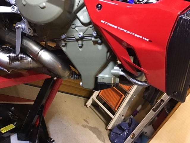

  8. I hope @iang27 does not mind me hijacking his thread, but wanted to offer some feedback on the vulnerability of the sump on the SFV4, and possibly all deep sump engine bikes, that do not have full belly pan protection. Also to offer some feedback on this great solution offered by Desmoworld.
    I was not aware of this potential issue until Ian started this thread nearly 2 weeks ago and after a quick inspection of my bike, it was obvious something needed to be done.

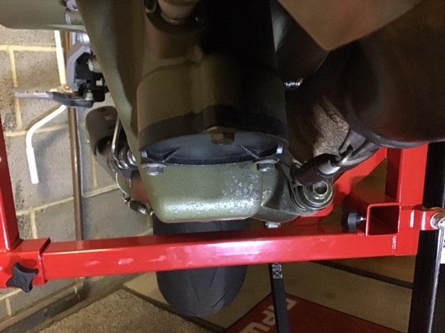

    In brief, I have had my SFV4 since July 2020, done just under 2,500 miles (bl**dy lockdown's!) and never been ridden in heavy rain, frost or if the roads have been recently gritted. I took a quick look underneath and this is what I found......
    The sump is slightly off-center and the main area of damage/pitting is directly in line with the front wheel.

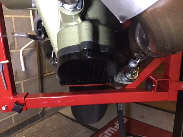

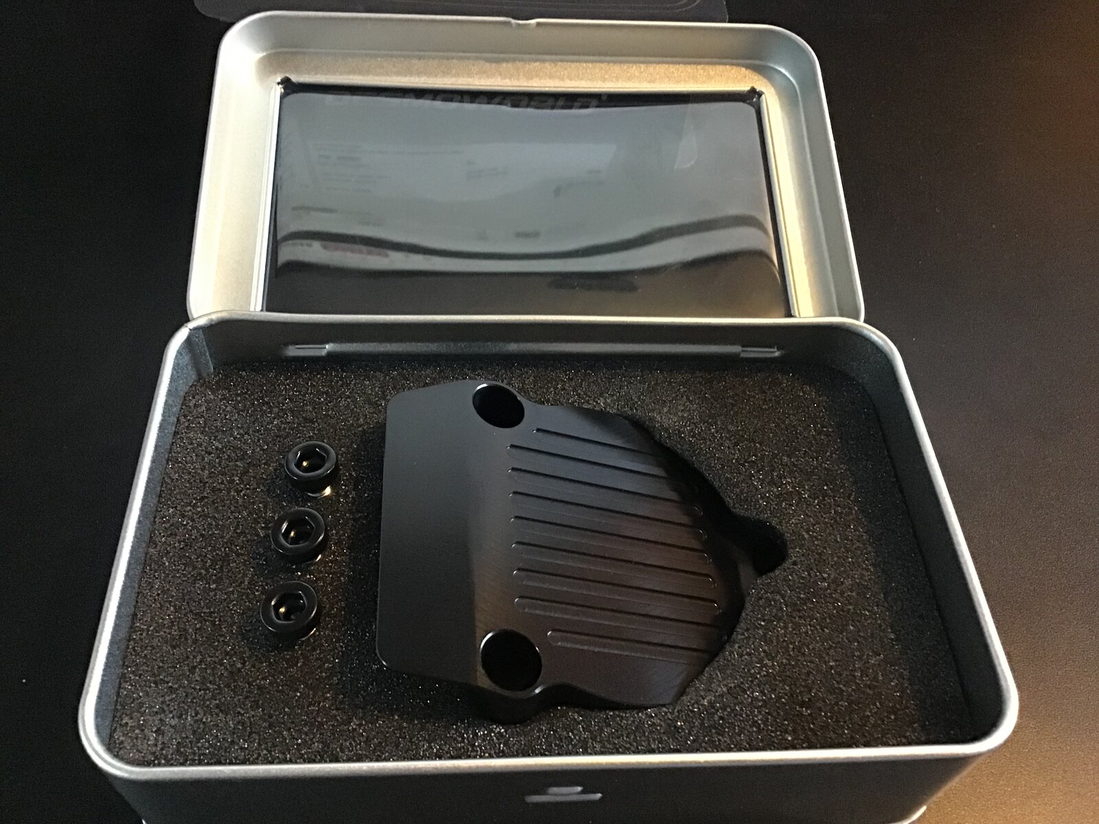

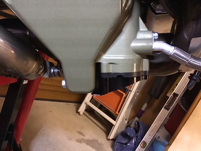

    I ordered the sump protector guard from Desmoworld and it arrived 6 days later.
    Fitted it this weekend, applied a liberal coating of ACF-50 to the whole sump area and now the sump is much better protected.
    The only thing I can say about the installation, which is very straight forward, is that the supplied cap head screws, which are 5mm Allen drive, are a tight fit on the driver. It may be the black coating was a little too liberally applied, but I had to wiggle the drive bit in and out a bit to free them up before fitting to the bike. This may be a one-off issue, but worth checking before applying threadlock and then having to mess about trying to get the driver to fit.
    All in all, I am very happy with this quick and easy solution to what could be a major issue if left unchecked.
