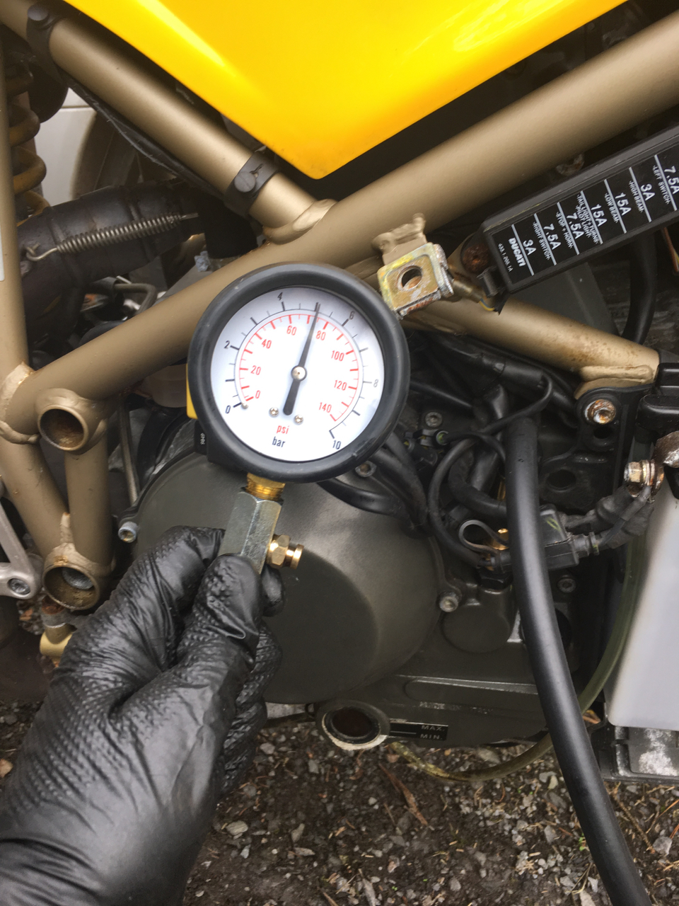

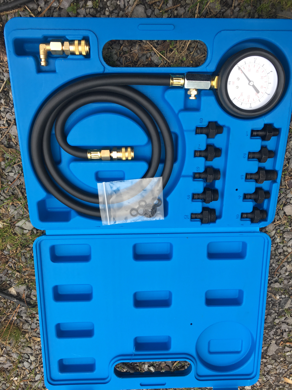

  10. OK, got one for £40 inc postage. Checked the oil pressure and now I know it's definitely a dodgy switch.
    5 bar at tick over and 5.5 at 4-5k revs with a cold engine.
    However, I double checked the workshop manual and there was supposed to be a crush washer between the switch and the crankcase. None present on mine. Couldn't get a crush washer locally so used a standard washer and a fibre washer. This lifts the switch about 2mm further out and bingo, now no oil warning light after starting the engine. :)

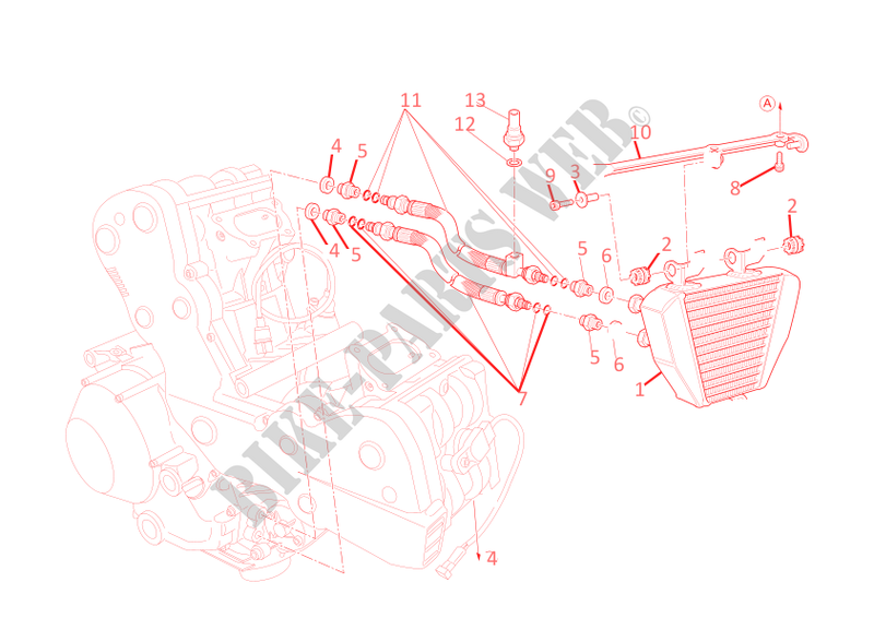

  11. @PaulPhillips, an old thread I know but just came across this. The switch will fail sometime again in the future unfortunately.
    It’s the vibes from the engine that kill them and that’s why Ducati moved the location of the sensor switch from the clutch cover to the oil cooler lines on later models.
    Just messing about with my sensor and going through all the threads... :)
