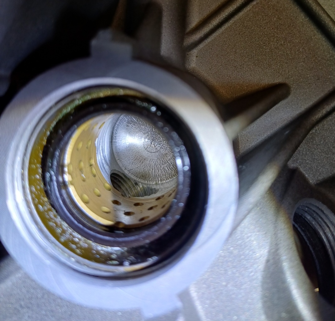

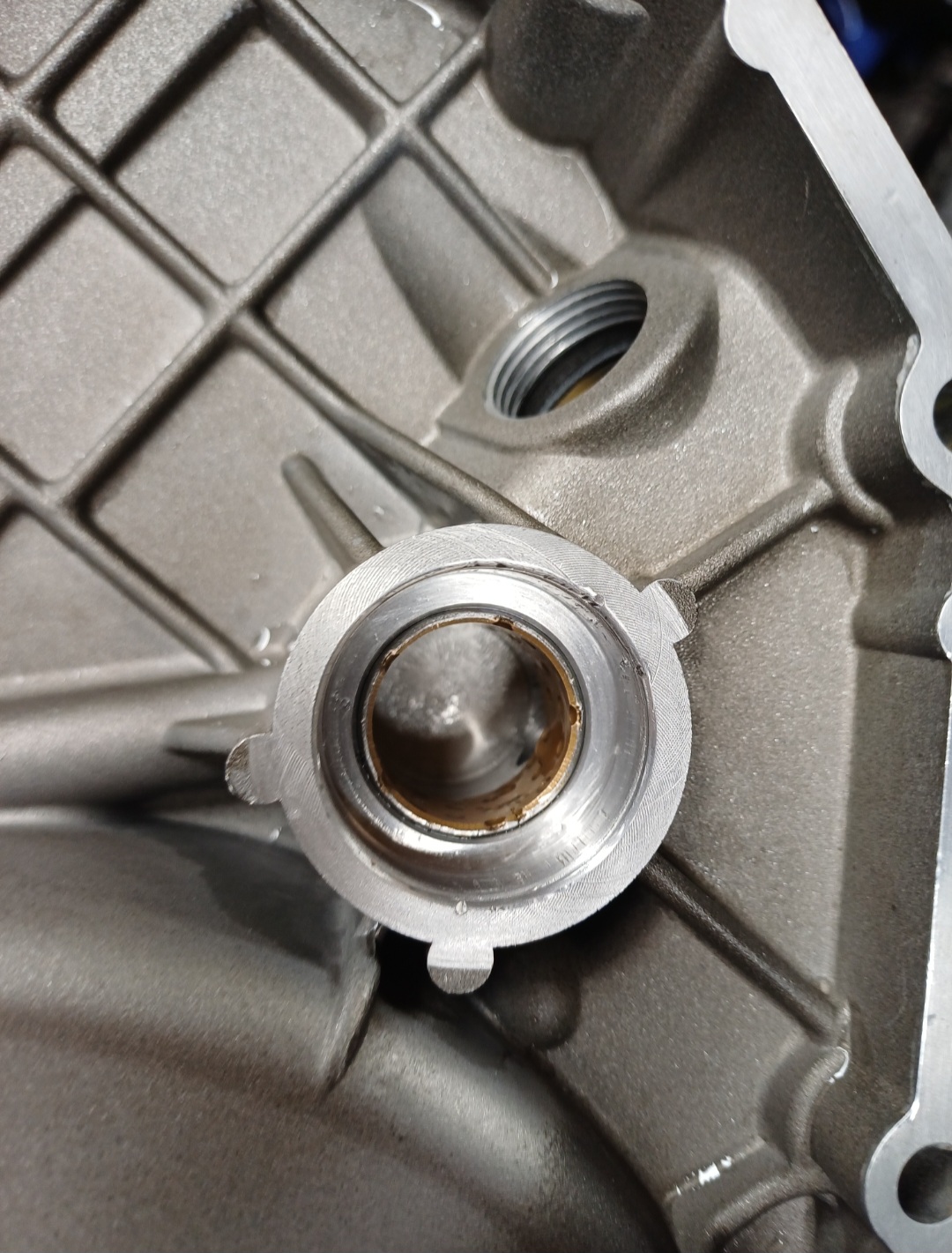

  1. After re threading the oil sensor area, I have now vapour blasted the casing and noticed some of the media is still in side the chamber, so ideally I need to remove parts 8,9,10 and 11.
    10 and 11 have been removed, but struggling to remove 8 and 9.
    Has anyone attempted this and if so, please could you share any tips?
    Cheers jamie
  2. I take it the casing is off the bike? 8 and 9 look like sleeve bearings? Expansion /contraction method can help ,stick it in the freezer. If it's still on the bike this could be a problem.

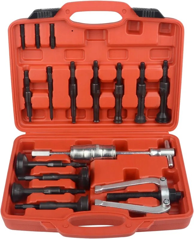

  3. Internal bearing puller and slide hammer.

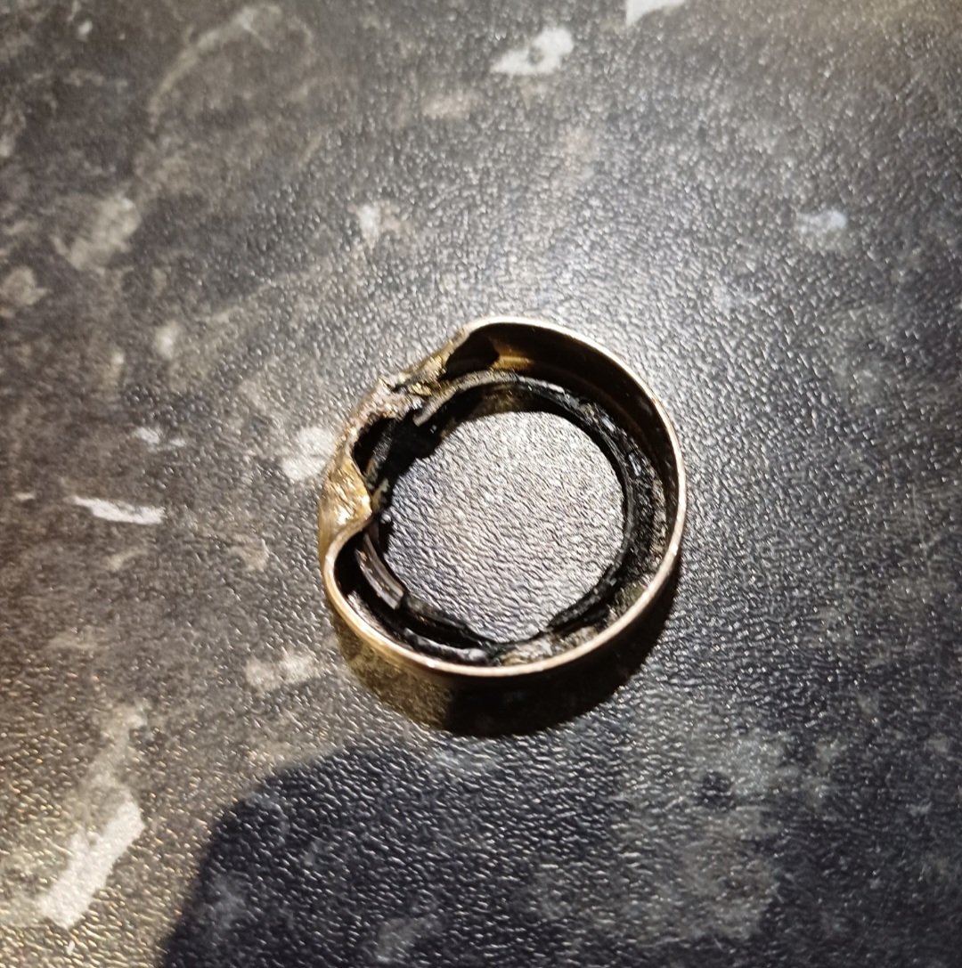

  4. 8 is a bushing, 9 is a seal. A blind bearing puller is probably going to be easiest. The seal isn't too difficult, the bushing can be... warm the cover
    Make a not of the seal fitting. It's not installed as you'd expect, but appears to be back to front

  6. Oil seal spring toward the bush?
  7. IIRC, the spring faces towards the crank, away from the bushing.
  8. Got me thinking, the pressure is on the bush side, so should push against the spring side?
