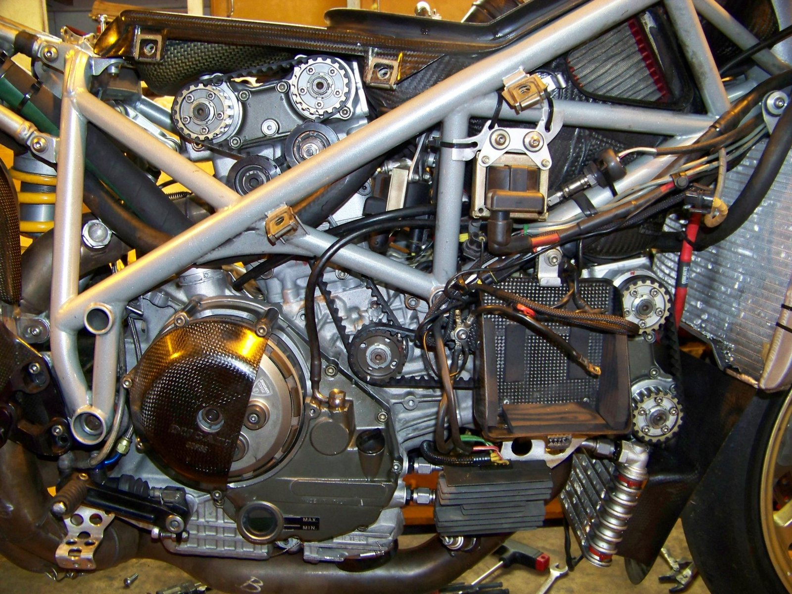

  1. After not connecting half of the electrics (lights and speedo only) the oil pressure switch is redundant. So I decided to replace it with this:

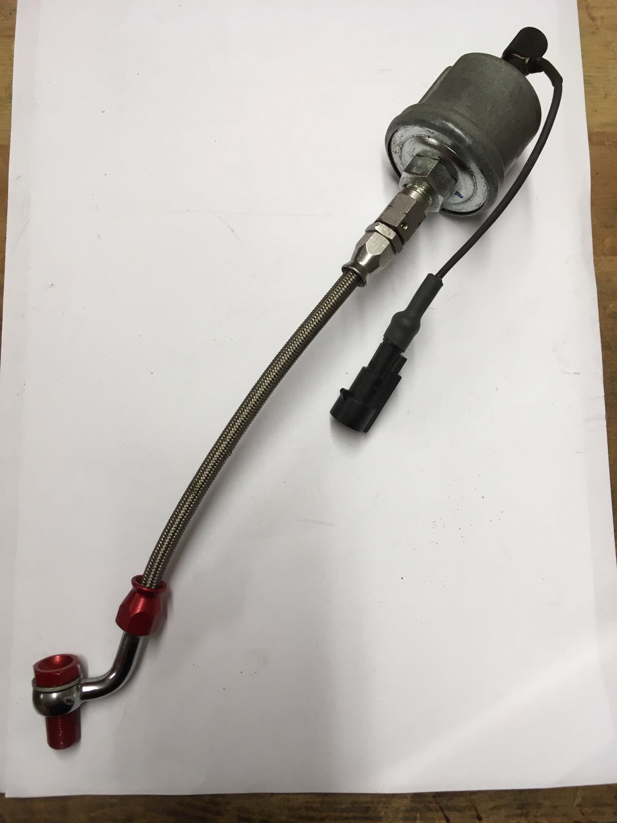

  13. Sorry for bringing this old thread back to life...
    Could I just unplug the oil pressure switch and fit an oil pressure sensor in its place?
    Any need to short out the 2 wires in the plug?
    Cheers, ian
  14. Unplug, fit, re-plug. No dramas and no special steps required.
  15. Cheers pal! :upyeah:
    This is what I'm wanting to fit...
