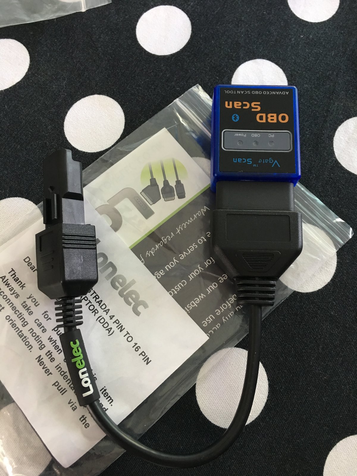

  17. So this is the cables that arrived at my door from UK, saying it’s specific for Ducati, In other posts some guys were saying the cables had to be colour coded as they were wrongly connected to the plug, does anyone know if these need to be checked or changed before plugging it into the bikes service plug? Don’t won’t to cook the ECU
    Thanks
