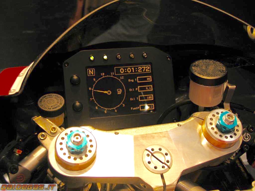

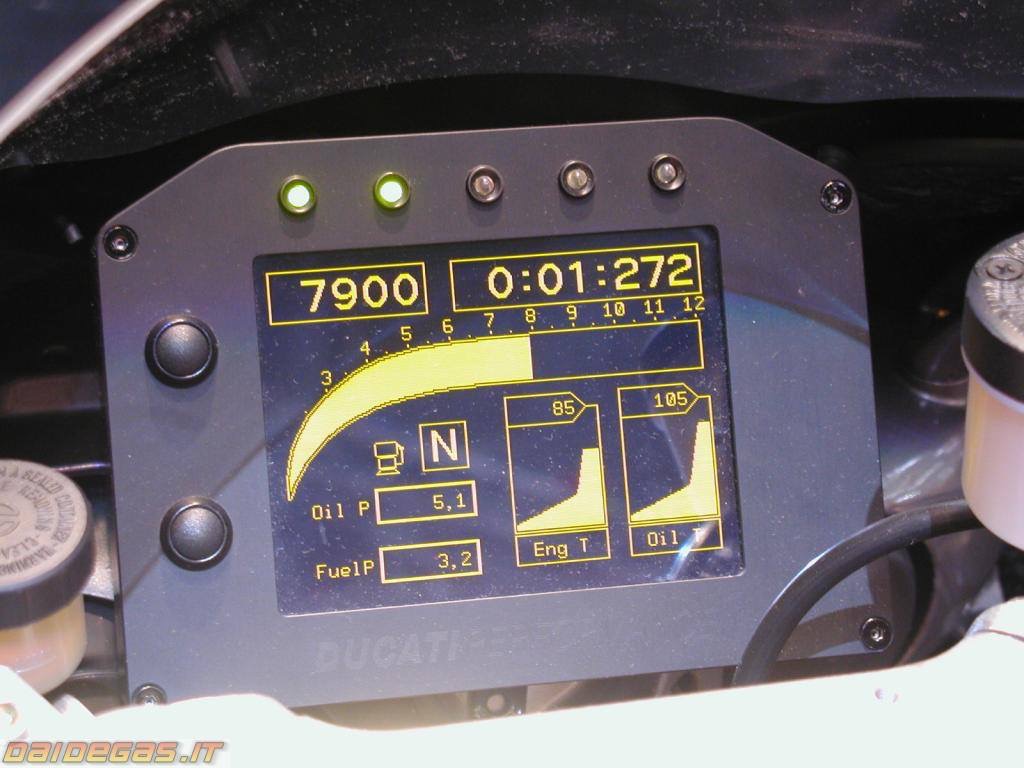

    Recently fitted a digital dash to the bike. It shows:
    Fuel pressure (sensor sorted)
    Oil pressure (sensor sorted)
    Water temp (uses original sensor)
    Oil temp. still have to sort out the best place and type of sensor for the oil temp job. I've read up on how some people use a std water temp sensor for this.

  2. Top job on the new dash, have you got any pics of it powered up, super keen to see the dash energised :upyeah:
  3. Hi Andy.
  4. Nice one Ian.... Thats awesome....Kudos :upyeah: Raised the bar yet again !

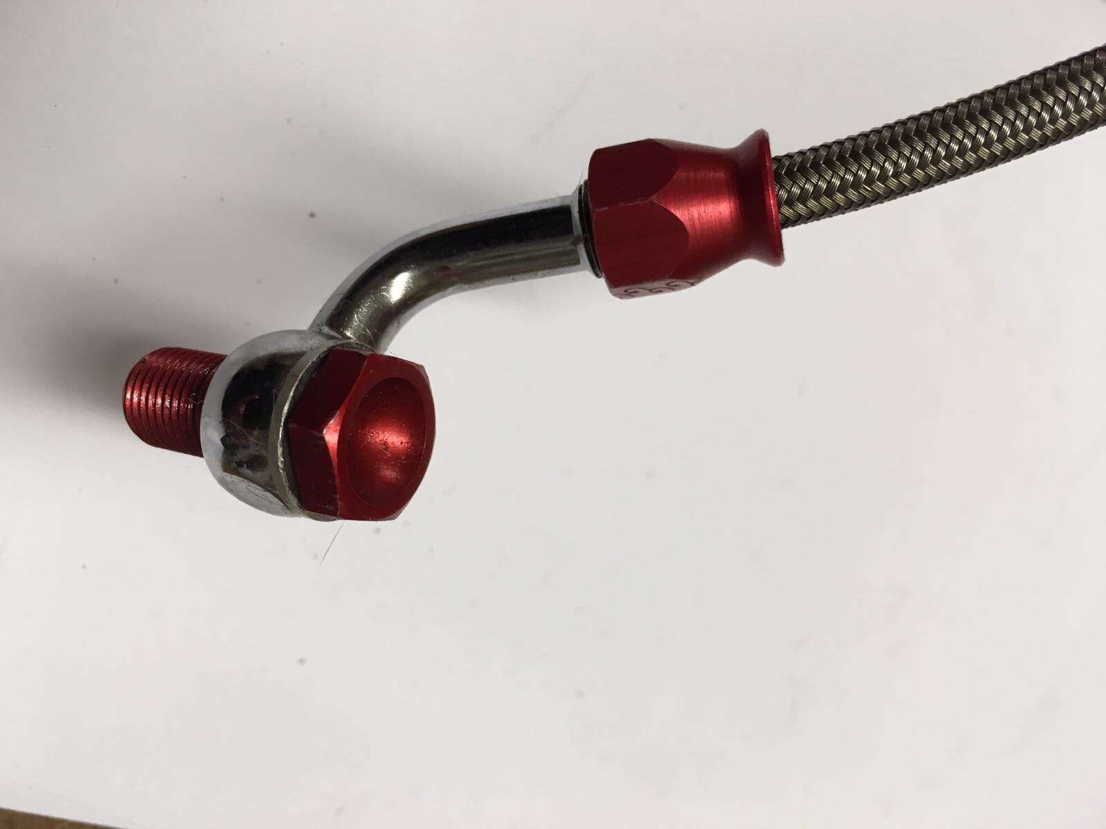

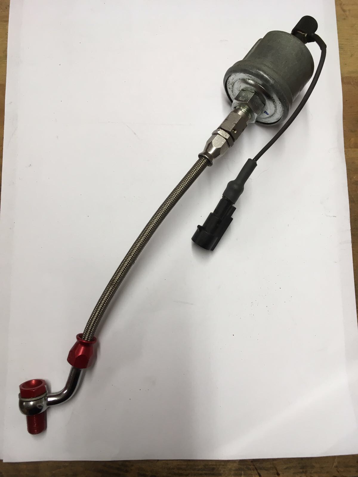

  5. Hi mate is your oil pressure switch in the oil cooler line??
  6. IMG_3610.JPG IMG_3612.JPG No. I think that's where the oil temp sensor will be going though. In a T piece.
    This is the oil pressure sensor. Goes right at the bottom on the clutch cover like the rs bikes.
