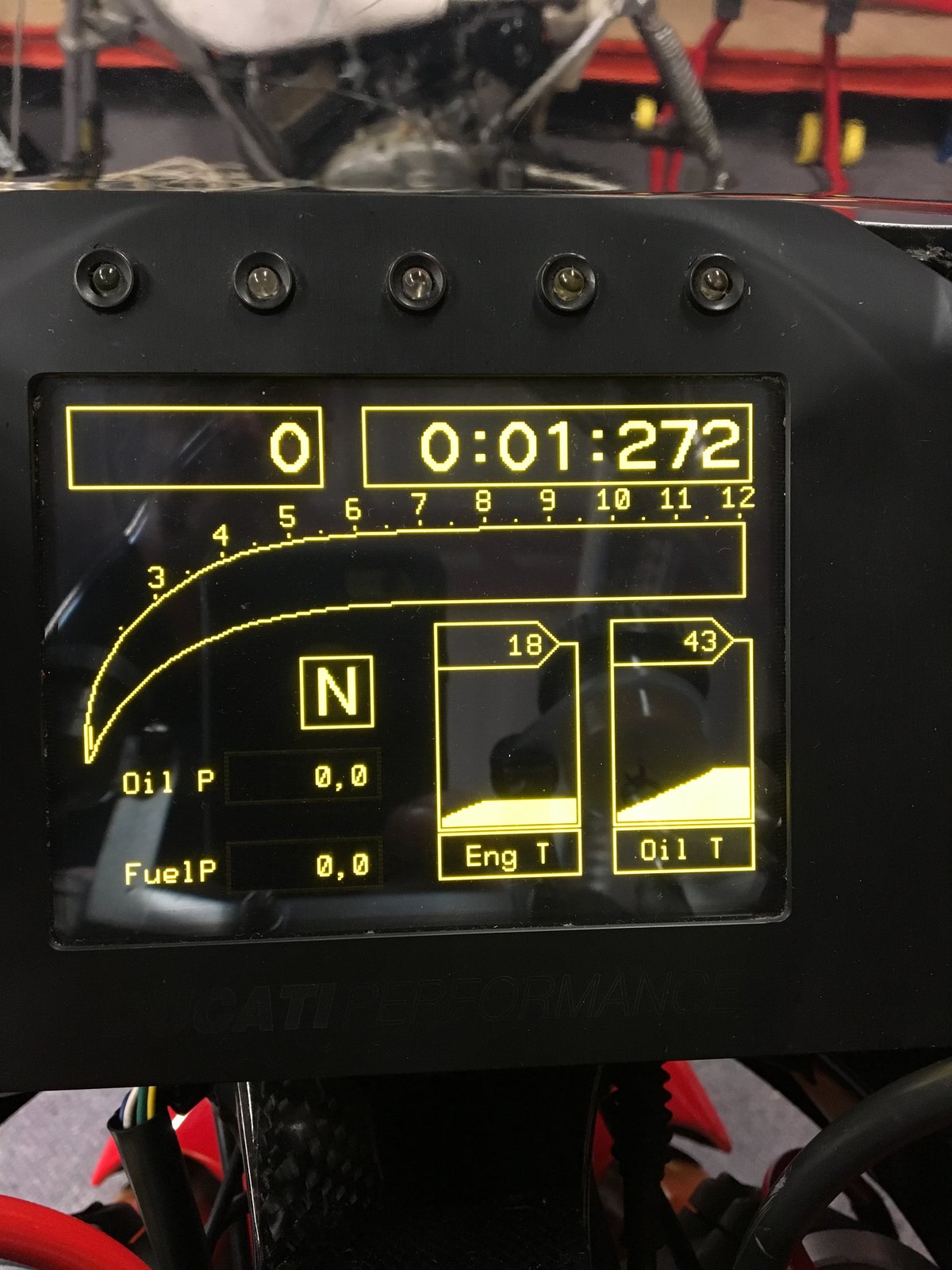

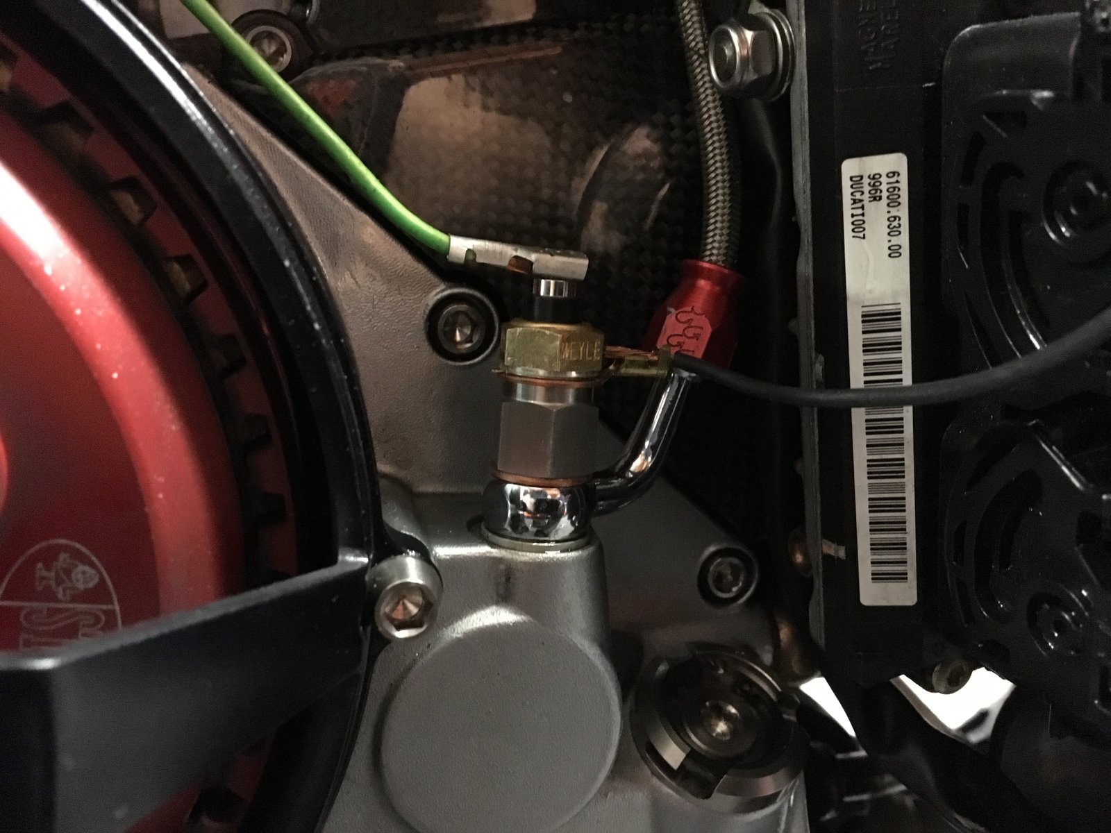

    The oil temperature sensor shows the following;
    Ambient temperature, engine not run, sensor fitted to bike, 43 degrees while the water temp shows 18.
    7301B232-EEBE-4D8A-965E-B1172F652B27.jpeg 69507C47-54FF-4964-BC33-0E94627A876D.jpeg

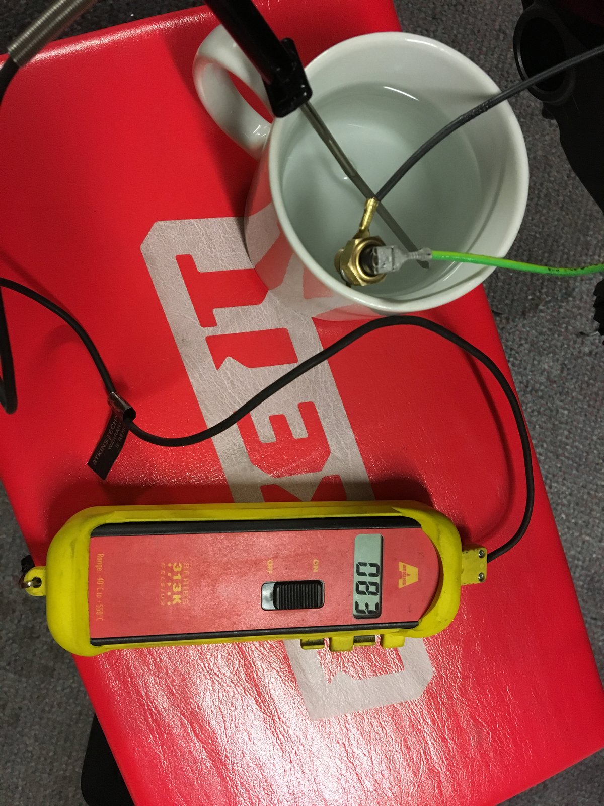

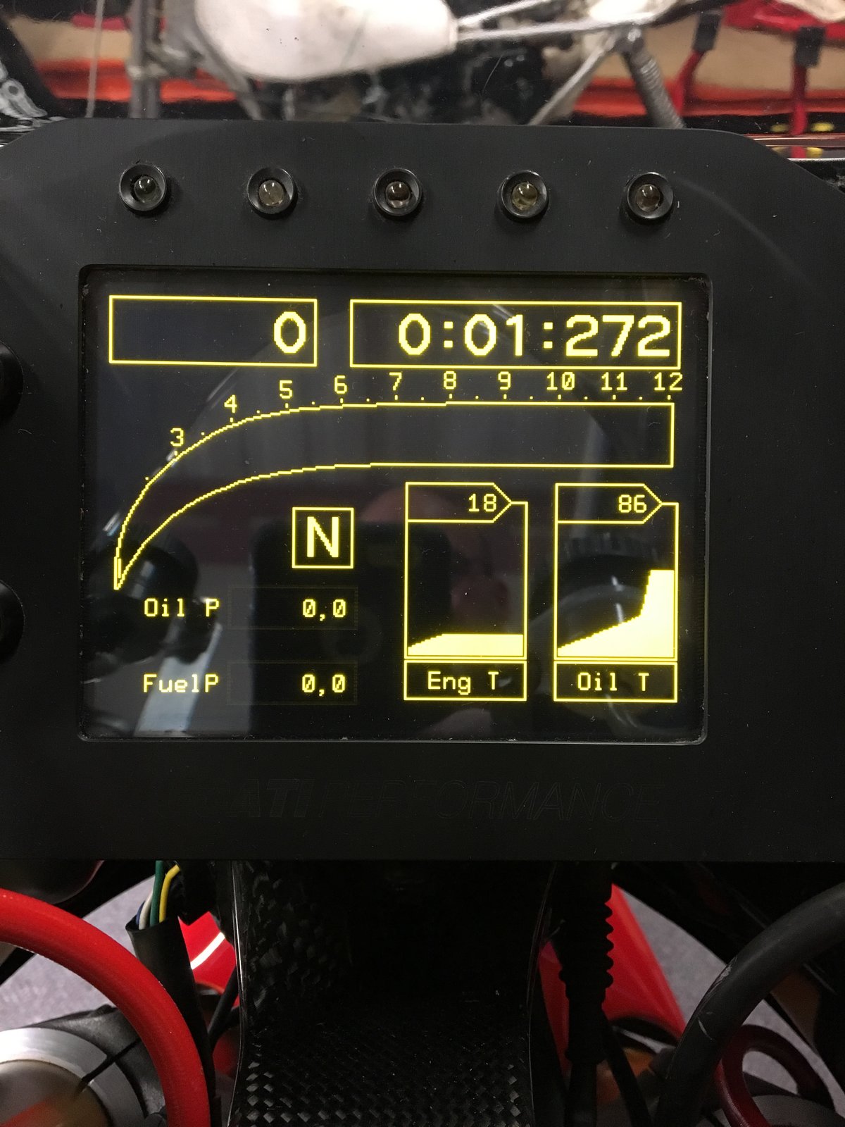

    But removing the sensor and placing in a cup of nearly boiling water and using an accurate thermo probe I got the following reading...
    1A90E40F-60E9-4A97-8E88-1B5C895BAF16.jpeg F48FC9A7-9F52-41A1-B368-4FC397118727.jpeg
    Been thinking that I might need a different sensor as it doesn’t read accurately lower down but accurate enough over 50 or 60 degrees all the way up. But after having had a scan on the web, seems like most analogue oil temp clocks start with a 50 degrees mark on the dial anyway.
    So, can anyone with a digital dash fitted to an older bike confirm what their oil temp number starts at?
    Not worried about it as it seams to work fine where it matters, higher up but just curious...

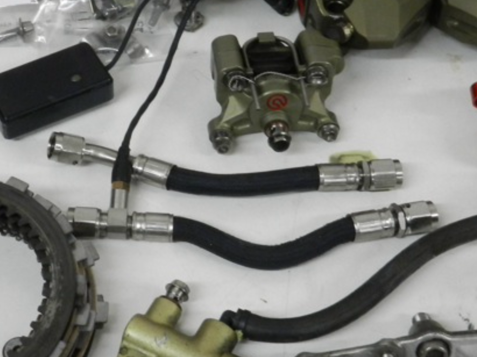

    Just to add, i’m Getting new oil cooler lines made up which will house the oil temp sensor and fitted to the oil cooler feed pipe.

  4. My RS dash reads the oil temp as ambient when the engine is cold. As an aside. I fitted the sensor into the oil suction, as I thought that there was little flow past the point where yours is located.
  5. Hi mate, thanks for that. I know where the sensor’s shown in the picture isn’t the best place. Works, but not the best. Sensor’s going to be fitted into the oil cooler feed pipe same as on the 998 RS bikes.
    @ducv2 where do you mean when you say oil suction bit?
    Cheers, ian
  6. I drilled and tapped the removable oil screen that screws into the bottom of the sump. Shows the temperature going to the pump and cooler, shows around 110C on a hot day at Almeria, with a water temp of 75C
  7. Right, got you. Lougi moto said the same but mine’s the deep sump S lump so couldn’t do it that way. Then moto rápido sent me the diagram with the way the RS is set up...
    Problem is, they wanted £750 for the oil cooler line and £250 for the sensor. Can’t afford that so knocked it together this way.
    My existing oil lines were in a poor state anyway so for £100 for the new lines and £5 for the sensor, job jobbed!
    Still curious why yours reads ambient temp when cold. Must be the way the dash is programmed.

  8. Bit like this but using the 998 lines

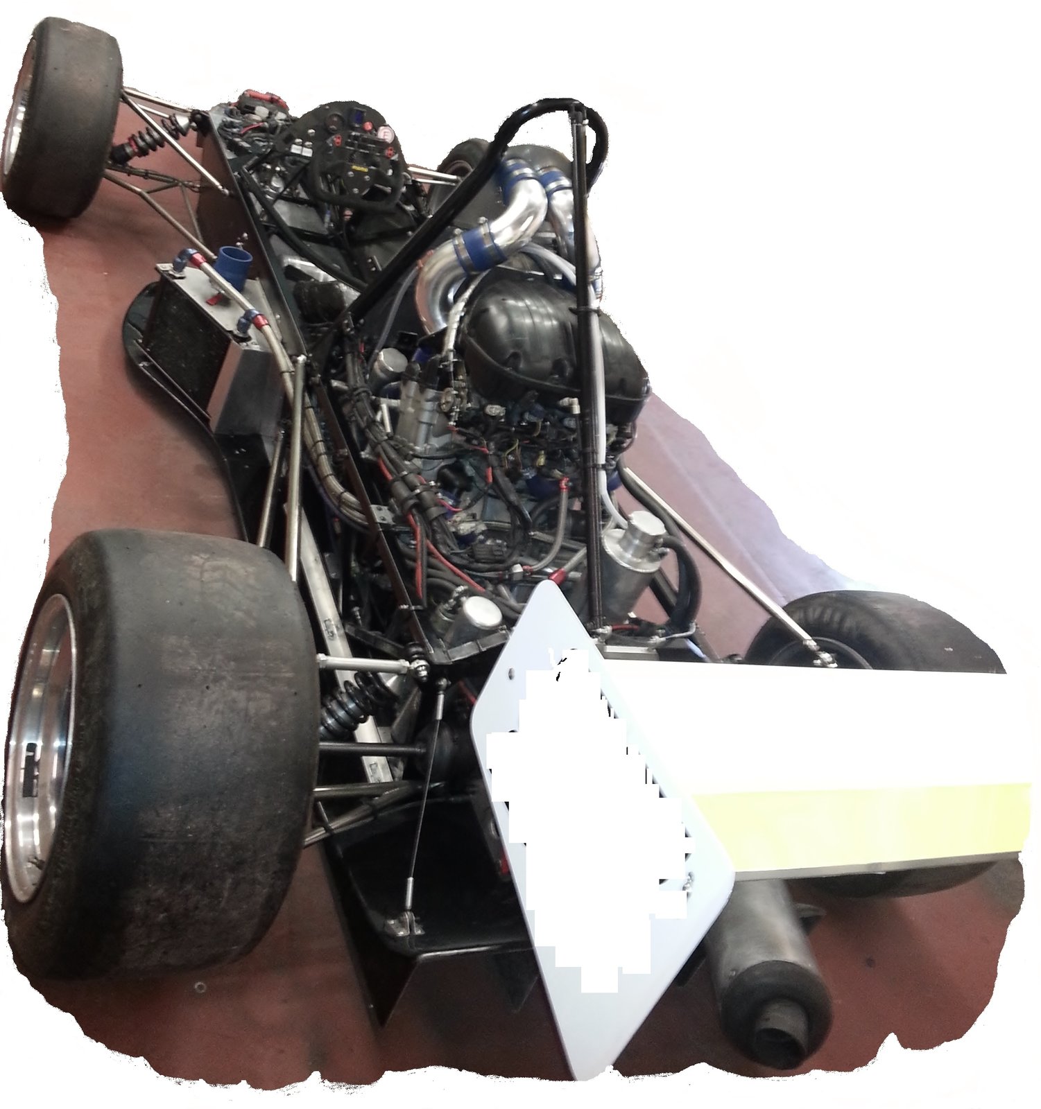

    Oil rad is the one visible below, the tall filler cap at the rear, is the dry sump oil tank. The vertical small alloy tank to the left, is one that stays constantly full of fuel (swirl pot). The fuel big tank, is what the driver (me) rests on... with a bit of alloy sheet as a firewall, the angle of the tank was roughly like lying down with something under your back..
    Arse 45mm from the tarmac. The fuel tanker filler is in front of the exhaust headers. The car below I rebuilt, after having the chassis altered. The motor in it, was rebuilt by a top 10 road racer.
