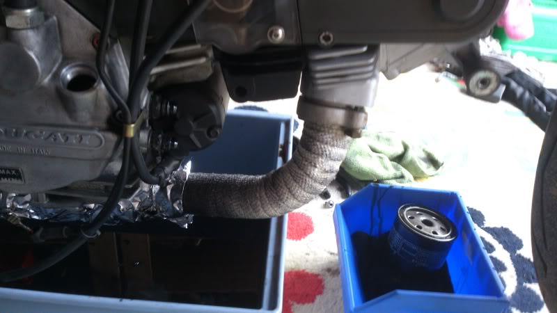

    Managed to get out between showers yesterday to warm the bike up to drop the oil out.
    Wrapped foil around the hot exhaust to stop oil soaking the exhaust, easily removed later to stop any huge clouds of smoke when the bike got hot again... :smile:

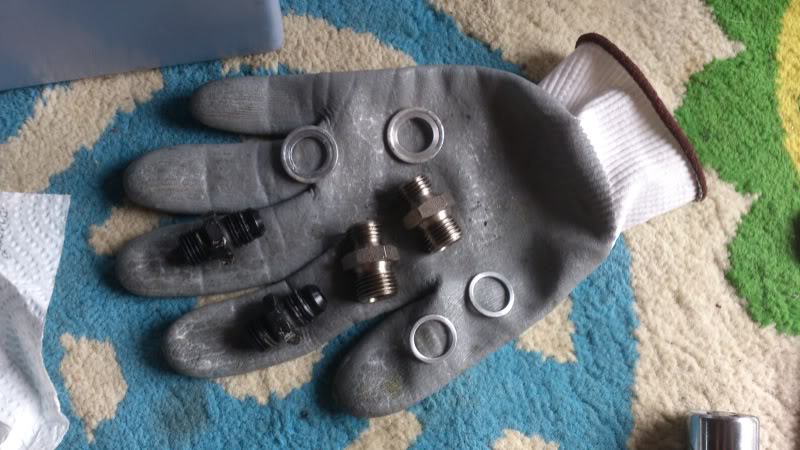

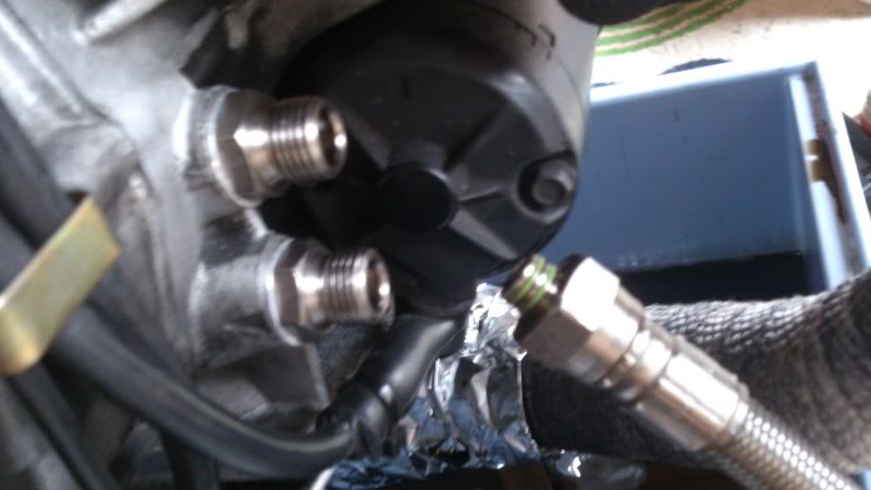

    Strainer out, filter out - removed the SS unions. The 848 unions are a FAR superior design than the SS taperfit, being a male-female fit with two o-rings per joint?

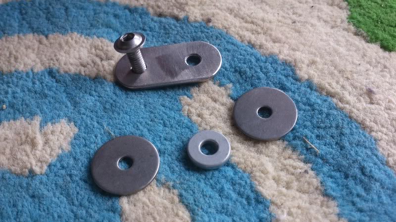

    Swapped the unions over - fitted the new hoses, which allowed me to line the cooler up? Planned on using the SS anti-vibe rubbers, removing the rubbers from the top of the 848 cooler? Would need a small 2mm thick washer to fill the hole left.
    Fill your filter with oil before fitting it - come back in 10 minutes & top it up again, I swear the thing holds over half-a litre of oil! Presoaked & full the filter will allow INSTANT flow of oil through it saving valuable seconds when starting a refilled dry engine again?

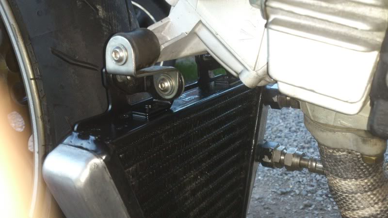

    Made two brackets out of 2mm stainless plate - adapters to fit the cooler to the SS valve covers?

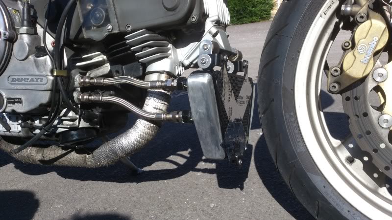

    Fitted! Added a cooler guard plate (Cheers, midnight runner!)
    T'other side:
    Superb! Predictably temperatures are much more in check (added a little heatproof tape to the front as a "thermostat" - removed when the bike is up to temp? In Winter the front stayed taped up, still does for short journeys??
    Lot more tidier - the new hoses & stainless unions are pleasing to the eye... :upyeah:

  10. A few days road-test have show no leaks or other such dramas? :upyeah:
    Few more photo's of the other bracket?
