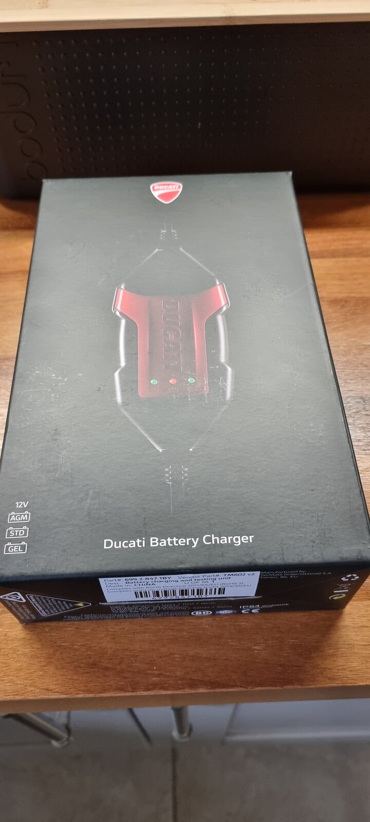

Update! You can't buy just the lead from Ducati Dealers it seems. Only way is to buy a Ducati badged charger which comes with 3 lead adapters in the box. Direct connection to the Battery The older 4 pin Ducati lead The new 6 pin Ducati lead! All optimate gear by the look of it also!

Thanks for the effort guys but I've bought the Ducati charger now complete with all 3 lead adapters. TBH it wasn't that dear at £80 all in. I have a spare Optimate charger now so might as well connect that to the poor RGV250 which isn't trickle charged atm!
