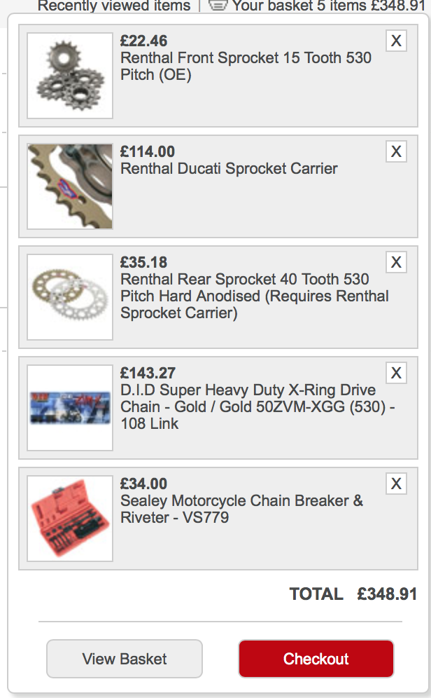

  1. Just about to order this to do my chain and sprockets. The idea being then I only replay the £35 quid sprocket each time in future. I looked at supersprox as well but can't seem to find a easy place to buy and get now. Does this look like what i need to do a 1200abs 2011 multi? In the workshop manual it also shows when doing the front sprocket an o-ring needs replacing not seen that mentioned on any other thread am i reading it right? Many thanks for any advice , Cheers Chris
  2. All looks correct to me, I didn't do anything with an O ring when replacing my front sprocket. I'd go with 42 tooth rear if you are replacing them anyway.
    Cheers
    Paul
  3. Thanks Paul order going in tomorrow , good to know about o-ring !
