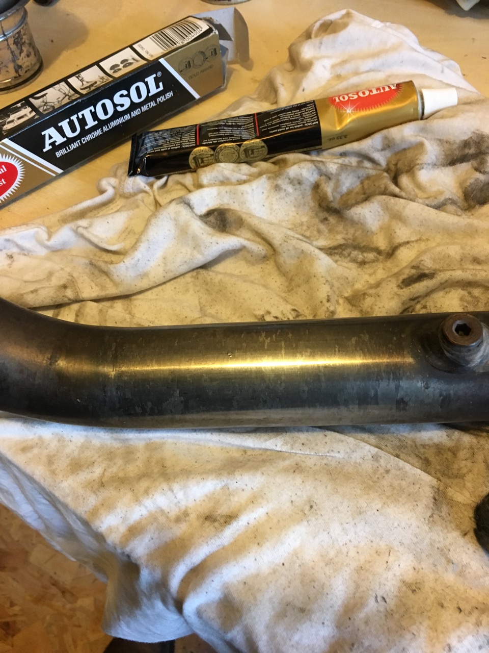

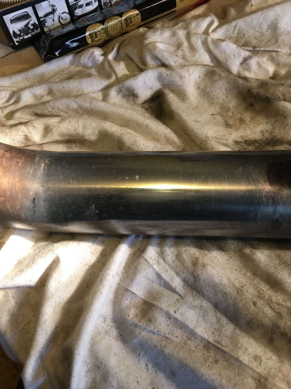

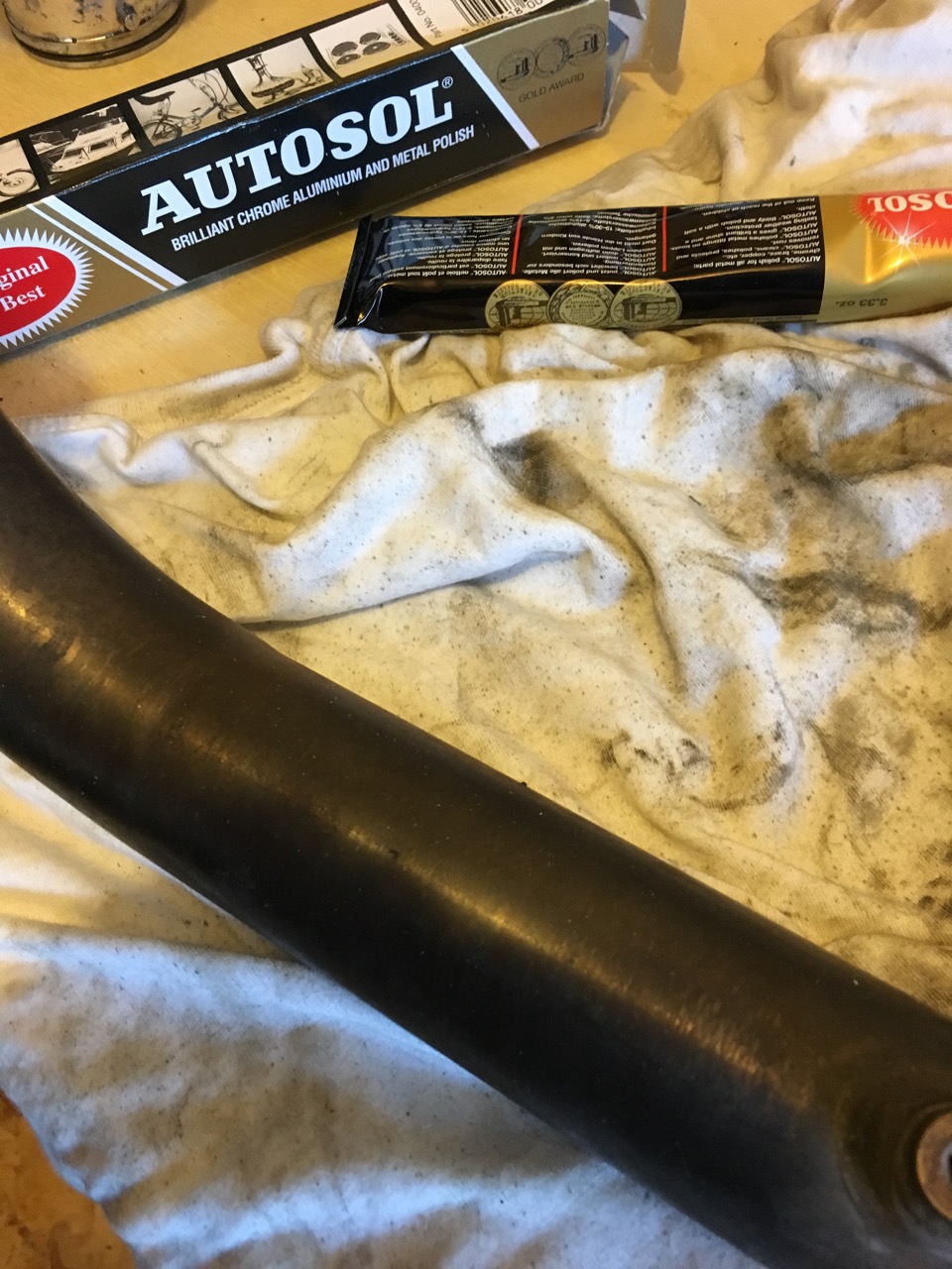

    First, here's part of my exhaust. Manky, as you can see and taken off for cleaning.
    A dab of Harpic, worked in with a toothbrush, then rubbed in further with some steel wool. 2 mins tops.
    Then finished off with some Autosol, another couple of minutes of elbow grease, and voila.

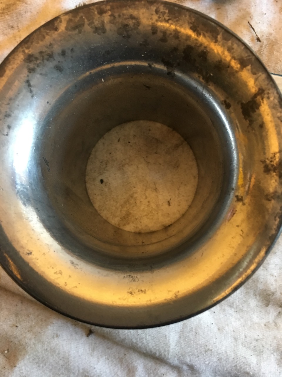

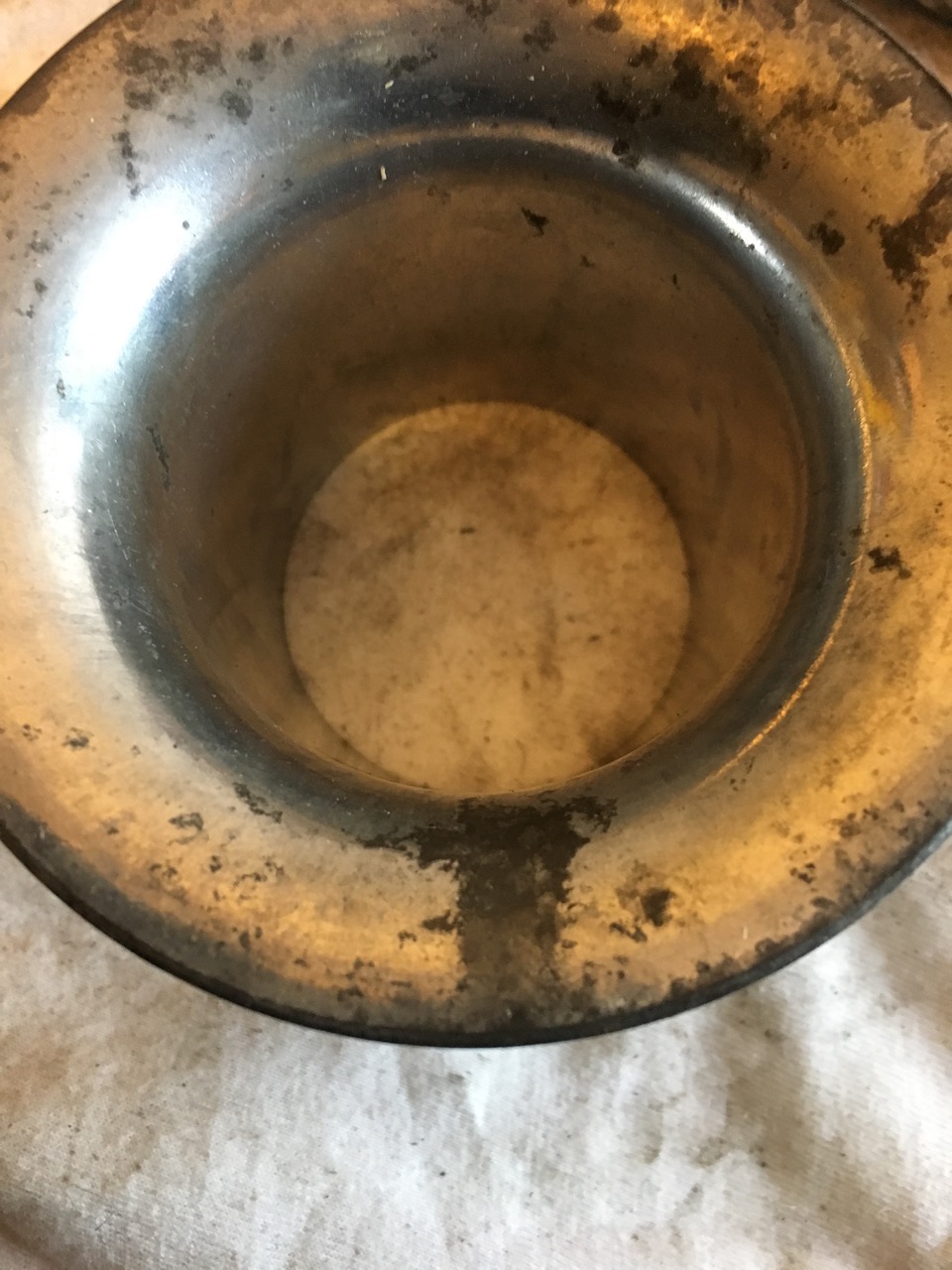

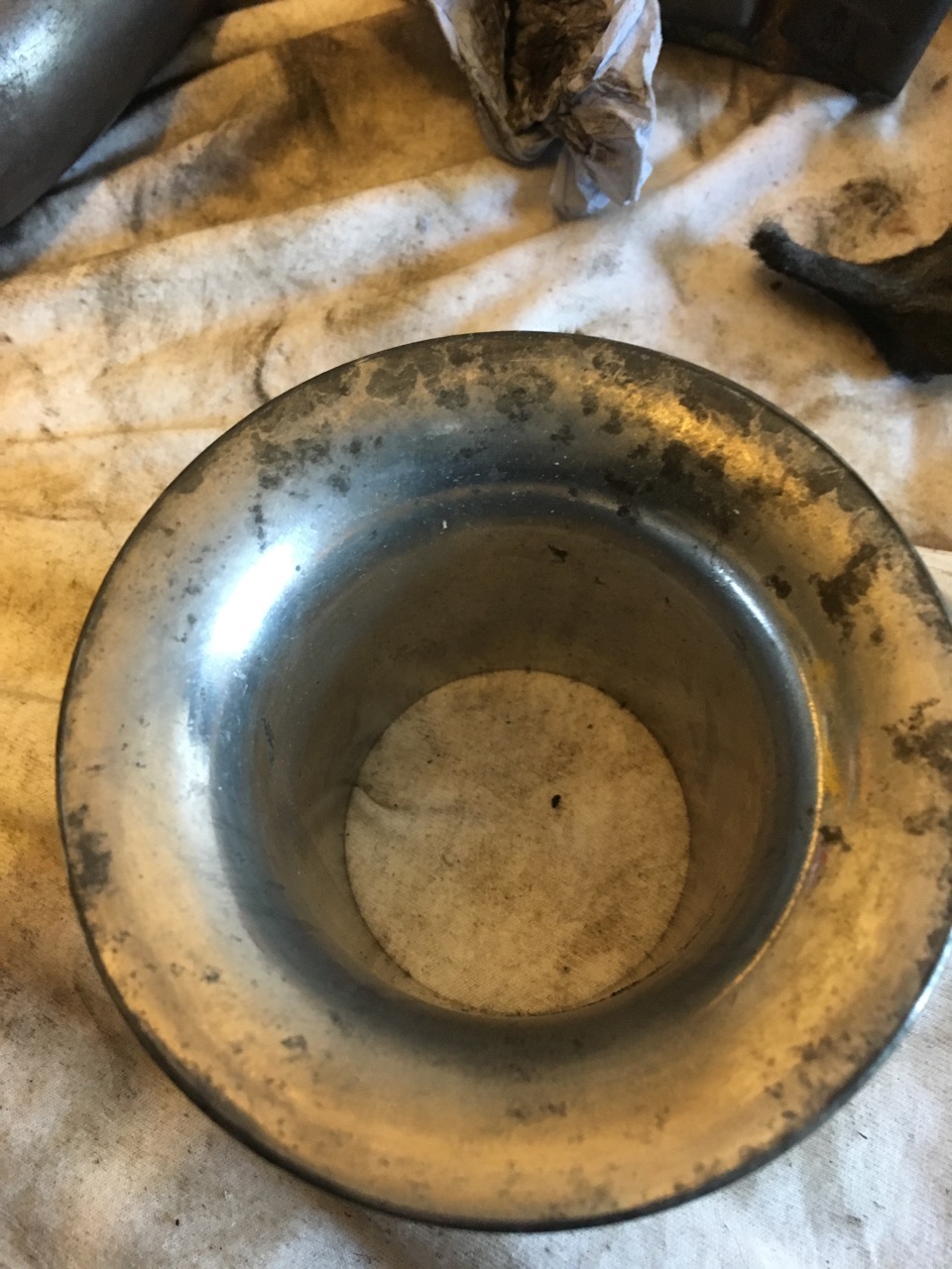

    Next an aluminium throttle bell mouth. As you can see the corrosion is quite bad, black marks everywhere, (it's 20 years old), but focus on the big black mark at the bottom.
    A drop-off Harpic, toothbrush, then steel wool and the big black mark has almost completely gone.
    Again, an application of Autosol and it polishes up beautifully.

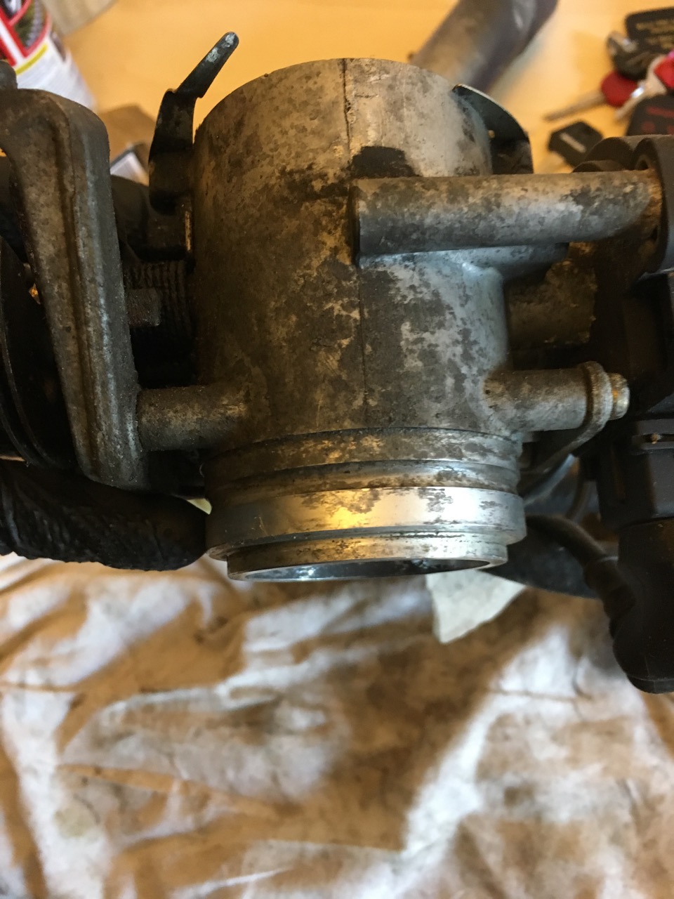

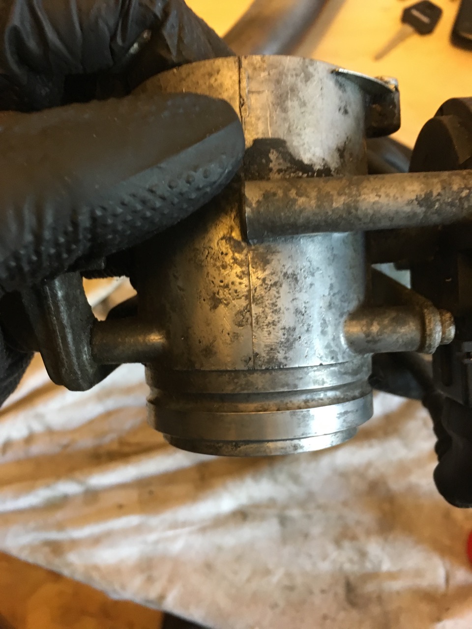

    Now for something really cruddy; a throttle body with 20 years gunk on it.
    And after a couple of minutes.....

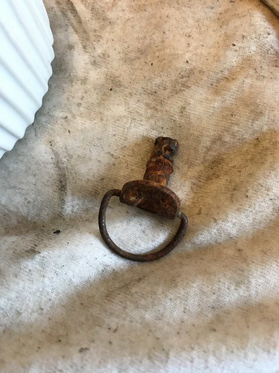

    Now for the real test, a rusty 20 year old Dzus, which will be left to soak in the Harpic overnight.
    It seems to me the stuff works fantastically. Apply it, work it in, leave for a short while, wipe off, rinse off with a water spray, dry and then polish up. However, wear gloves and work in a well ventilated room as it does give off some vapours.
