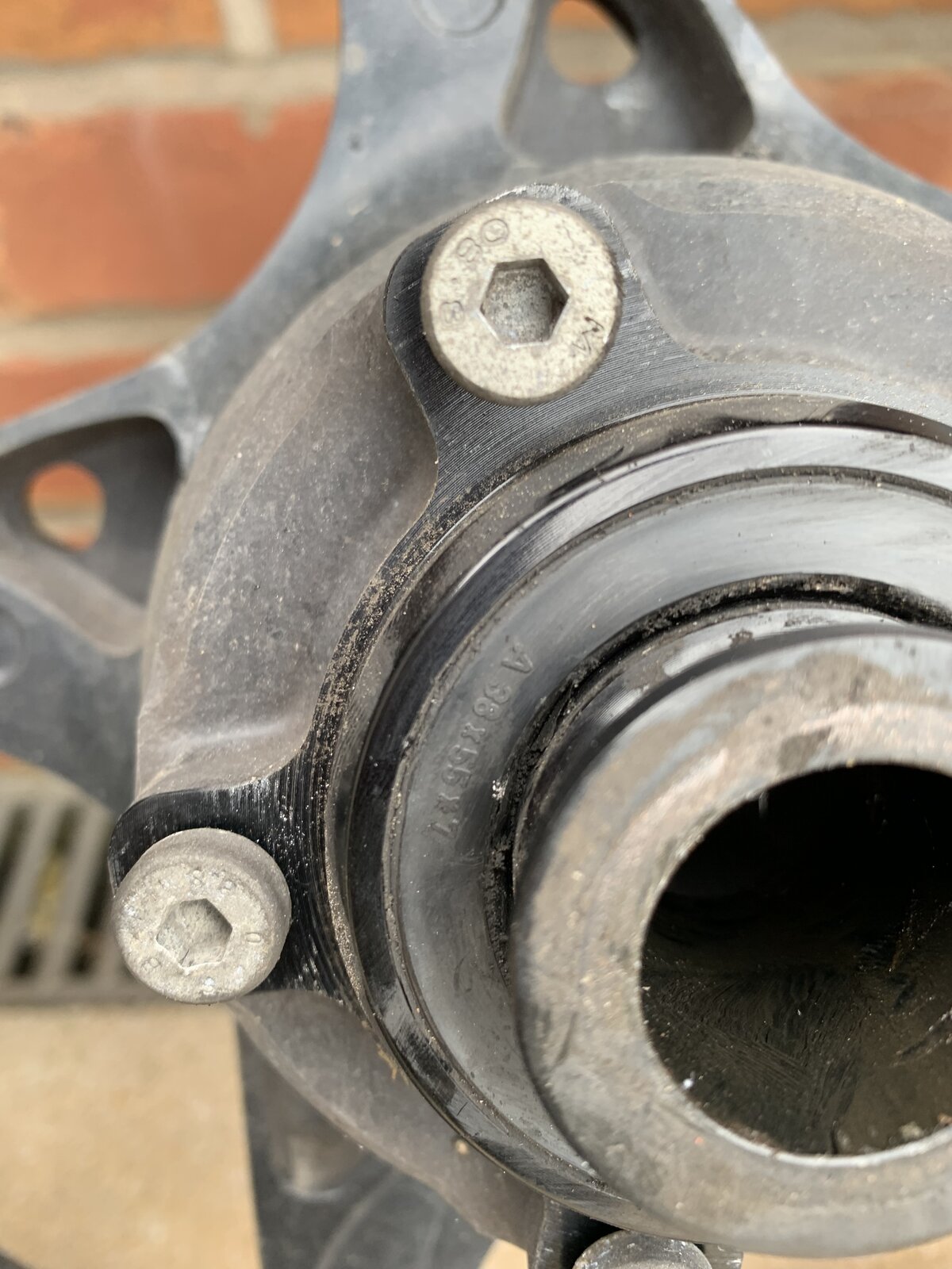

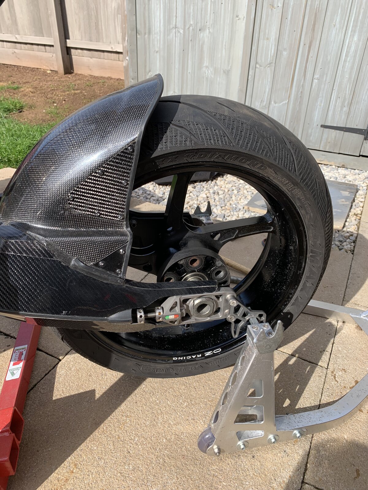

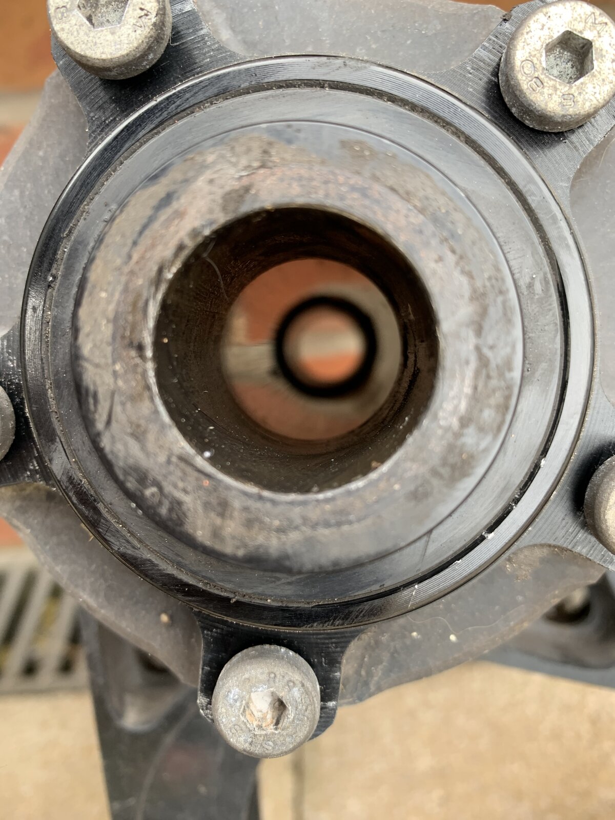

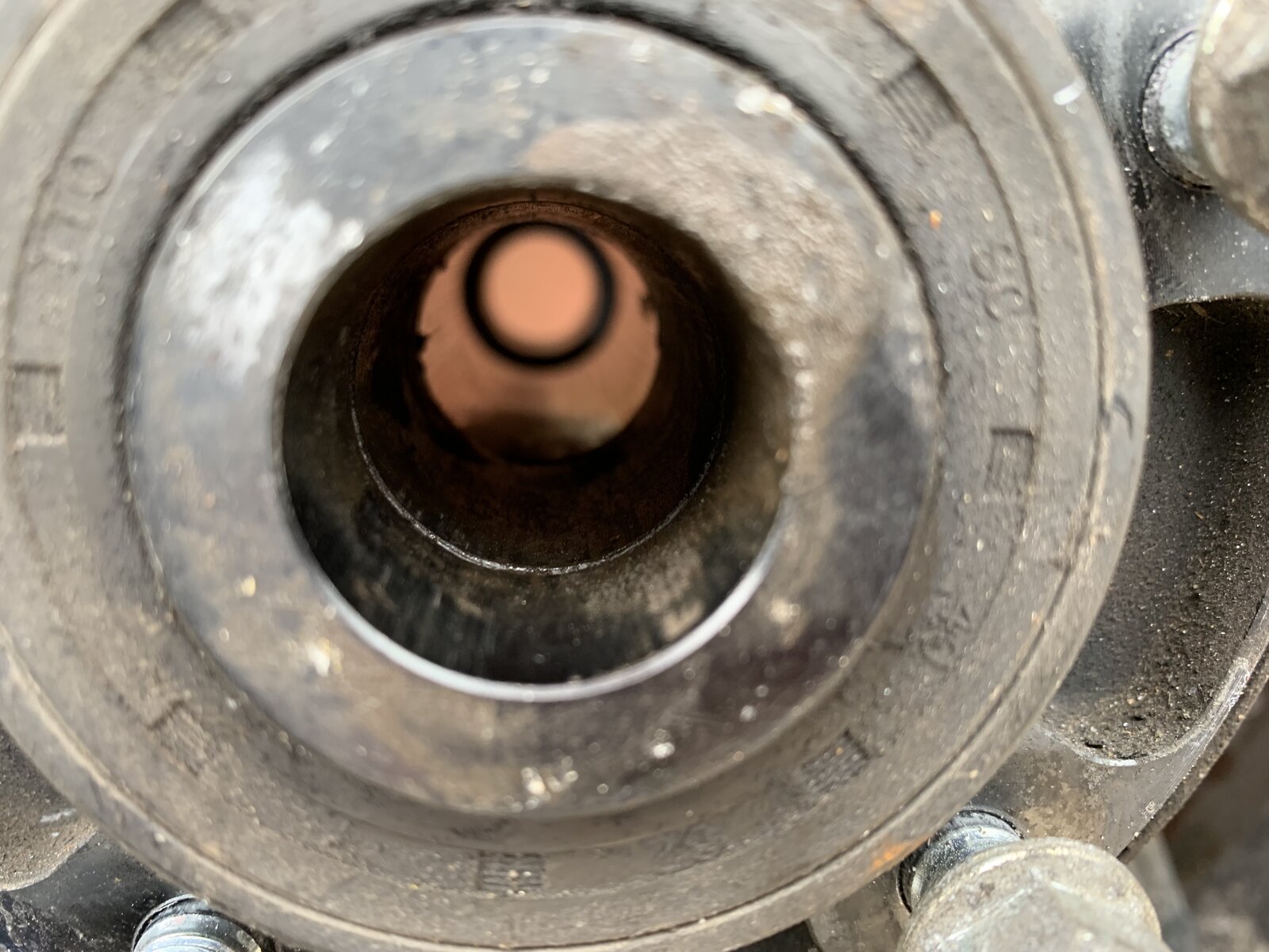

  8. So I popped the wheel off today, the bearings are large enough to accommodate the 749 axle, I will just need to get the spacers out for machining.
    Has anyone removed the spacers from oz wheels before? I can see a small lip from the opposite side but I am abit reluctant to start tapping it out as the is no play in the at all.
    Cheers E176B7DE-054E-4F85-8518-27905F8FC115.jpeg 945FEE74-620C-4890-9637-1BD4C6CE44C9.jpeg F0B18B70-6A9D-4272-BFF7-D26855DDD50E.jpeg
  9. Are the spacers captive between the bearings I.e. inside the wheel?
  10. Yes, looks that way.
  11. Not sure I fully understand the arrangement however, if you need to remove the bearing to get to the spacer, I suggest that you use a Rawbolt. These are available from DIY shops/Screwfix etc and are an expanding bolt. Screw it into the bearing and expand it using the nut and then drift it out from the opposite end using the spindle or a suitable long drift.
  12. There is no contact to the bearing, I think I saw a pic where a snap ring was present under the dust cover, but I did not screenshot it: unamused:. Better picture below 35947EC7-7079-464A-8426-3ED0A445330A.jpeg
  13. So I took the chance and drove the spacer out from the inside, it popped out, then I drove the other side out, the whole sprocket carrier comes out. There are two 30mm I’d bearings in the wheel it’s self(perfect) there is the internal spacer and the brake side spacer, the drive side however has another bearing, with a 2 piece spacer either side(haven’t got this out yet).
    I will drive out the bearing in the carrier and separate the spacer, then send off for machining. Will post some before and afters.
    Wheel sitting on the 749, on the internal bearings. 1C82366F-D022-43A1-A19C-514FC8C04868.jpeg
