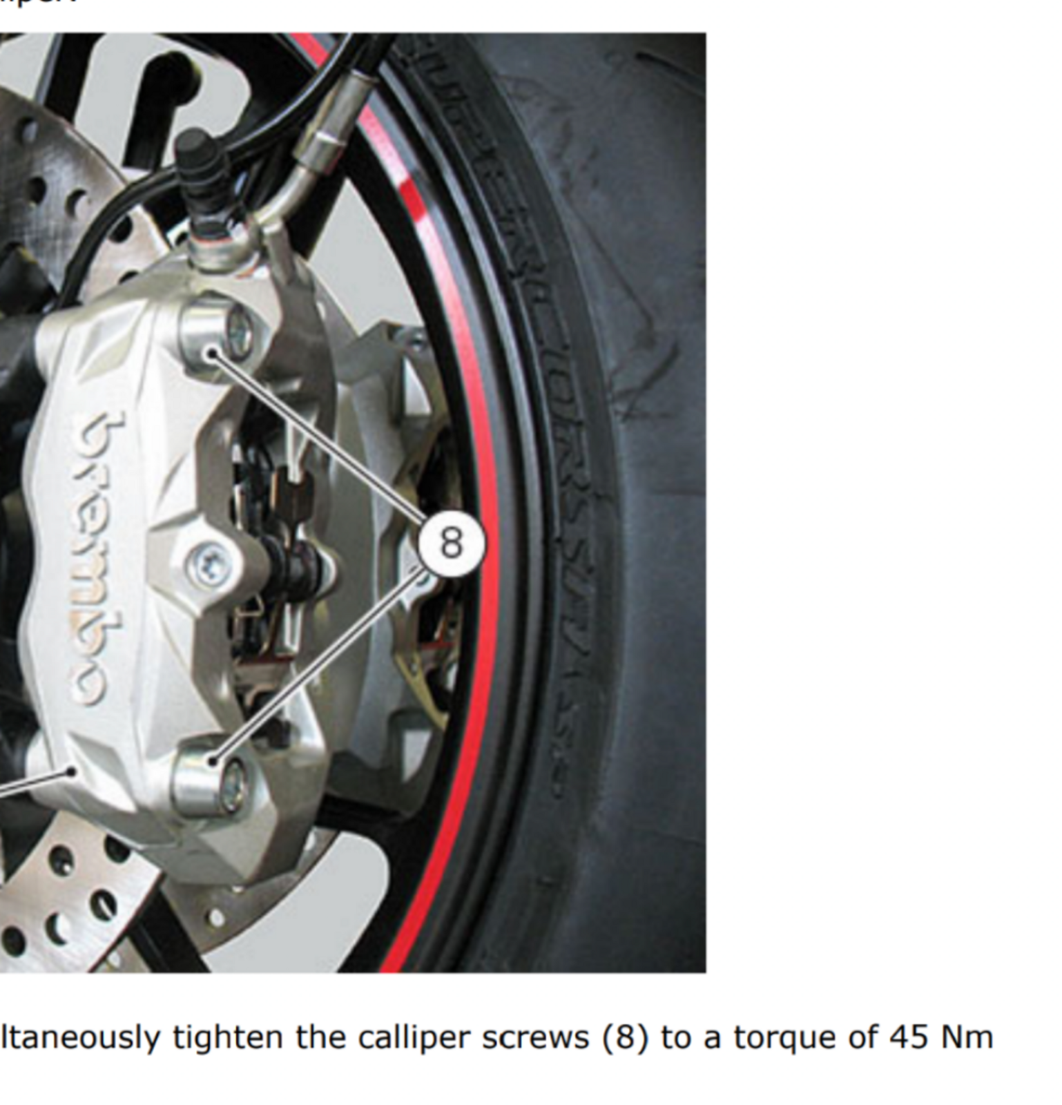

  1. Hi all, just about to put some new pads in the the front callipers but they look really tight to the wheel rim….any pointers on removal & reinstall would be welcome as would the torque settings for the bolts …. Cheers
  2. It can be done just about if you ease the pistons back into the callipers slowly using the disc as leverage, and slide it down (I think) a bit first, the side with both banjos is harder so put some masking tape on your rims before you start :upyeah:
    EDIT: don’t forget to move the spacers between fork leg and calliper - grease can hold em on and it gets you a few extra mm of clearance.
    Calliper bolt torque is 45Nm from memory but someone will confirm I am sure.

  11. Torque settings:
    • Front callipers: 45Nm and must be set within +/- 5% 'dynamic safety critical point'.
    Not necessary for dealing with your calliper task, however, if you want for future reference:
    • Fork end clamps - If Marzocchi then 10Nm +/- 5% as above, if Ohlins, then 19Nm again +/-5% 'dscp'
    • Front spindle - 63Nm +/- 5% as above 'dscp'
    All from the Multistrada 1200 manual and with your bike being a PP model, then the Ohlins torque settings for the fork end will apply.
    Good luck with the task and definitely be sure to apply some protective tape to the wheel rims opposite the calliper area, as you will mark them if you don't!!!
