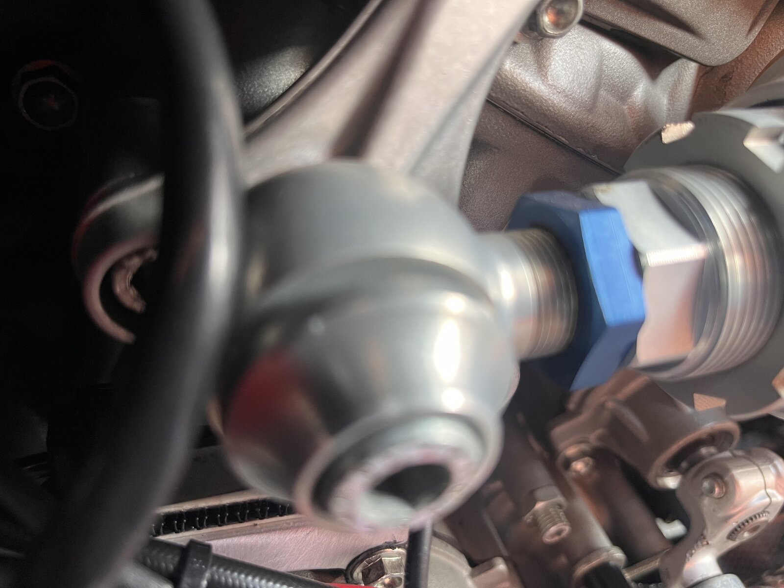

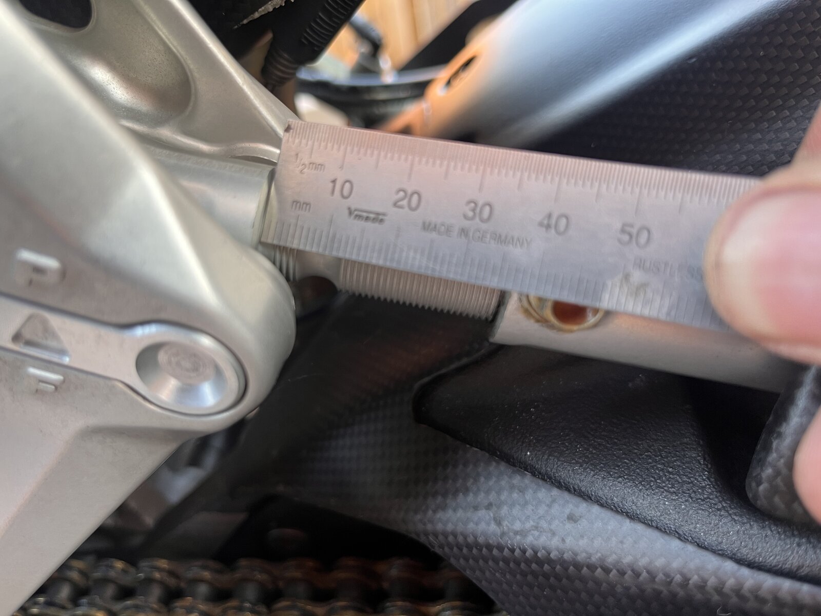

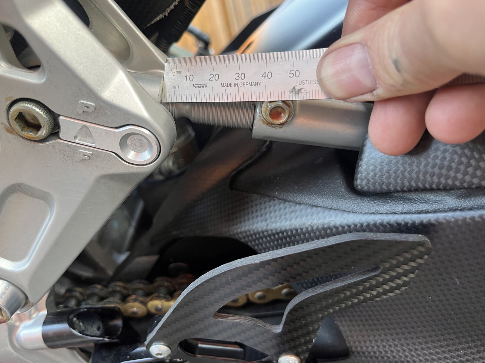

I’ve had a play with the suspension this evening and taken some photos of the shock and how it’s been setup before I got the bike. If anyone with an ‘R’ could compare with their bike and feedback to me where mine differs that would be appreciated.
