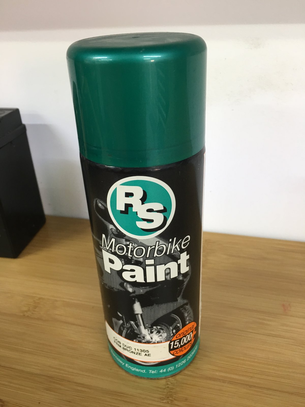

    I don't know if this is a job you are attempting yourself or you want the code for a painter. RS Paints will give you a good match, but are very expensive. They will also not give you the paint code, but the paint will come supplied with their own reference. They can supply in a tin for professional refinishing or in an aerosol for smaller jobs. I found a can of 916 bronze frame paint in the garage that I must have had for 15 years (below) when I scratched the frame of my 916. An aerosol was fine for touching in a spot repair on the frame, but I wouldn't do anything bigger with one as they don't offer much control. They aren't as bad as you would imagine as the nozzles supplied create a mini fan pattern, unlike most of the stuff you'll probably see in Halfords. The beauty of the aerosol is that the paint will keep much longer for you. I bought a 1/4 of a litre of Ducati Anniversary Red about 6 months ago for a job and it's just a solid lump in a plastic tub now.
  7. A thing to note about RS bike paints is that they are water based and as also noted if not used within a certain period then evaporation is likely to cause them to dry out. This happens less quickly with solvent based paints and if properly sealed in the tin they can last a lot longer.
    I used the RS system to repair a panel on a CBR600RR and it worked out very costly as there was a base layer, black in this case, a pearl layer and then a finishing layer (gold) on top of that, after which lacquering is required.
    The gold for the frame on a Ducati frame would be best sprayed using a proper gun system and finished using matt clearcoat, that's if you are undertaking a whole frame. If it's just a touch up you could use an aerosol and a brush to carefully build up layer of paint and then rub it back using very fine wet and dry used wet. There are specially shaped discs to allow this to be done without rubbing one spot harder than the rest. They attach to a small pad that can be "twirled" with the fingers to allow even rubbing over the area.
